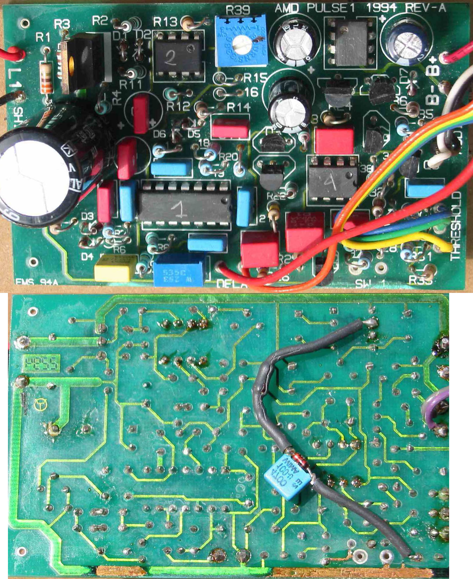

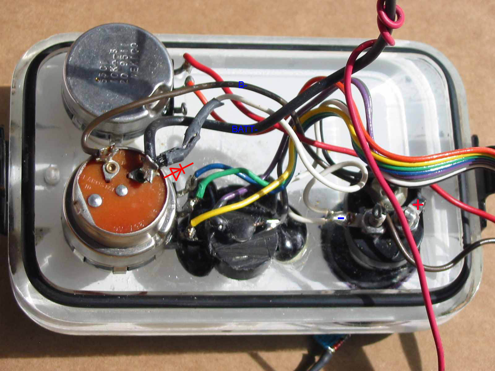

PAPA ALEF pic with a diode in a wire. no mersi from PAPA ALEF more.

HH in SMD and HH is more advanced project. bara is simplest and for diving. submersible. folks project.
for the learning of PI principle. if you get first result you can do any another one. i see bara can be done
in 2-3 days. and in 2-3 days tested on table. no sense to do bara in SMD just the beginners are not able
to solder SMD. i had wrote that anyone can solder SMD resistors and ICs, with adapters DIP14-SO14, on my board.
poor design. much of free space. size 71 x 42 vs mine 87 x 57. also no possibility to check the layout on mistake.Originally posted by bernte_one View Post
P-CAD has perfect tool for checking sch vs lay - DRC design rule check.
a result of work of DRC - a file. i saved it in TXT doing readable for you. just for example.Attached Files
40.4mm vs mine 57mm. 17mm of difference. ok. my board is longboard.Originally posted by bernte_one View Postalso watch at this page and some posting later for longboard files with tht components
