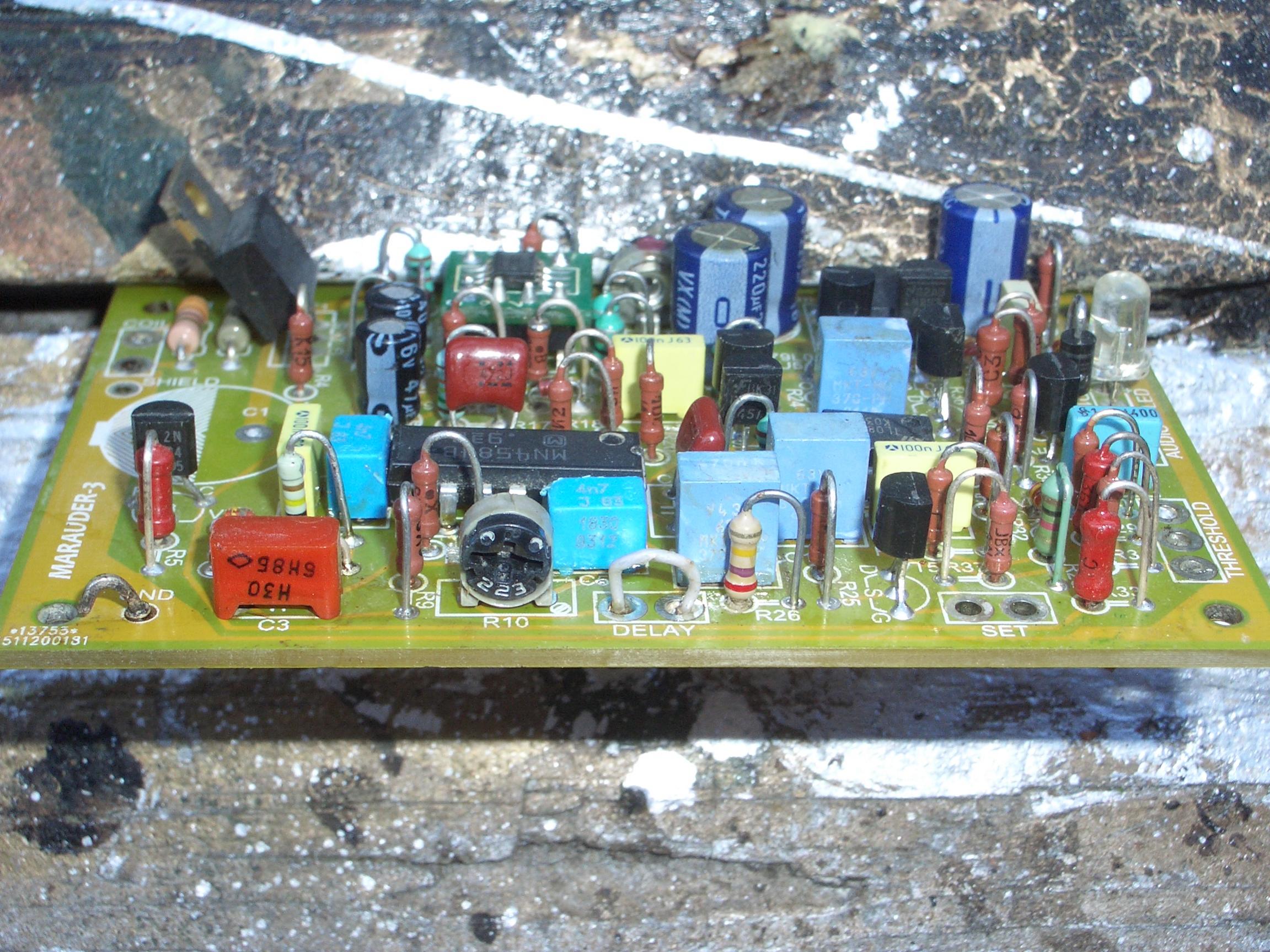

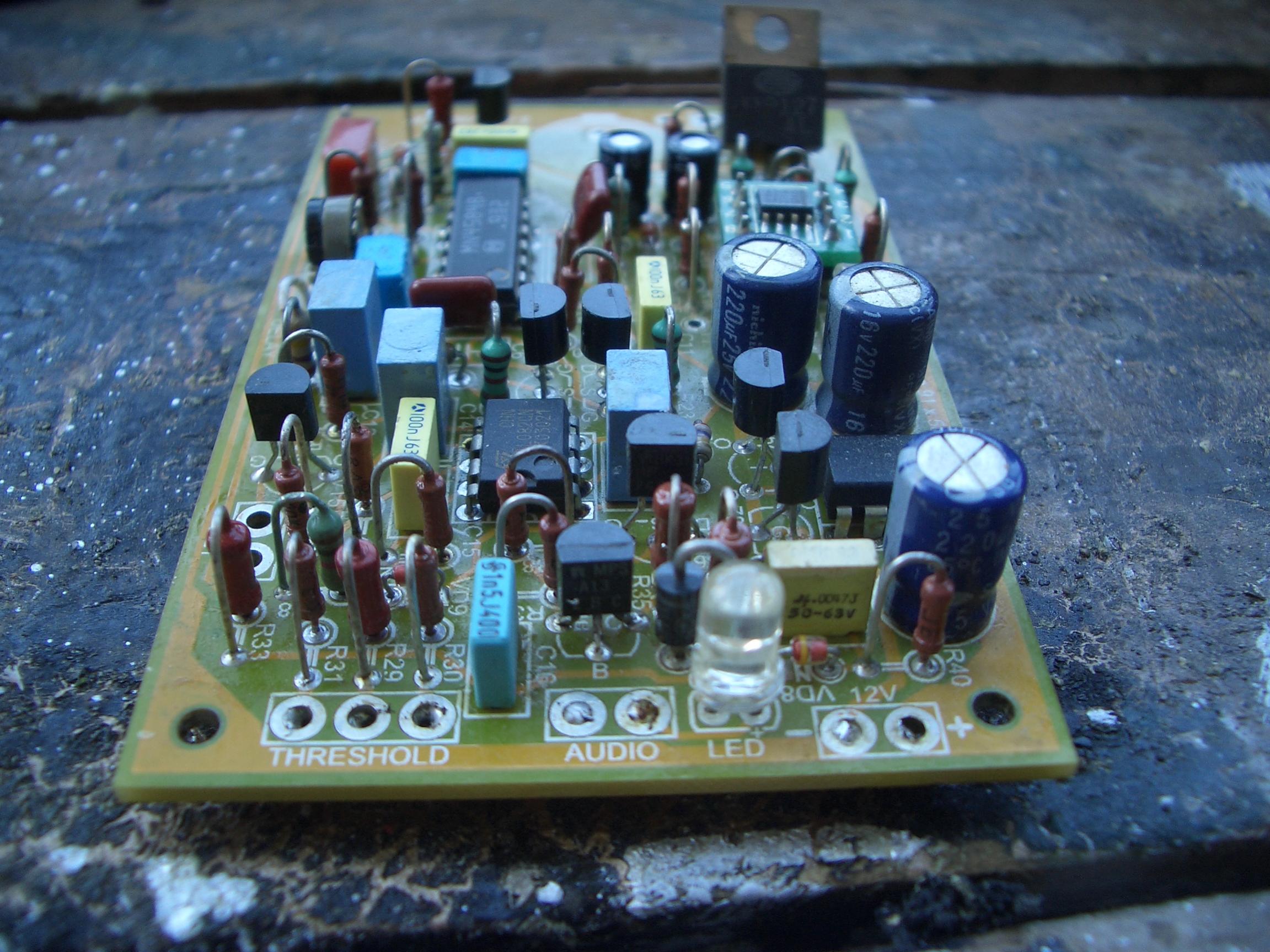

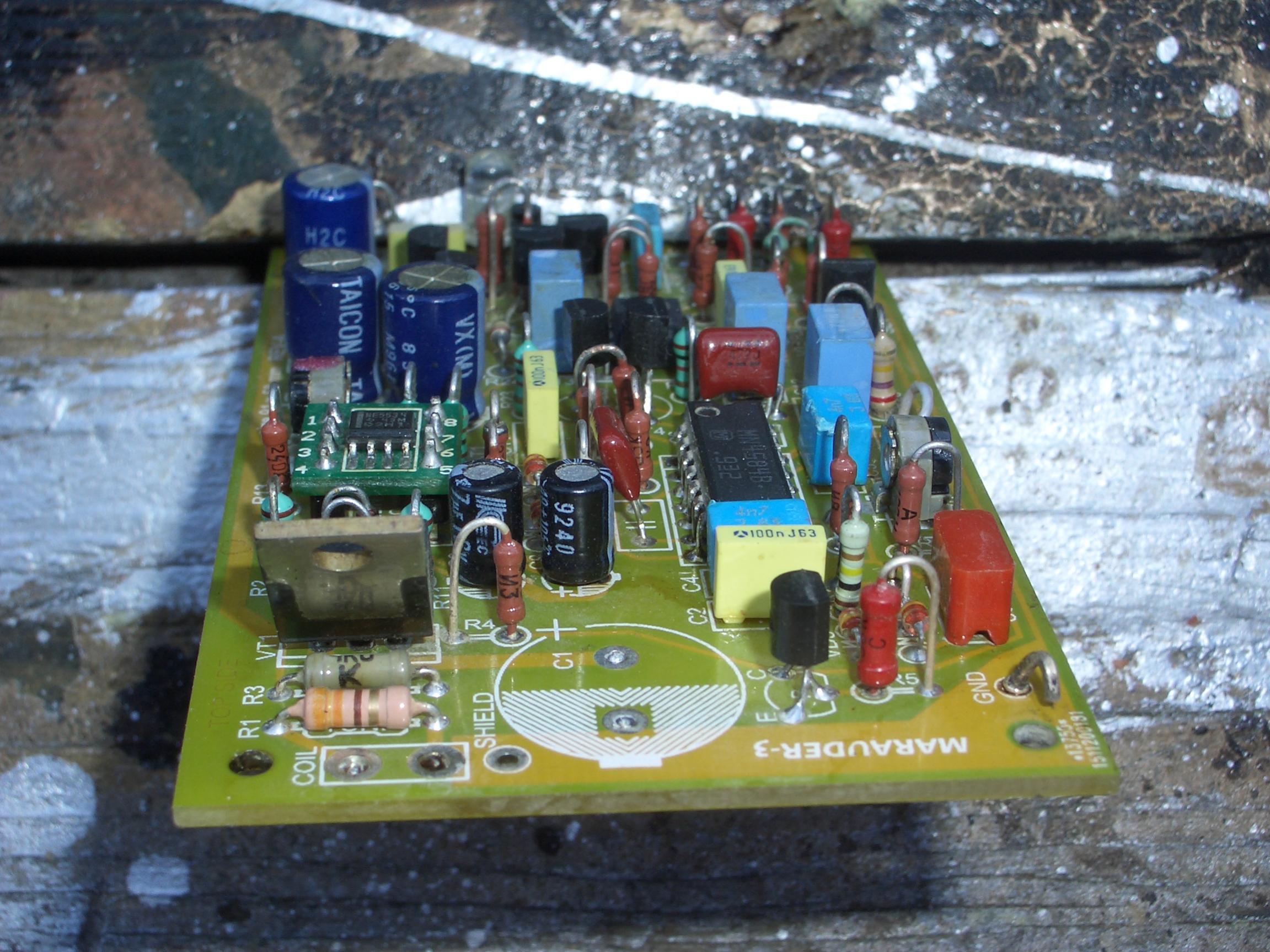

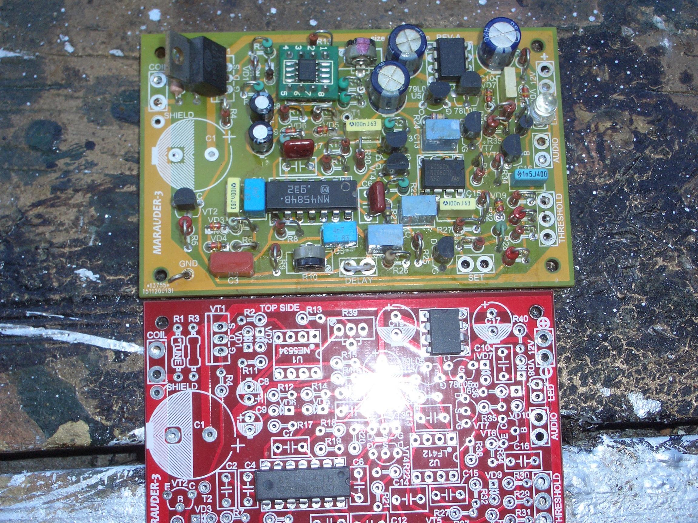

    • I need the picture of a board having fitted components. Same as you took pictures of the bare board.
      i did two pages of albums with pics. why you can not open and see? http://www.geotech1.com/forums/album.php?albumid=66
      all my projects doing from components from trash boards. look http://www.geotech1.com/forums/showt...ash-technology
      you do not need to buy the components.

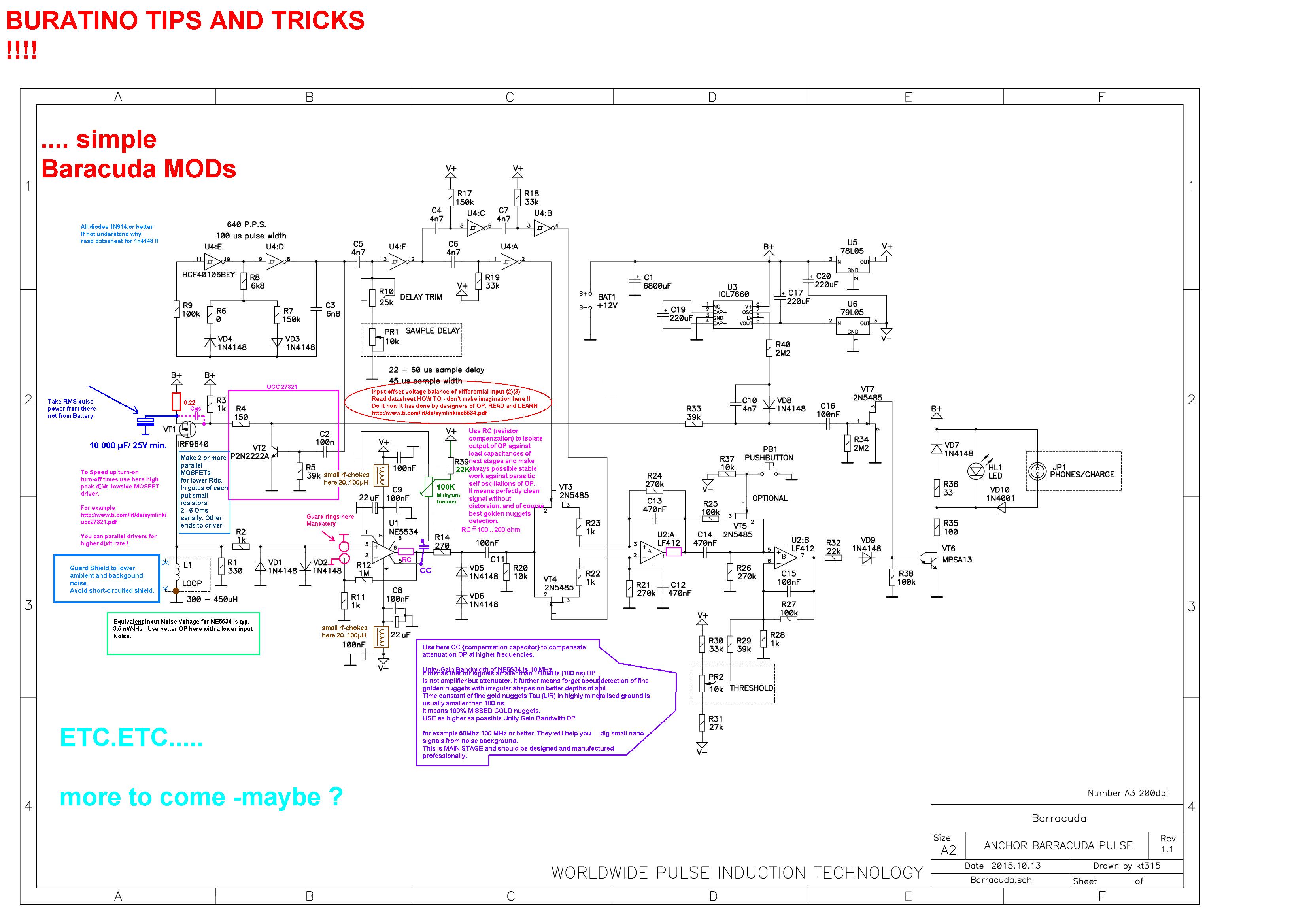

                Now quick question from my side. In your Baracuda tips you mention replacing the 1n4148 with 1n914. I did not see any difference in the pdf's. Actually in many shops they sell them as a complete equivalent. However i gues your point for replacing is the capacity and the speed. So what do you think about 1N4151 instead? It appears slightly faster than 1n4148? At the same moment if i decide to replace 1N4148 with Shotky diodes which one should be my choice?
                • sorry NK i never suggested to change 1N4148 with 1N914. you (people) try upgrade something in full conviction
                  you are able to, for example, add the depth, to make better to gold, something more, etc. But that is just your deeply
                  delusion and always be only delusion.
                  • Yeah this is controversal. I'm talking about the picture which you submit here, and avaiable on your DVD which you refer to several posts before, advicing Chubaba. And off cause single or two diodes are not enough to change the picture, but i'm just sourcing the components, thats why the question! Have a look at the atachment.What do you read there??? ...All diodes 1n914 or better, if not understand why - read the 4148 datasheet.

                    • 1. this is NOT my pic and mods
                      2. you must read the forum more attentionally
                      3. yes, i use this pic. sometimes. i use MUCH info from different people.
                      4. i do not remember his name. he wrote me in russian. maybe buratino (nick shows him kinda he is a clown and went in forum to fool).
                      5. this man is very good in electronics having good basic but he is the blind squirell in pulse induction
                      6. nobody from Gurus still offered change 1n4148 on Shottky at input of front end - YOU MUST LEARN THE PULSE INDUCTION PRINCIPLE!
                      or, they are all f idiots in your opinion?
                      7. we say about decrease FIRST DELAY WIDTH (FOR SENSITIVITY TO GOLD NUGGETS), with Shottky you can NOT DECREASE IT
                      LEARN MORE
                      good suggestion. and? what i must find up there?

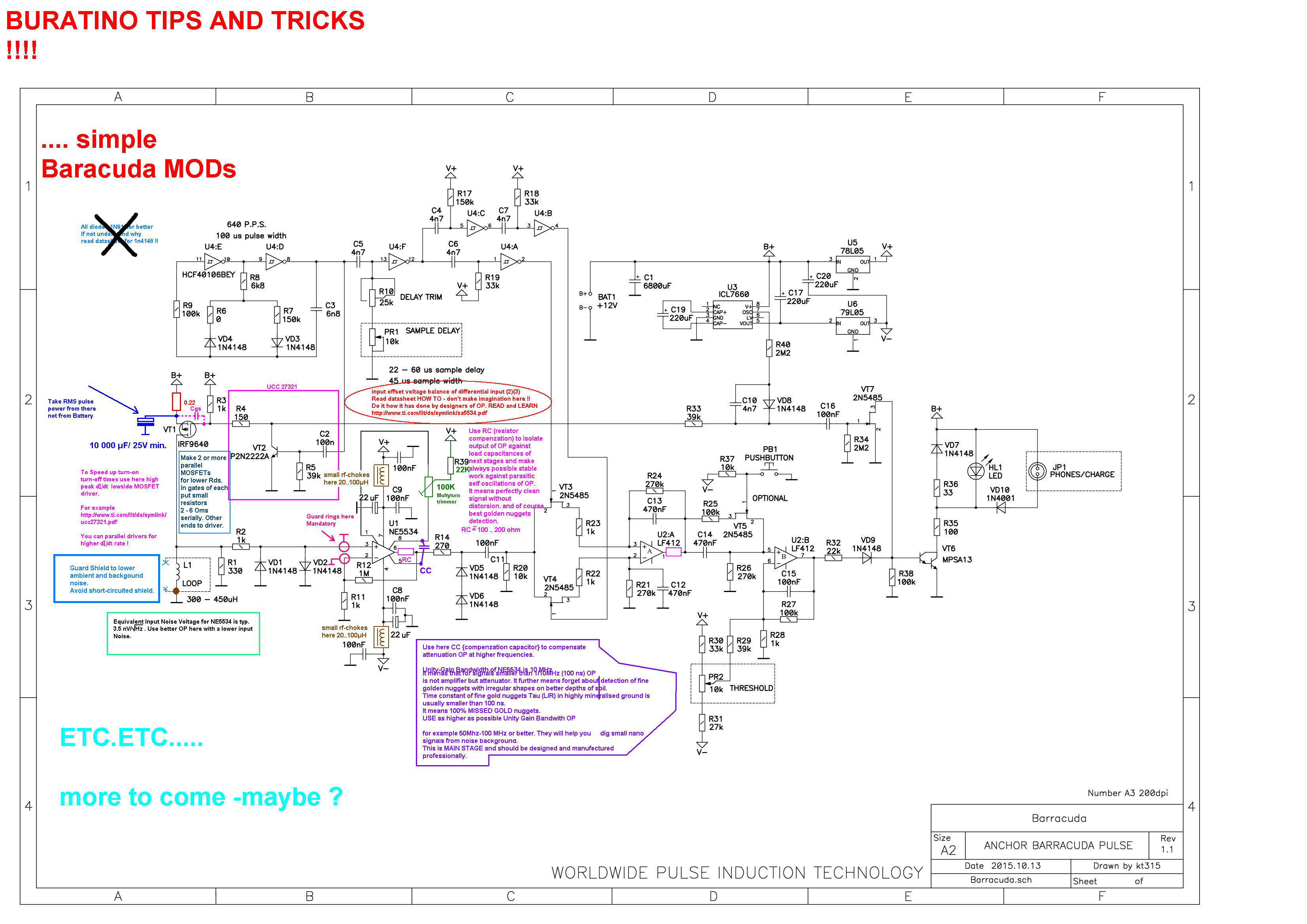

                      • i have not much time to correct all aliens' idiotic posts and pics. you must know that.
                        correct pic
                        • Now i will see all advice from Kt315 with lot of caution
                          • certainly. you have to see all advices from people with edge caution.
                            if you want to know i saw this writing on the pic but i did not attach importance to (like you).
                            thats is sure why 'I did not see any difference in the pdf's.'
                            i do change pdf's JUST if i see extreme necessity.
