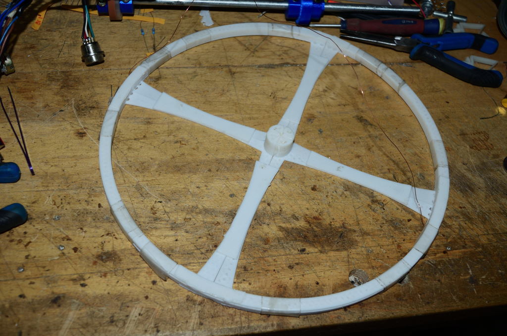

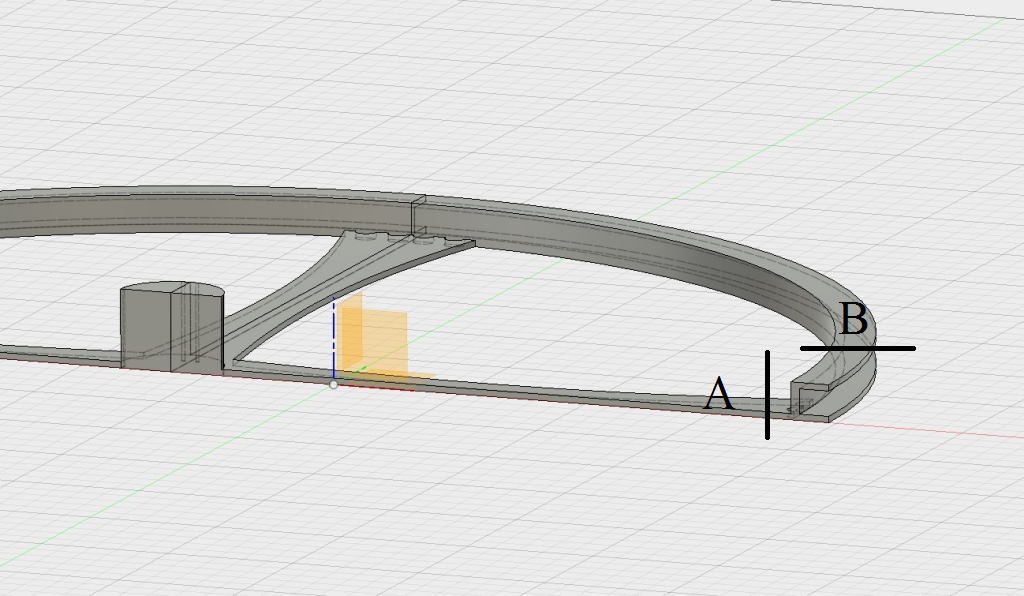

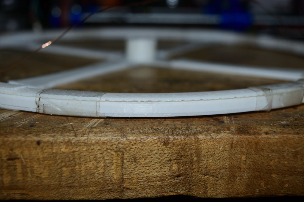

            If you look at my photo's , they show how I make the " bobbins " which I spin my wire around, it is made of ABS printed form, then it gets a insert to tighten them bundle together. If im getting what you said right, I do not wrap the tape like I would electrical tape but more like on of the photos starting with length of A then B and so on ?

                Please tell me the cross section size of the square outside and inside area for the wire. If you try the Scotch 24 mesh shield and a more solid copper shield, measure the capacitance between the shield and each of the coil wires.The Scotch 24 should be lower capacitance due to less surface area. If you wrap the shield clockwise starting at the lower end of A and end the shield on the lower parallel edge to B just adjacent to the shield start point, that should work and keep a good space between the shield and the coil wire to keep the coil to shield capacitance low.
