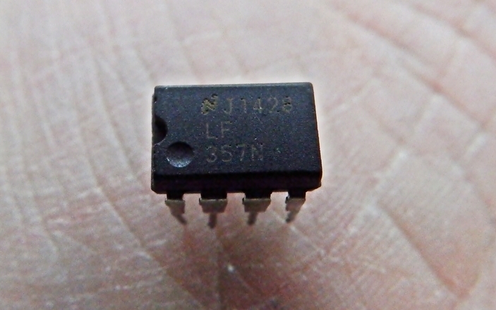

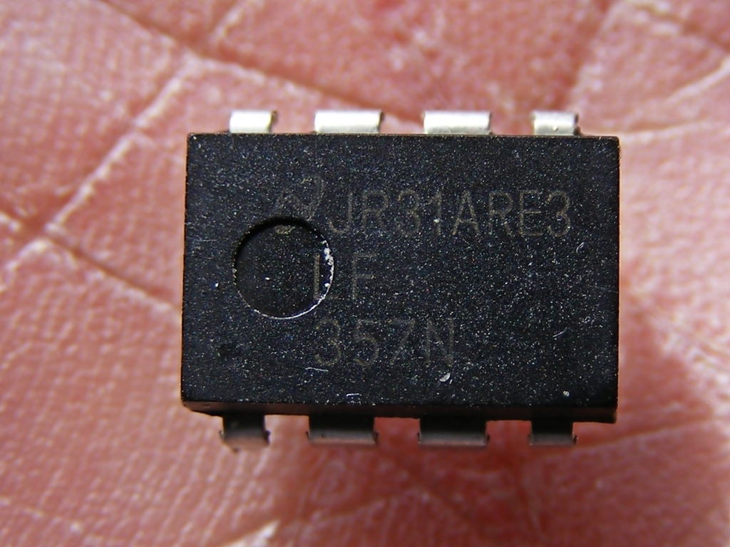

                        Hi again guys.
                        since this last post i have bought some LF 357N chips. here is some pics of the orignal one and the new ones.
                        when i took out the original chip. i had to pop it out and oops, some of the pins bent over and broke of f when i went to straighten then back up.
                        i tryied the new chips one at a time in the slot and the machine switches on but no sound/detecting etc out of it.
                        is the chips that i bougth the wrong numbers or something like that. i know they say LF 357N on them, but what about the other numbers etc on the chip what do they mean.
                        thanks in advance guys.

                          • #43
                            Those other numbers are nothing to worry about they are things like batch numbers, date of manufacture stuff like that
                            • #44
                              The first chip is definitely a fake. Lf357n is Texas instruments, national semiconductors, st electronics original. None of them look like your first chip. The second chips look like the real thing, but...... how can you be sure.
                              Did you check the diodes.

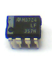

                              • #45
                                The chips you purchased purported to be national semiconductors brand, they look fake also. Here is authentic National semiconductors brand. Notice the difference.
