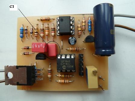

    I built the circuit PI4 (Page 169/190, "Inside the metal detector"). Unfortunately it does not work. from the speaker, only a steady tone. On page 190, the capacitor C3 is drawn in the layout. C3 but missing in the Parts List. I have used the 1 nF capacitor. I have to take it out again C3? Thanks for the help.
    This one is really for Carl, but I can definitely say that you need to have C3 fitted.

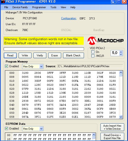

        Maybe I have not programmed the PIC correctly. I use the PICkit 2 programmer. I Wnn the HEX file import first comes the following warning:

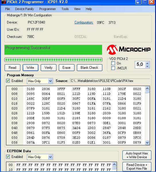

        If I then all the "Write" button is push but ok.
        Maybe here is the error?

          I got the same error message as you
          "some configuration words not in hex"
          but it programmed OK.

                C3 should be included, however the circuit will work without it, just might be a little noisier.

                          You said that you are getting an error message when loading the hex file. What is the error message?
                          While trying to write the .hex file into pic using pickit 2. before clicking on write" , a warning message appeared in the box:
                          "Warning some configuration words not in hex file
                          ensure default values above right are acceptable "
                          I must admit, I have more experience with the program AVR's.
                          Programming with PicKit is new territory for me...

                            When programming a PIC from the ICSP socket, you need to turn on VDD. In the PICKit 2 menu, under PICKit 2 Menu, click in the "On" box.
                              The Configuration bits look wrong, they should result in C9FC 3FFE. The bits should be set in the hex code, so it's possible the Pickit2 is overriding the settings. Poke around the menus and see if there is a selection for this.
