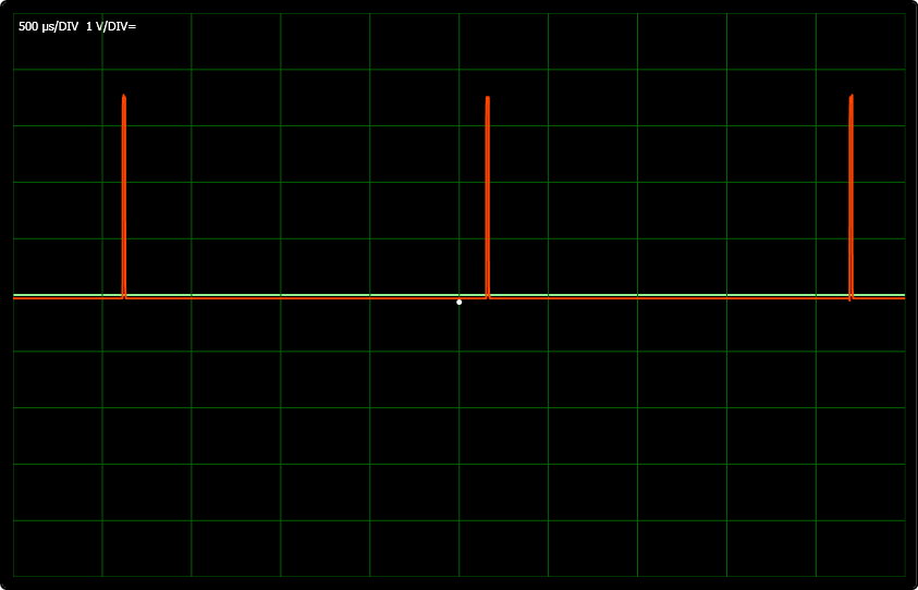

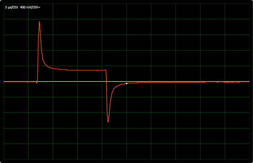

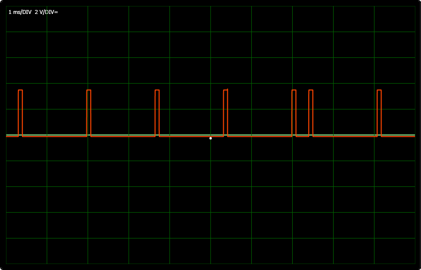

    Thanks for the help.

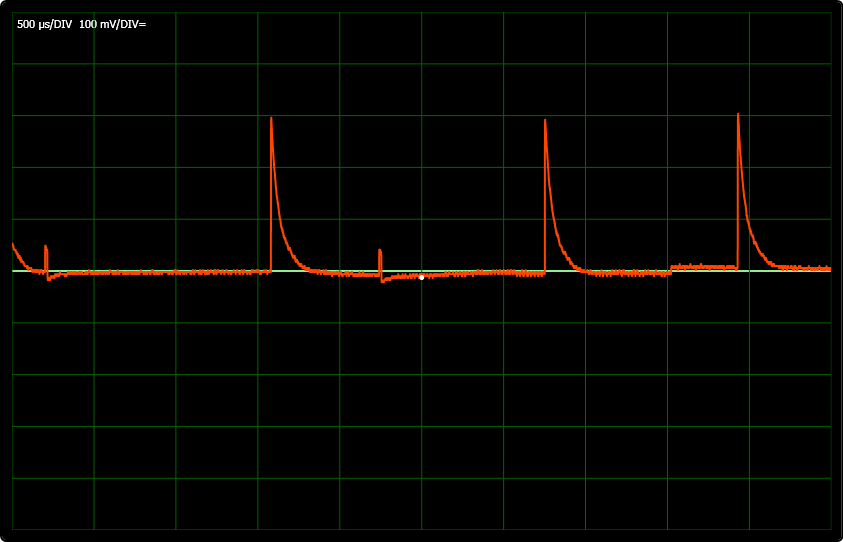

    I use a programmer. In PikCit2 I put VDD to automatic.
    I changed the configurations bits on 3FFE. C9FC not. Only 0 - or 1 - or 2 - or 39FC. I leave it at 09FC.
    Now the circuit gubt a tone of it. Pic of the pulses. But I do not think so as it should. Connected with the coil, no change of tone.
    The following measurements with a simple PC mini Oscope I did:
    Speaker output:
    PIC-Pin2
    PIC-Pin5
    PIC-Pin6
    Should I still measure something?
    Hopefully you can help me?
    Dirk

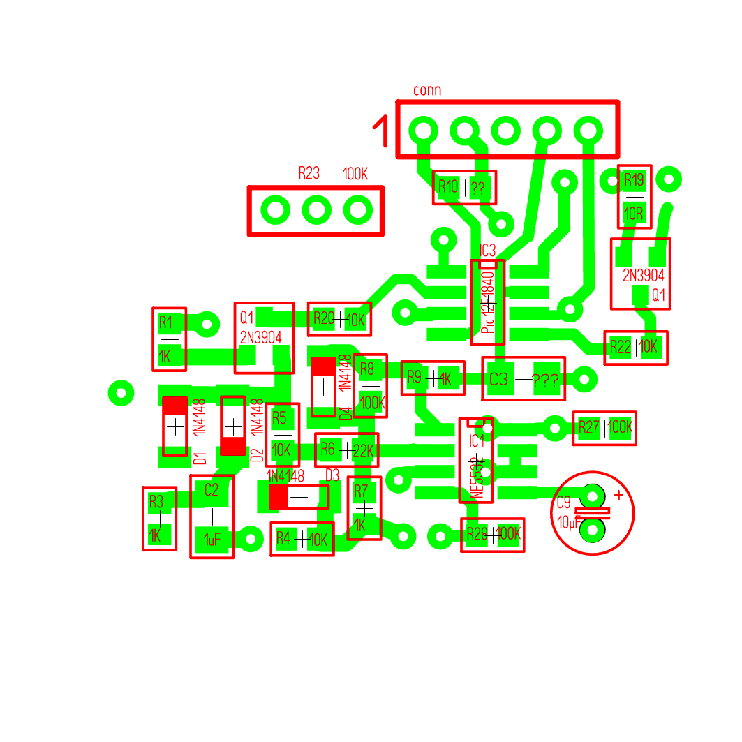

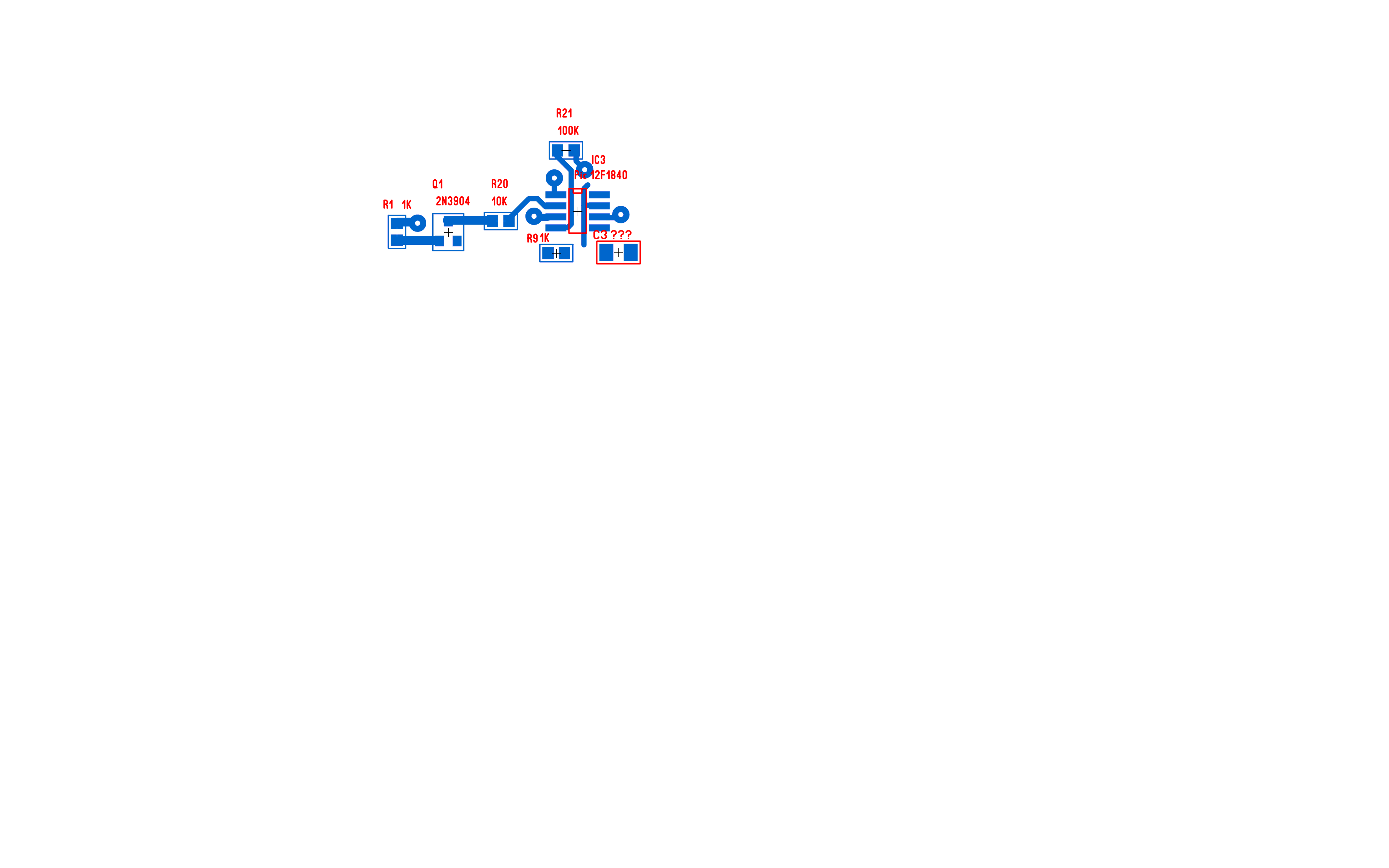

      just start adapt the smd version to sprint layout
      also seen then that c3 is missed and landed here while searching for solutio now
      hope we can solve it dirk
        hello george and carl
        would one you you please fullfill the shematic from pi?
        and can you upload a layout picture from the th board layout and smd board layout in a better solution than in the book
        please?

            waht is c3 on layout in the book concept (under the pic controller)?

                  any News is you pi4 working, did you know the missing value from c3
                    Hi B1
                    I have not had the time to test the 1840 yet, I hope soon.
                    I dont quite understand your question about C3 in the PI4
                    on the schematic it shows as 1nF
                    its not on the parts list on page 190, but it on both the DIP PCB and the SMT PCB.
                      ah that was suspect to me
                      partlist contains not c3
                      shematic has c3
                      so i fit in a 1nf and will finish my smd layout
                      will upload the next days
                      hope we can discuss more about it and compare our pictures from oszilloscope

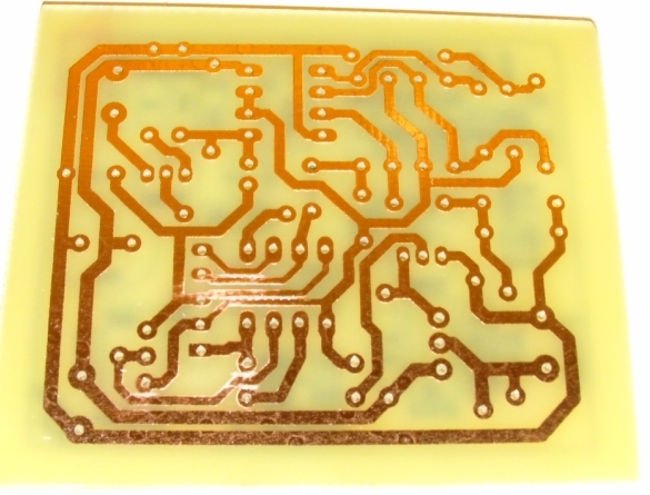

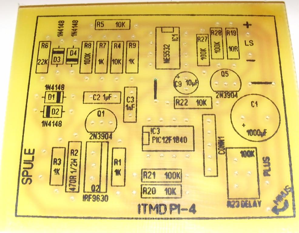

                        ok i have started with through hole layout

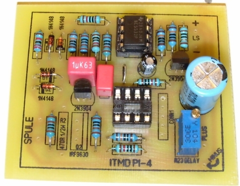

                                hello,
                                today i mounted all parts in itmd pi4 pcb and programmed the pic
                                but i had NO Success
                                Can anybody tell me what i should hear if i start the unit. i powered it with 18650 pack with 12,5 volts
                                first tried with piezo
                                than with small speaker
                                and then with headphone -- nothing happened
                                measured from pins of ic to gnd
                                ne5543
                                1 - 6,65
                                2 - 6,23
                                3 - 6,23
                                4 - 0
                                5 - 6,23
                                6 - 6,23
                                7 - 6,24
                                8 - 12,54
                                pic12f1840
                                1 - 6,24
                                2 - 0,01
                                3 - 0
                                4 - 6,2
                                5 - 0,13
                                6 - 0,08
                                7 - 6,64
                                8 - 0
