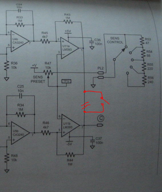

    Hi Qiaozhi,
    If I still want to have all metal mode in the Raptor, would the correct way be just to add a switch as presented in the picture below? The switch could be in the second pole in the disc switch, position “0”.
    Originally posted by Mullihaka View Post
    Hi Qiaozhi,
    That should work OK.
