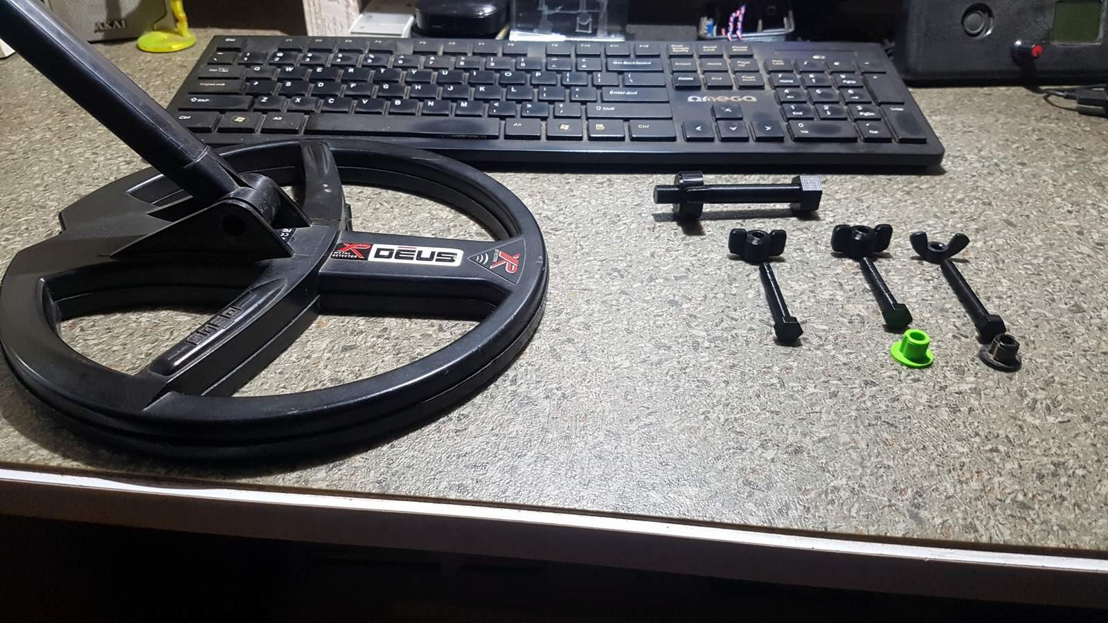

                        Are you still working with 3D design and printing?
                          Yes, at this very moment I am adjusting sizes for XP Deus coil screw, nut and insert.
                          Last couple days I did several enclosures too.
                          You and others here can count on me to draw 3D enclosure and needed parts for this project, no problem.
