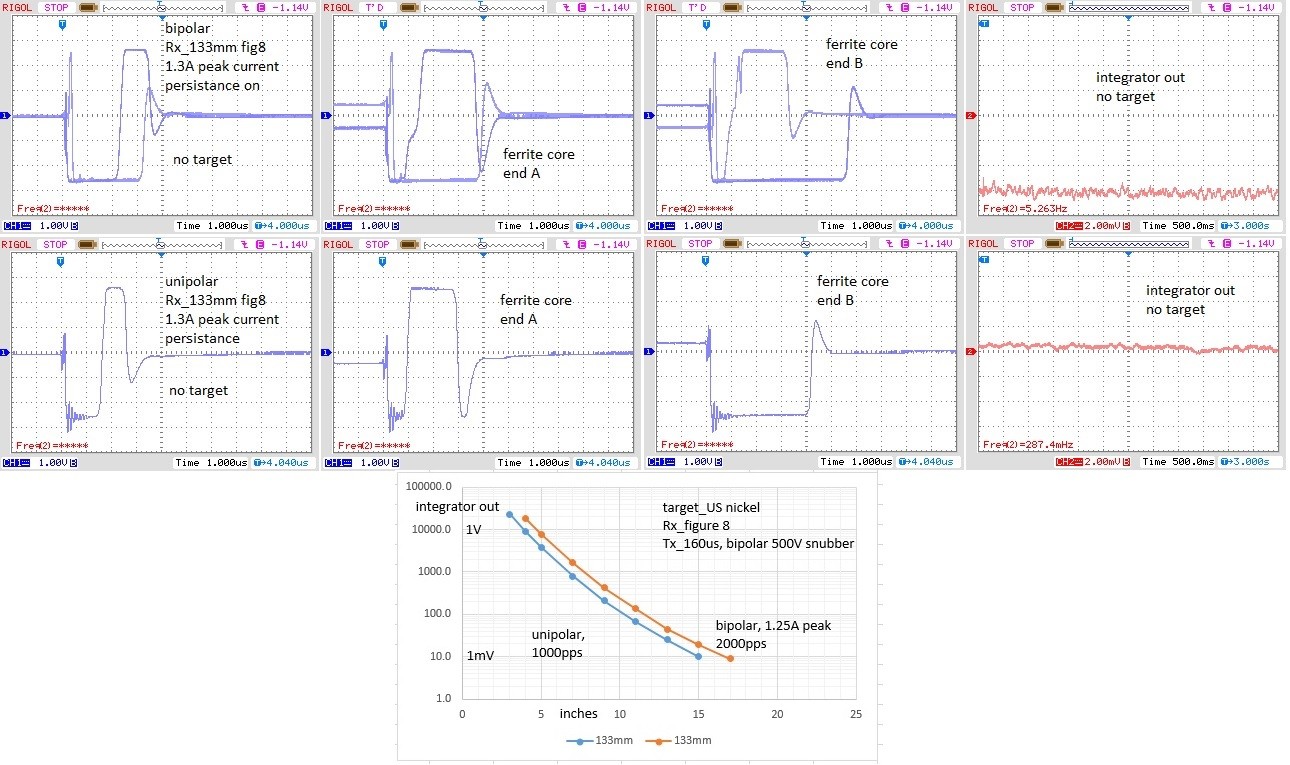

      Time ago you were experimenting with the Moodz bipolar square wave. I remember your observations about the TX slope. Did you try an actual hardware circuit? I would be very interested to hear how it behaved with your figure 8 coil.
      • #93
        I did try a actual bipolar circuit. Not sure which schematic used. Probably not Moodz circuit, just something to try Click image for larger version

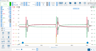

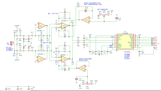

          Here is the preamp for the AMX RX, as tested on a breadboard.
          The scope picture of the output of the preamp with a DD coil.
          The DD coil is shown at the AMX coil thread still open so you can see the insides as well as the specifications and the type of wires used.
