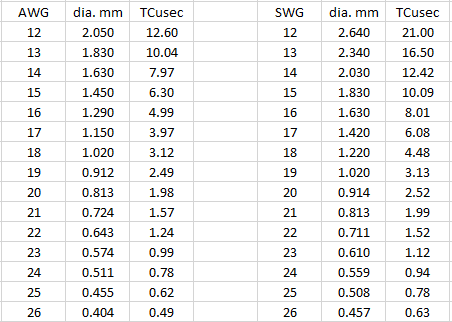

                      I could contribute to the common cause by building a prototype very quickly and testing it.
                      Both on the table and in real conditions.
                      I joined this site a few years back. Owned a Heath kit VLF metal detector that we used to find arrows hidden in the grass that missed the target long time ago. I joined to learn something about metal detectors and picked PI. Had health problems about a year ago and haven't played with the metal detector since. Trying to follow this discussion. When I was active, I made a few detectors that kind of worked. What I missed was a test that I could compare my detector against some commercial or other detector. Mostly played trying to detect gold since it looked like the most difficult. Have some gold nuggets for testing. Problem was they all test different. Tried to find a test target that anyone could obtain. Tried aluminum foil (not all foil is the same thickness, TC effected by thickness and how accurate foil target was cut). Tried lead shot from shotgun shells (quite a bit of variance, maybe do to size or not being pure lead). Copper electrical wire tests consistent and suggested it could be used for a test target (TC not effected by length, amplitude is affected by length but should be able to cut accurate enough to not matter if pieces are cut 5 10 15 or 20mm. Wondering if anyone has found a good target for testing while I've been gone.
Name:	copper wire_8.png
                      ​​ (TC) 4grain (3.1us) 10grain (6.7us) 18grain (5.7us)
                            I like the method!

                              With a smaller coil, it would also be interesting for smaller targets. But the Pulse Star 2 has no GEB and has a very debatable Disc.
                              And of course, why not say it when it's true; not an ideal solution for very small targets.
                              That's why I became interested in this "your" project.
                              Not because of the TC of 1uS... but because of the functional GEB circuit and additionally the functional and accurate Disc circuit.
                              I don't know what the TC would be for an ancient Roman bronze coin... say 1.5-2cm in diameter.
                              But it is also the "minimum" TC that interests me in the whole story.
                              All TCs below that: I'm not interested in the least, therefore a detector that is capable of that as well.

                                Disc. You said it will work on target curvature by distinguishing between exponential target and power-law ground responses. It's misty to me, can't grasp it. Maybe longer post/topic with details?
                                Eddy targets have an exponential decay (e-at), which is a straight line on a log-linear plot (see the hundreds of images Green has posted). Ground has a t-a response, which is a power law response. Their curvatures are different. Iron targets exhibit a collapsing B-H curve response, which also looks different. If you grab a minimum of 3 points then you can distinguish these curves. Pulse width also affects amplitude responses, which offers another dimension. A third dimension is the temporal response; that is, what is happening as the coil passes over the target. This is useful in identifying flat steel, such as bottle caps.
                                And again, what about the idea of using TC for discrimination? Say... everything above 1uS is cut and that 1uS is compared to what lasts up to 5uS, then both compared to what lasts up to 50uS etc...
                                Sort of a "scale" from 0 to 100uS and redistribution of the signals in it. Ultra small flake will probably appear in first uS and fast diminish in next one or few. But iron will last much longer.
                                Using tau for discrimination means you throw out all the silver coins along with the iron. I'm looking for a way to throw out just the iron.
                                If the situation with the gold nuggets is like that, as you say; then designing a PI detector with the possibility of setting a delay up to 1uS ... is not mandatory,
                                it is not the main goal, it is not a mandatory part of the criteria to be fulfilled.
                                If it is like that; and achieving the ability to adjust the delay up to 1uS is a big challenge... then it is not a big problem if a detector is made with the ability
                                to adjust the delay from 5uS to more or even 10uS to more.​
                                I don't plan on having a variable sample delay. I want several fixed sample times for each pulse, with first sample as early as possible. Keep in mind that even a 5us-delayed sample can detect a 1us target, just not as well as a 2us delay.
