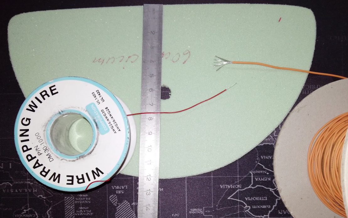

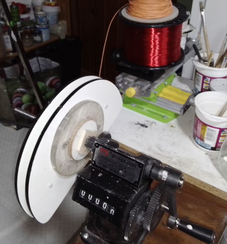

                Winding the AMX coils.
                About 8" DD, TX with 70 turns AWG 22 1x19 tinned wire gives me a dry run of 1539uH and 2.1 Ohm.
                I use a turn counter so that I don't loose count.
                On the coil winder you see the the coil winding form. I make a dry run first to check if everything is correct. Shape, amount of turns, inductance, bundle size etc. Then I unwind and rewind with epoxy resin filled with glass micro balloons.
                For the RX I use Kynar wire wrapping wire AWG 30 and 25 turns.
                The RX coil and TX coil are going to overlap about one inch to achieve a coarse induction balance.
                This coil should give a sweep cover of near 8". The expected depth is not that great but sensitivity to small nuggets should be excellent.
                A DD coil with a diameter of 12" or 14" will give more depth and sweep cover. TBD

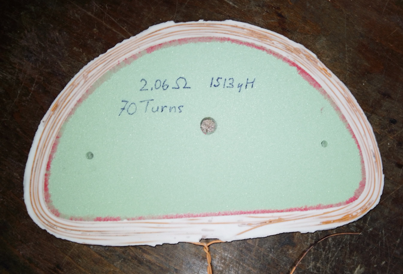

                  And here is the 8" TX coil. Click image for larger version
                  2.06 Ohm
                  1513uH
                  70 turns AWG22, 1x19 wire

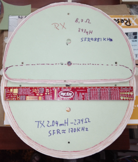

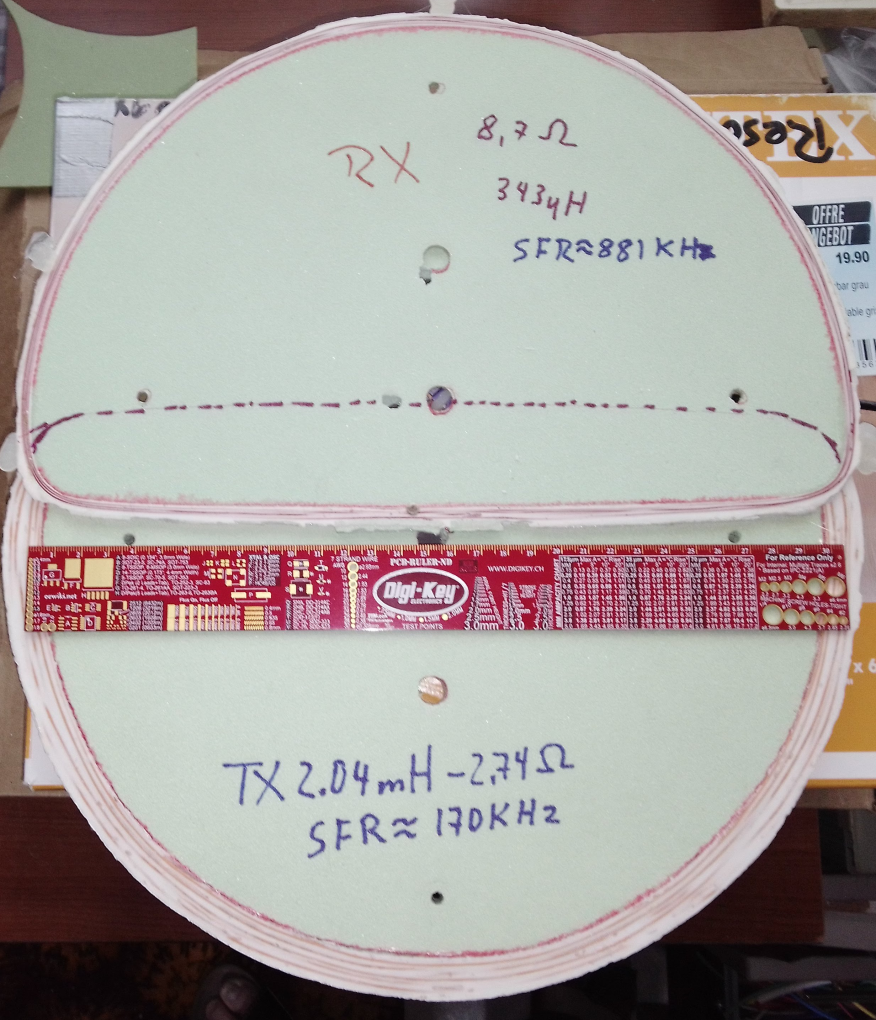

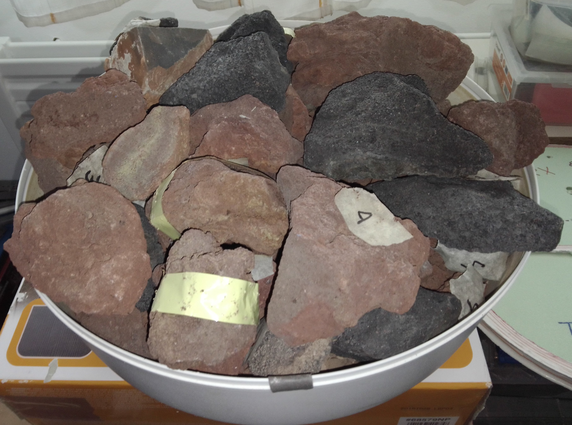

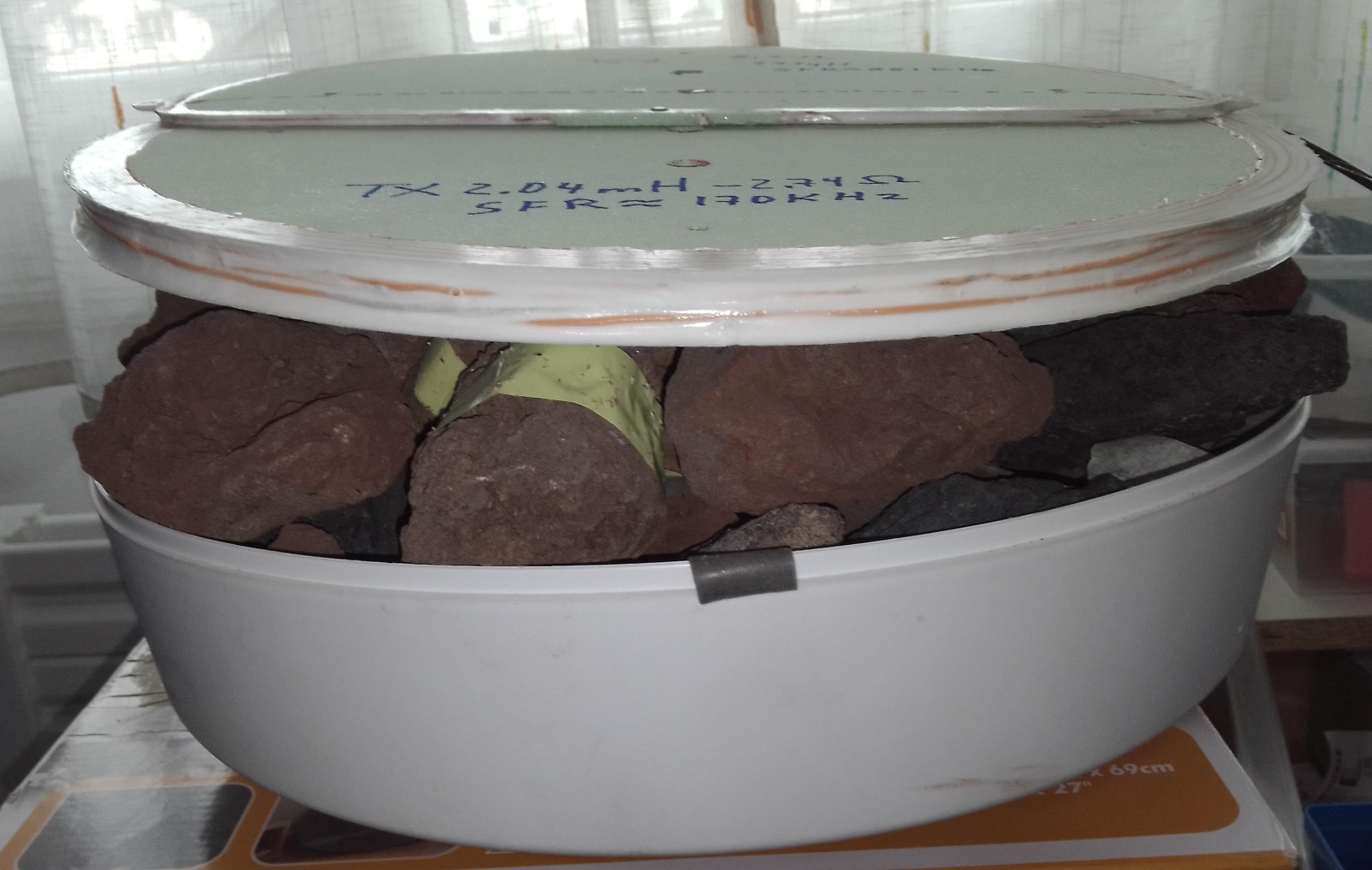

                    Click image for larger version  Name:	DD_COIL_33X38CM.png Views:	0 Size:	1.17 MB ID:	419626 Click image for larger version  Name:	VOLCANIC_ROCKS.png Views:	0 Size:	1.28 MB ID:	419627 Click image for larger version  Name:	COIL_ON_VOLCANIC_ROCKS.png Views:	0 Size:	1.42 MB ID:	419628 Here is the DD coil I used for the tests of the AMX frontend.
                    This is the bare coil. I used a temporary bottom and top graphite shield for the tests. Now I will add the final shield and seal the coil.
                    Coil measurements:
                    33cm x 38cm
                    TX = 2040uH, 2.74 Ohm, SFR = 170kHz, wound with 60 turns of AWG 22, tinned 1x19, insulated 600V wire
                    RX = 342uH, 8.7 Ohm, SFR = 881kHz, wound with 22 turns Kynar AWG 30 wire wrapping wire
                    After adding the shield, the RX SFR dropped to 484kHz
                      Now, looking at the specifications of this coil, quite a few questions could be asked:
                      Why 60 turns on the TX and 22 turns on the RX?
                      Why not 60 turns on the RX and 22 turns on the TX?
                      Or, what would the result be of the coil if it was 33cm x 33cm
                      Or 300uh TX and 300uH RX?
                      Or thicker TX wire or thinner TX wire?
                      So many possibilities with different results.
