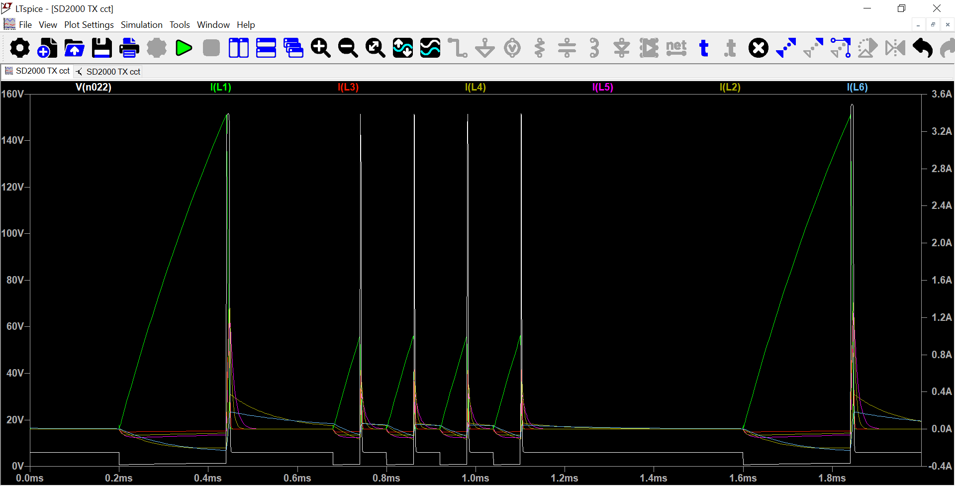

            IMO, I would look at the trade-offs in topologies first. This can be done with a smaller, more manageable coil, say 10-12". Namely, look at the difference between mono coils and concentrics, which can be IB or not. On the mono, vary N to see what produces the best depth with acceptable settling. On the concentric, use an optimal TX and vary the RX in both diameter and N to see what gives the best sensitivity to particular target sizes. All of this can be done on the bench without concern for a housing or even shielding; it's all an exercise in magnetics. Whatever answers are found can be scaled up to a bigger coil.

              Good idea,
              I will start with a 300mm diameter mono coil. Can we consider the attached simulation as a reasonable representation of a Minelab SD2000 TX?

                    I guess I don't understand how the SD2000 relates... it's not a comparison of the TX current or even the field strength, it has to be a comparison of overall sensitivity to a particular target.
                      Do you have a better suited simulation we could use for comparison?
                        I don't know what you're trying to compare. If it's sensitivity of the SD2000 vs the AMX I don't know how you can do that in a simulation. You need to wave a target, which means having a reasonably working AMX. A better comparison for now might be the SD2000 vs the GPZ7000.

                            Now I'm more confused over what the goals are. If it is to optimize the coil design for depth, then things like the pulse rate and bipolar-vs-monopolar don't really matter. They do matter if the goal is simply to get more depth (what Nova wants) but they are generally independent of the coil design. That is, regardless of the coil design, a higher pulse rate will always help, and bipolar will always help get you a higher pulse rate.
                            Some of the other stuff is relevant in varying ways. How eddy currents behave can be important in determining the highest useful slew rate and (by extension) the minimum useful sample delay. IMO, start with the assumption of CCPI and start with the assumption of a medium-high target TC. I would then start with a mono coil and with a fixed diameter (again, it doesn't really matter, the physics are the same) and determine what topology, wire type, gauge, N, etc produces the best target depth. Then move on to concentric.
                            First thing to nail down is the TX driver because what works well for CCPI is probably very different than for a monopolar driver. That's the biggest apples-vs-oranges issue; you cannot directly compare the two.
