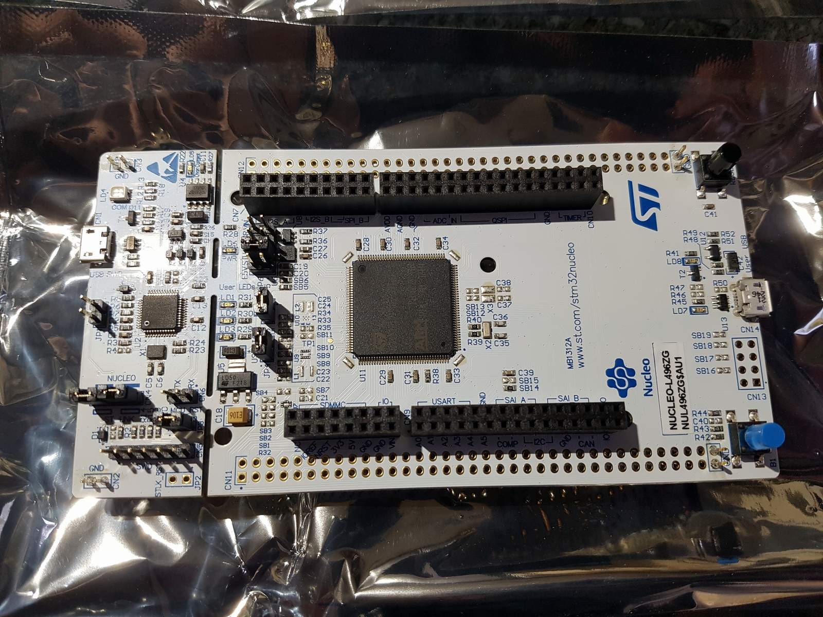

                  • #69
                    Finally arrived!
                    23 days from NY/USA to Sokobanja/Serbia.
                    Now I have real "stage fright"!
                    I have to study these seriously for several days, maybe weeks...
                    Before I start producing white smoke with them!
                    • #70
                      Although I am quite skilled with the Adruino IDE and have done a lot with it so far; I feel like now is the time to add another development environment,
                      a little more "serious" to work with around the Nucleo dev board.
                      I previously programmed the STM32 Blue Pill with the Arduino IDE.
                      But these Nucleo 144 (l496zg) dev boards are far more serious and I would like to use them with a software environment that is adequate for them.
                      Half an hour of searching the net...
                      I found a lot and nothing is clear to me!
                      I found on one page a very vague instruction with suggestions to download 3 packages:
                      STM32Cube IDE, STM32Cube MX and STM32Cube Programmer.
                      Randomly when I read on those pages, about those packages; I don't understand anything, what is it for?
                      Do all 3 have to be installed? What is it for, etc.
                      The short descriptions of the packages are unclear to me, it turns out that you can do everything with each of them?
                      And I can't find any "for dummies" instructions with explanations about these issues.
                      Does anyone of you have the will to write a brief instruction on what and how to explain the exact role of those packages?
                      And in as brief as possible to explain setting up a development environment on a system like Windows.

                        The 'STM32Cube IDE' should be enough for a start.

                          • #73
                            CubeMX is a design tool for selecting a micro and configuring the pins. I've only played with it a little, never really used it.
                            CubeProgrammer is a manual programming tool. I only use it for production-level programming, or when I need to un-brick a micro.
                            CubeIDE is the main tool. It's a GUI development system, similar to MPLAB-X if you are familiar with that. It's all you really need, plus the libraries for the specific processor.

                              I installed it after I saw Willy's comment.
                              And spent some time since then playing with it.
                              Ok, some of the things are intuitive and easy to understand.
                              But some are not and will need certain learning/adapting curve.
                              One thing is annoying me right now.
                              My boards are NUCLEO 144 - L496ZG.
                              So I started IDE, new project, picked right board and even marked it as "favorite" (I guess that's the puprose of a "star" next to a board name in the list).
                              But once I delete the project; I have to pick up the board all over again, from the list.
                              Is there a way to make it always to use the same board as "default" ... or I have to pick the board each time I start new project?
                              As things goes on, I see; I will have to spend much more time watching the videos and reading the documents.
                              Jumping from Atmega 328P to ARM-M4 is not simple and easy at all.
                              It looks scary to me now and is actually a quantum leap.
