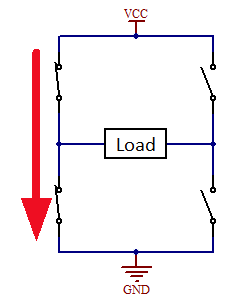

        Coil resistance won't help you protect the FETs. The shoot-through current is the current that flows from positive to negative terminal passing only through the FETs (and not through the coil). And since FETs have very low ON resistance that is quite the same as a short circuit. This is why you need the dead times in the clock pulses that drive the FETs.
        Click image for larger version  Name:	shoot-through.png Views:	0 Size:	3.1 KB ID:	411260
        As to the coil resistance, I think you need it as low as possible. The higher the coil resistance, the more current is lost as heat.

          Now I understand, thanks!
