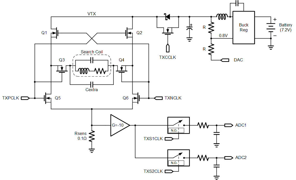

    • Ok Carl, Paul, aynbody else...
      One more question for you, this time a bit more serious one.
      If we look at the schematic you last posted:
      Click image for larger version  Name:	Carl_TX.png Views:	0 Size:	47.6 KB ID:	411196
      There are two signals (pulses I assume) comming from the MCU; TXPCLK and TXNCLK, which, I assume; stands for TX-Positive-CLK and TX-Negative-CLK.
      This means it need the same signal, same pps (or frequency, call it anyway), same duty cycle, same amplitude (5Vpp or 3.3Vpp I assume) BUT with 180 degrees phase difference, right?
      So, You will write code to output one of those two on one MCU pin and another of those two on another MCU pin, right?
      So actually it is the same signal, comming from the same clock, but only one inverted in relations to another.
      In order to run those two fets; Q5 and Q6 properly.
      Question;
      why two pins?
      why not one pin, one signal and then inverter?

      • I suspect the answer is that these two pulses need to be non-overlapping, otherwise you could short out the power supply. Otherwise known as short-through.
            I doubt that. Yet I don't want to deny it too, until I hear Carl too.
            Besides, CD4069/6 has 30nS delay at 10V.
            Six of them. Do the math.
            I just want to se if I can avoid wasting pins on MCU and yet drive the TX without issues.

              I missed your answer.
              Ok, then tell me what would be the timing difference between positive and negative pulse?
              Still doable with one pin, I hope.
              Until Nucleos arrive (hopefully one day); I might try to drive the TX with Arduino, for testing purposes.
              • This is an exaggeration of the timing but it illustrates the non-overlapping pulses and dead zones. I suspect there will be a narrow window of operation. Too little dead time and you get shoot-through, too much and the tilt losses get worse. I may be surprised and find that it's rather insensitive to overlap, but I'd rather plan for the worst than regret I did not.
                    Click image for larger version Name:	image.png Views:	0 Size:	3.3 KB ID:	411209​
                    This project will likely need a 64-pin micro, which should have plenty of timers, ADC ports, GPIOs, SPI, and other peripherals. I don't understand why you would want to skimp on a timer when it only makes the design harder. Let the micro do all the hard work!
                    It's been while sense I've looked at any of this metal detector stuff. Not what I was thinking. I'm thinking coil current at lowest sample time should be the same as coil current at any time above, maybe 10us or 100us. Does anyone have a LT spice for the circuit in #122or do I need to make one?
                    • Nucleo is based on STM32 CPU which has a number of Outpout Compare functions.
                      These functions support the definition of dead-time bewteen complementary square wave signals.
                      With the same timer, you get two complementary pins generating square wave with guarantee of a programmed dead-time made by the hardware and not by software
                          Ok, now I fully understand the problem.
                          Your illustration could not be clearer.
                          Isn't there some method to protect fets in both cases you mentioned (too little... and too much... cases) ?
                          Some kind of super fast "current sensing" circuit that will turn off the circuit or voltage coming from the buck reg. in those cases?

                          • When I look at the schematic again... "Rsens" of 0.1 ohm seems to be the sweet spot for the current sensing point.
                            You didn't explain... or I didn't read it, but is that what the ADC1 and ADC2 samples are for?

                              Yes, and so does some of the PIC32 processors and a few others.
                              This is a good reason to do the H-bridge drive timing within the processor.
                                Yes, you could probably design some kind of fast shoot-through sensor and, with a lot of extra circuitry, figure out a way to deal with the problem. But again, why not just take advantage of the micro and do it the easy way? And yes, I always include lock-up protection in the TX by capacitor-coupling the TX clocks. I haven't shown that yet, but it's in the actual design schematic, which is unfinished. The exact timing is TBD, I won't know that until I build the circuit.
                                Coil resistance almost solely determines power consumption so you want it as low as possible.
