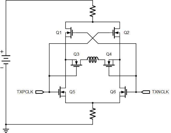

    Adding to the AFE mentioned above: I am following Carl's approach to the AFE and subsequent processing closely. I like the "current mode" configuration and I have always been a proponent of the AD797 (A few years ago, I actually modified my HH2 implementation to use a two stage preamp with a AD797 @ 12x as the first stage... I piggy backed 2 boards to implement the 2 stage preamp and supply the extra supply current that AD797 needed).
      But I wonder; why use of driver?
      Can't logic level fet be used without driver?
      IRLZ44NN comes to mind, I have those...
      The IRLZ44N has a breakdown of 55V. You can use this (and maybe drive it directly from a micro, I don't know) but you will need to add capacitance and slow down the transitions to avoid avalanche. I'm using gate drivers to give me plenty of flexibility to use whatever FETs I want, even SiC. If you can't get gate drivers then make your own, this has been done countless times in other PI circuits.

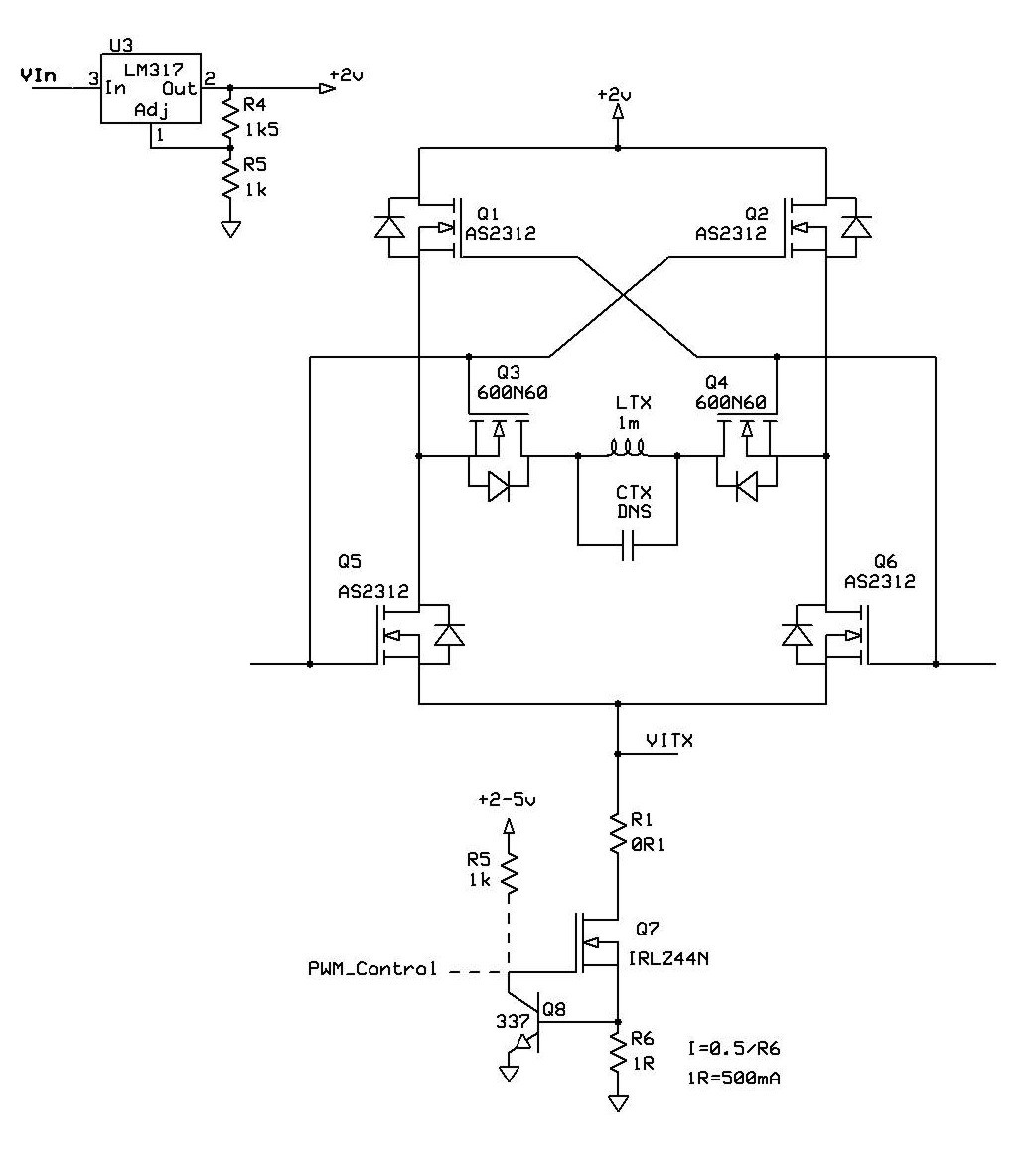

              • You people ... (this did not sound good! oops!) keep mentioning current a lot,
                I still don't understand what you want; constant current? (logical)
                ... or unstable, changing, shaking current!?
                I saw in a couple of places that it figures about 500mA...
                Here is a "poor man's solution" for both a voltage of 2V and a constant current of 500mA.
                And since Carl likes to control everything through code (bosses are usually like that); I added that possibility too.
                I'm sure Carl won't use this but I will, I'll give it a try and see what happens...

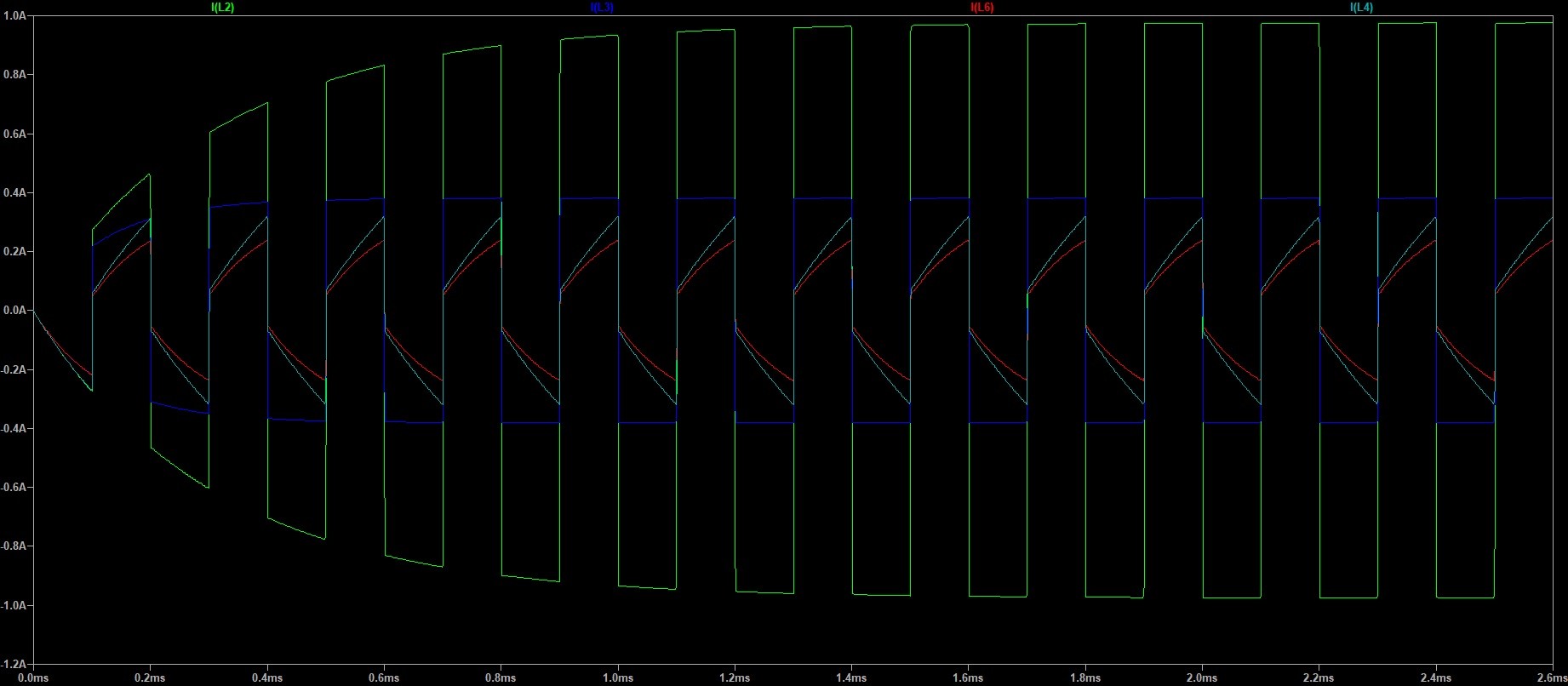

                      What I think is missing is a clear understanding of what causes tilt.
                      Tilt is caused by losses that the coil sees ( ie loads across the coil ... either coupled or physical parallel loads ) NOT series loads ... as series resistive load will reduce peak current but not cause tilt.
                      Measuring at the RX coil only complicates matters if you are trying to compensate tilt and I am not sure why you are referring to measuring peak flyback voltage ... those ccts cant do it. ( not Post #1 in AMX RX you referred )
                      CCPI from startup shown below 0.5 ohms series and 2 ohm series vs 1K parallel load on the coil for the two cases. Absolutely clear that a parallel load on the coil causes loss of flyback and tilting whereas a change in series resistance in line with the coil causes a change in peak current but no tilting.
                      moodz
                          I'm not entirely sure if I understand what you're saying, but series resistance within the coil does affect tilt. During the transition, the currents that convert the coil's magnetic field energy to electric field energy flow through the coil's series resistance, and that causes a real power loss. It happens again within the same transition as the electric field energy converts back to magnetic field energy. So the magnetic field energy coming out of the transition always has to be less than it was going in. Yes, more series resistance will reduce peak current, but for the same peak current it will also increase tilt.
                          Transitional energy loss also has to increase with eddy targets or viscous ground, same as with any other TX circuit.
                          Addendum: A parallel resistor across the coil becomes a series coil resistance during the transition, when the isolation FETs are off. So if you put in a 1k resistor you will see a massive amount of tilt. A series R also affects the tilt, but you have to look more closely.
