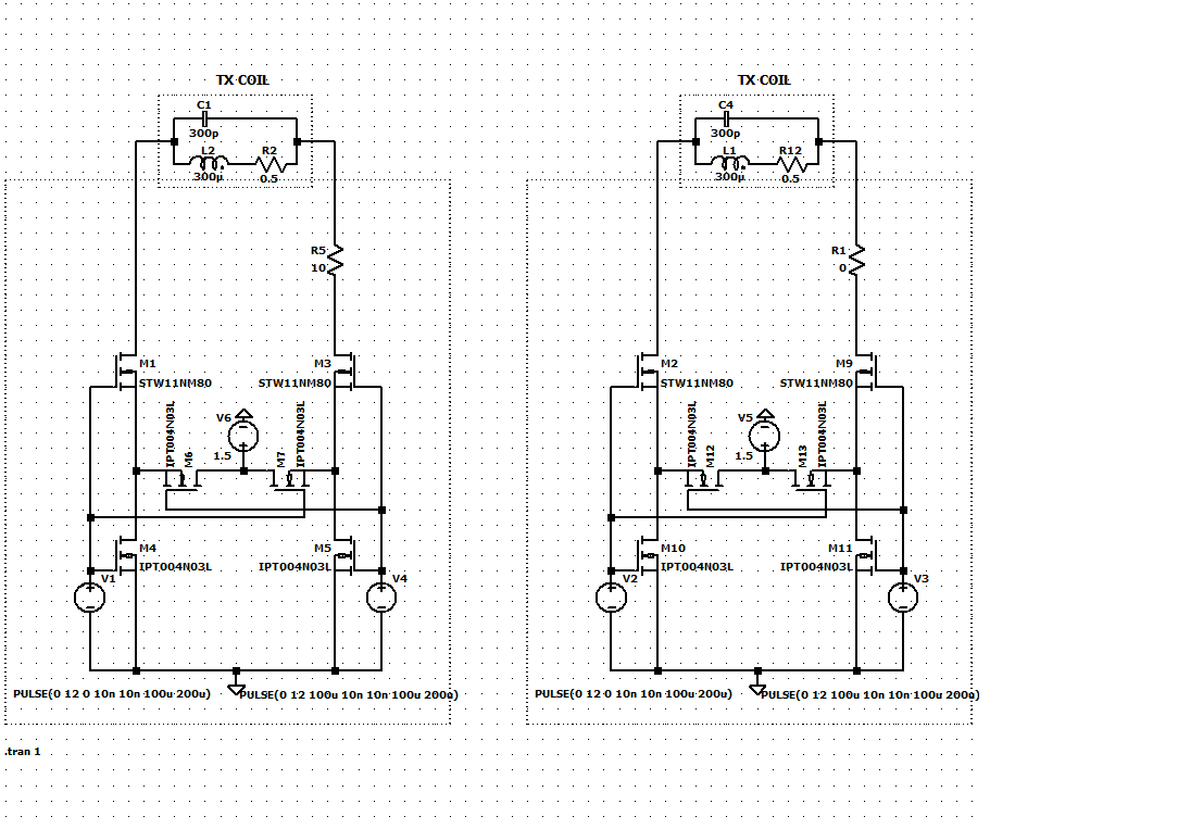

      No that is completely wrong .... if I have a flyback of say 500.0 volts in the TX coil .. that circuit will not give a reading of 500.0 volts .... The RX coil responds to changes in magnetic field ( from anywhere ) ... how can it measure the peak flyback voltage in the TX coil ????
      You are right, a 500V Flyback will not give a direct reading of 500v on the RX.
      The circuit measures the changes in the Flyback voltage.
      Try it.
      You can omit the filters for the try.
        I'm not entirely sure if I understand what you're saying, but series resistance within the coil does affect tilt. During the transition, the currents that convert the coil's magnetic field energy to electric field energy flow through the coil's series resistance, and that causes a real power loss. It happens again within the same transition as the electric field energy converts back to magnetic field energy. So the magnetic field energy coming out of the transition always has to be less than it was going in. Yes, more series resistance will reduce peak current, but for the same peak current it will also increase tilt.
        Transitional energy loss also has to increase with eddy targets or viscous ground, same as with any other TX circuit.
        Addendum: A parallel resistor across the coil becomes a series coil resistance during the transition, when the isolation FETs are off. So if you put in a 1k resistor you will see a massive amount of tilt. A series R also affects the tilt, but you have to look more closely.
        True ... but the point is that a change in series resistance will cause a much larger change in peak coil amplitude than tilt. So if you vary the series resistance you will modulate the peak current much more than any impact on the tilt ... and this would not be good unless your signal chain was somehow using the modulation of peak current to do something.
        Tilt will vary much more with changes in parallel loading losses versus series losses in the coil.
          ... I reckon your DSP algorithm is broken ... come to Australia and try the ground signals here
          We all would love to go to Australia but the flights are booked out.
          Maybe you could explain your ground signals for us?
          Many years ago somebody told me that his detector saw the worst ground in Australia like a steel bottle top at 8cm from the coil.
          Is this an accurate description?
          How would YOU describe the ground signal?
            case in point ... the tilt is "worse" on the circuit with the lower series resistance ( but the peak current is higher ).
            First circuit green trace is fitted with 10 ohms the second circuit blue trace is zero ohms additional resistance.
