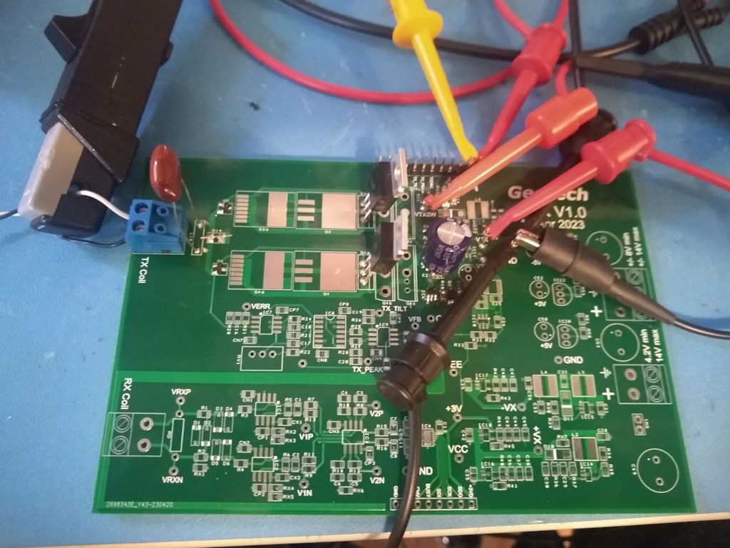

    Boards arrived yesterday, and I am leaving for vacation on Tuesday. So today I threw together a quick test of the TX circuit. Q1-Q6 were installed, and also the gate driver components. VTX and VTXSW were supplied by a bench supply and the TX clocks by a dual channel DDS generator.
    I started out using the IRF740 for Q3,Q4. I quickly found out that if these are allowed to avalanche other parts will get fried. I had to replace Q5 and one of the gate drivers. So I added a 4.7nF "Cextra" to slow down the transitions and reduce the flybacks and everything was grand. Here is the coil current (bottom trace) using a current probe, and the flyback pulses:

    Edit: Here is a photo of the board while testing the IRF740s. Note the big brown Cextra.
    Click image for larger version  Name:	Board.jpg Views:	39 Size:	163.8 KB ID:	412253​
