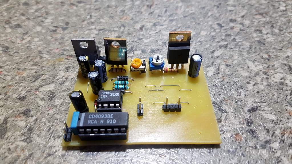

    I received the pcb that I was drawing, "through hole" with the IR driver. But I don't get to solder the components.

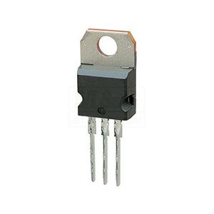

          "S" ? I never saw such one, or haven't payed attention.
          I can get this one only:
          https://www.mgelectronic.rs/tranzistor-irf-740
            IRF740s, plural of IRF740
              Ah so!

                      After much procrastination and delay... I found some time to work on this a bit.
                      The topic kind of died... but when I already have a pcb; I think it's not bad to try the concept.
                      I haven't decided on mosfets yet.
                      For now I just set up and checked the power supply. I have 2, 5 and 10V, stable and regulated.
                      ​​The schematic and pcb do not match in the 5v regulator part.
                      The schematic shows LM317, but in the meantime I changed my mind and put 7805.
