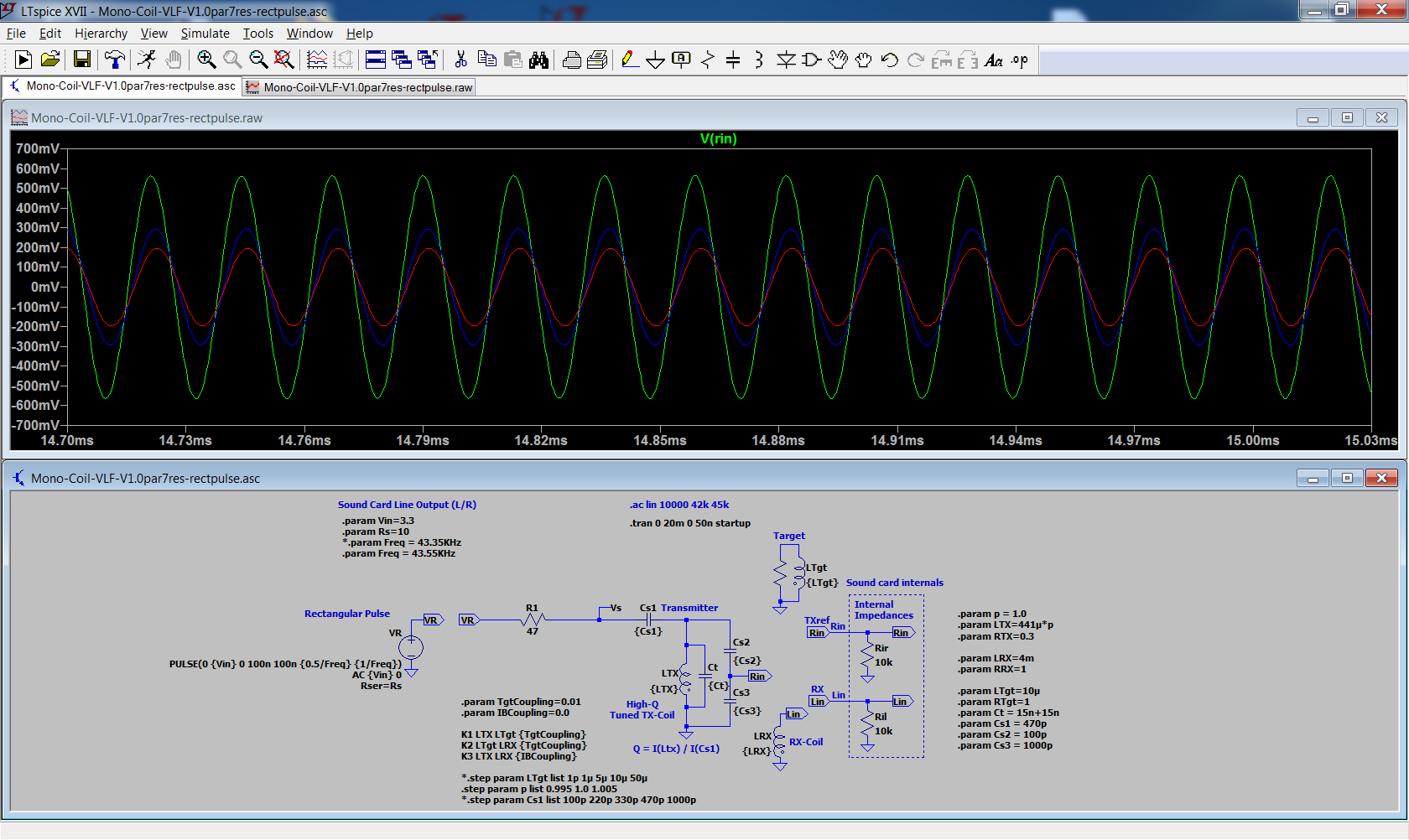

                      The very very basic High-Q LC-Tank driving TX.
                      You can pulse the TX directly out of the logic level IO output line (3.3 V I think in your case). We don't need much TX power. Only few mA. The IO-line should be able to drive the TX. High-Q LC-tanks do not need high power.
                      But imagine, you can do it with a pure mono coil.
                      Below is the simple LC-tank. And a zipped LTspice file.
                      Click image for larger version  Name:	MonoCoilVLF-RectangularPulse.png Views:	0 Size:	125.0 KB ID:	445381 Aziz
                      PS: Forget the RX-Coil part in the circuit above. Single demod of the TXref is enough.

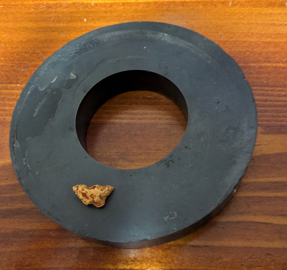

                        Aziz, Sorry mate but I have already been down this path. You cant operate on the Q curve of a resonant circuit and expect to extract any target information at depth.
                        Below is a picture of a test "ground" ferrite and a 1 gram nugget. The ferrite will "pull" your resonant coil changing both amplitude and phase ... and the change in Q makes it even worse.
                        and then you expect to extract the target signal from that huge ferrite signal and overcome the 6 power return loss from TX -> target -> RX. No chance.
                        In air you could make it work ... but any ground or conductive losses like salt are going to cause serious problems.
                        Realistically you are trying to pull say 100 nanvolts out of many volts of noise + target.
                        I do have a suggestion though .... use double sideband suppressed carrier modulation at the TX so that the coil is operated with the LSB below resonance and the USB above resonance.
                        shifts in the LSB and USB will balance out ...by comparing addition and subtraction of the relevant parameters ( phase and amplitude in the USB / LSB separately ) you can resolve targets whilst overcoming resonance drift.
                        It still sucks though as a method.
