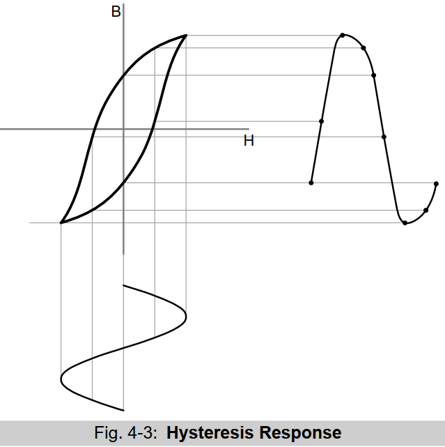

          Nice discussion. With a sinusoidal incident magnetic field the BH curve for iron looks like this:
          and results in a phase shifted and distorted target field. Non-ferrous targets produce phase shift but "no" distortion, so you can theoretically look at the fidelity of the RX signal to determine iron.

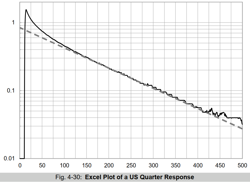

          For a pulse response it's a similar situation, except that it's the decay curve that is distorted with iron but is "not" with non-ferrous. So you can theoretically look at the linearity of the decay curve to determine iron.
          I quoted "no" and "not" because there are caveats. First caveat is that the early eddy response in a target is 'non-linear' due to the self-spreading of the eddy current. That is, it takes time for the eddies to push themselves out to the perimeter of the target, namely 1 tau. Here is a US silver quarter:
          The tau of the quarter is about 150us and it takes about 150us for the decay to settle into the expected single exponential response. If you take a bunch of samples (both early and late) you will get different values for tau. In a sinusoidal system, the result will be that the target will initially have a low phase that (in 1 tau) grows to a higher phase. Iron targets also suffer this same effect for their eddy response component, in addition to the distortion caused by their magnetic response.
          Second caveat is ground. Everything discussed so far (including with AI) is for an air matrix. Ground also causes non-linearities, not only BH hysteresis but also viscosity (time decay) effects. This will turn an otherwise clean-looking copper sphere waveform into a distorted waveform that starts looking a whole lot like iron.
          Ground effects are usually the bane of good metal detector ideas. Everything works well until the target is buried in real ground. I would get AI to start considering ground effects and see how much it really understands the problem. Also, get some real data of target responses with and without ground, for different depths in different grounds.
            Thank you Carl for your input. I agree, we are a long way from a working detector.

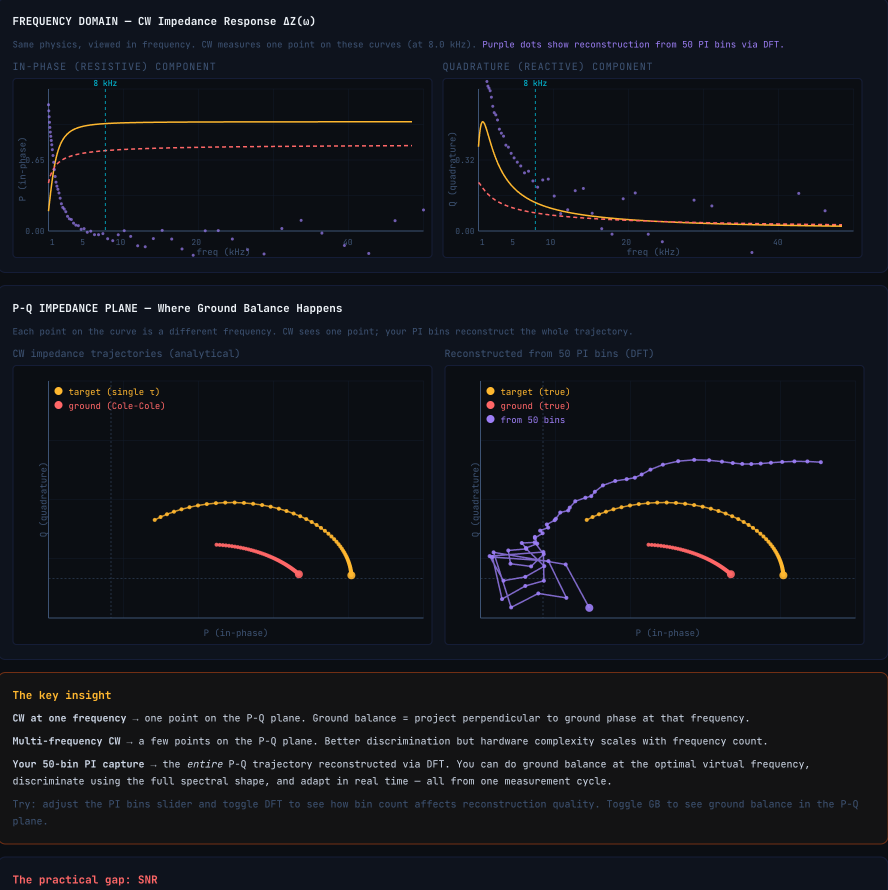

                  So I use a mac mini M4 connected by usb to a chinese board stm32h750 and the AI has complete control of the M4 ( It can theorise, it can develop code, debug it, program the MCU etc ) It just flags me when it is done.
                  The AI acts as an Agent or Coworker .. and you instruct it not to come back till it has completed the task.
                  Below is the result of that process, less than a days work to validate PI and VLF mapping to the IQ space using the deeper mathematics that links processing of a target exposed to a time varying magnetic field ( which covers all types of magnetic detectors ).
                  So the AI implies that ground balance, disc, target ID works "better" on PI than VLF ... but only if you do the math first ... simply because PI has more frequencies to work with.
                  Below is a partial of the "proof" linking VLF and PI together plots of the IQ samples gathered from a PI circuit.
                    Moodz, thank you for your contribution.
                    You say:..your AI is in "patronising mode" ... ie its just telling you what you want to hear and everyone's opinion is spot on.
                    I fully agree. I already tried to get the AI out of this mode, but did not succeed. Do you have any advice of how to get the AI more pragmatic?
                      Just ask it to show you the mathematics required to implement ground balance on a PI detector.
                      Then ask it to show you a visualisation ( eg interactive model ).
                      Then ask it to show you the code ( whatever you want to run it on ).
                      Only ask one question each time.
                      Dont tell it how to do it ( ie let it work out what is required ).
                      Do tell it what outputs you want. ( like a mathematical proof or code or visualisation ).
                      If it does not come up with a plan first .. its probably not a good AI.
                      If it only offers stuff scraped from the web .. then its not good AI.
                      If it does not propose a number of solutions / options ... its not a good AI.
                      If it keeps agreeing with you and never disagrees then its definitely not a good AI ...
