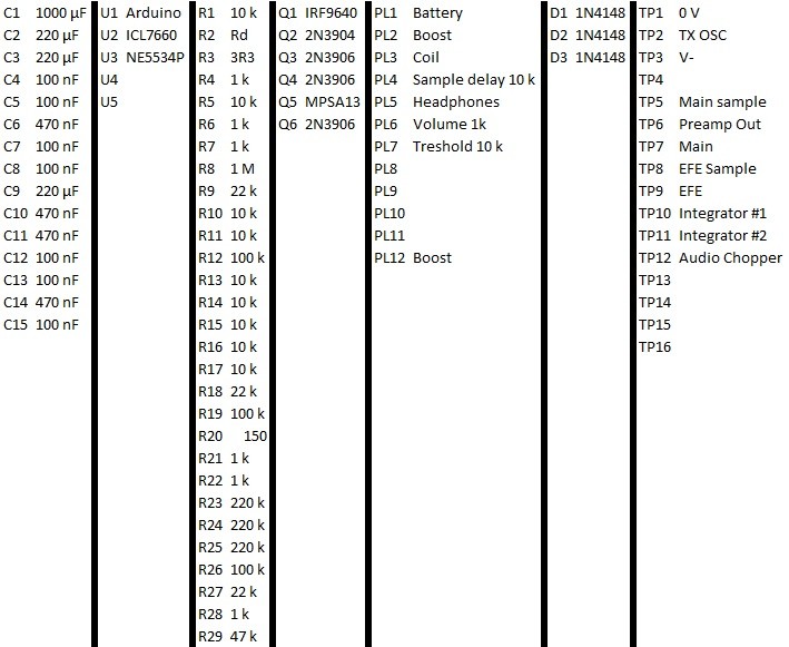

            • Hello everybody. I would like to built this metal detector, but I can not probably find list of all parts. I wrote down all the parts from the pdf schematic file, and I found out Im missing U4 and U5. Than I was checking all the rezistors, but I do not know which of them are trimmers. Can anybody help me please? Im attaching the list of parts I found on the schematic file. Thank you
              • Originally posted by tomas.turcar View Post
                The Components Parts List is in Appendix A of the book.
