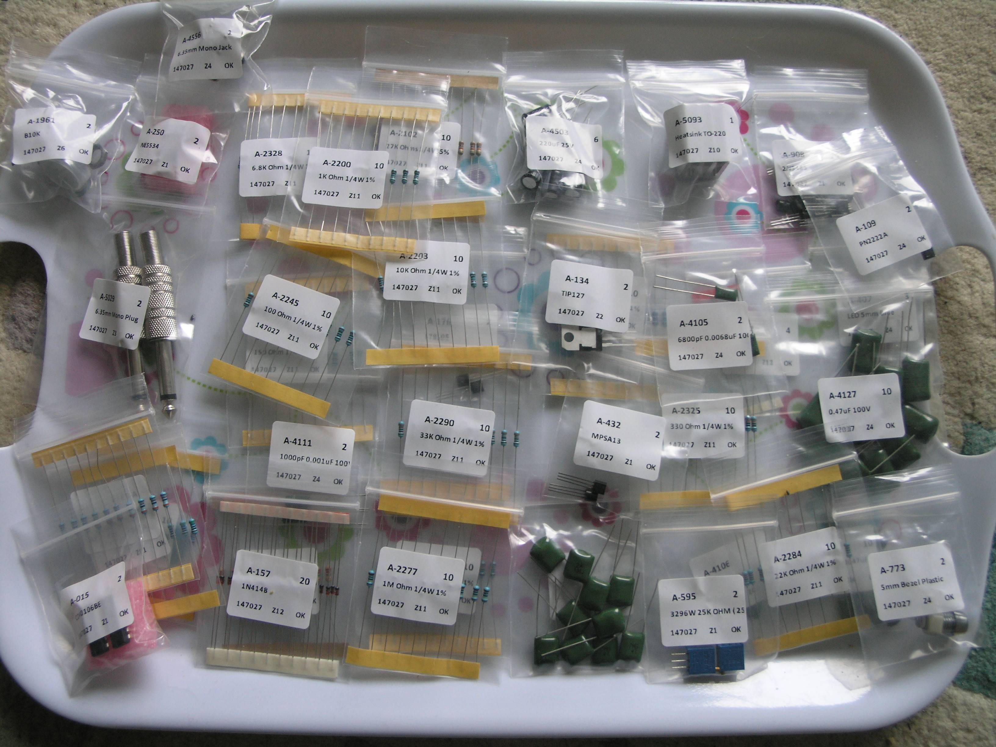

        Some parts have arrived from Tayda.
        Good price. Good service. Best of all everything is in grip seal bags with clear labels.

                Used Tayda Electronics TIP127 = $0.35 only took a couple of weeks to arrive. Everything in clearly labeled bags. 90% of the components needed were in stock shocked at how much cheaper than Farnell it turned out. Well pleased will be using Tayda again.
