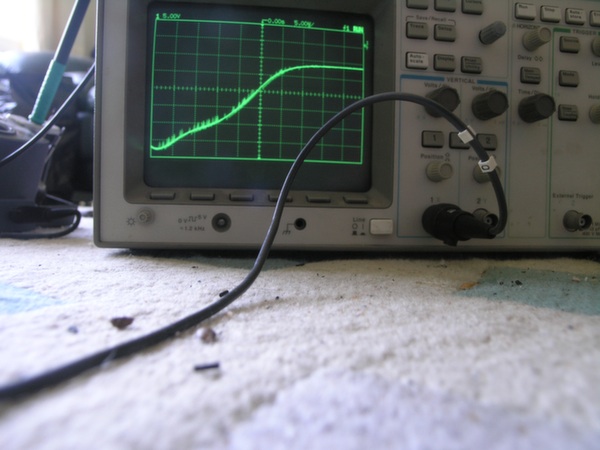

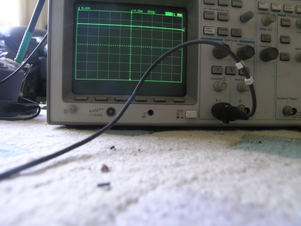

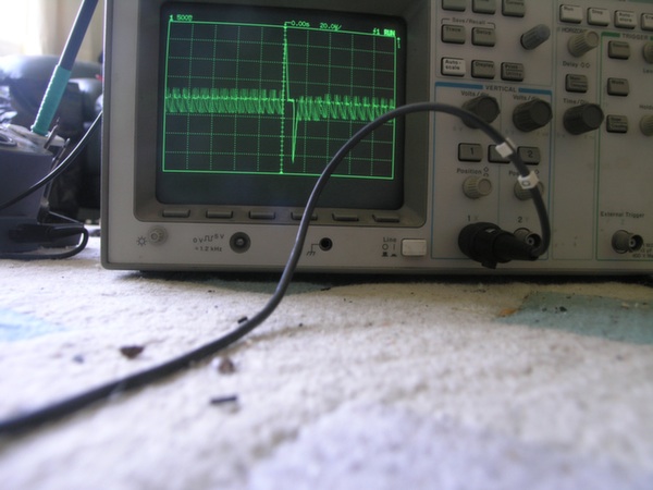

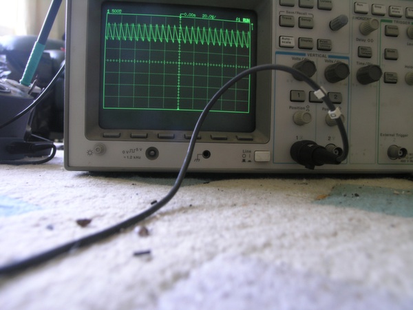

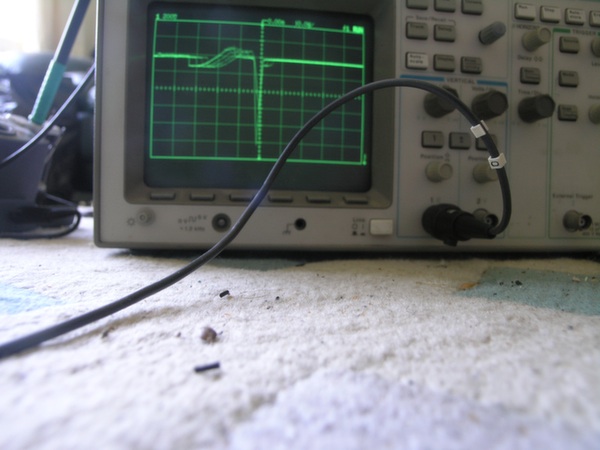

    Tried a 2n222 still not working but different can detect gold at 2" at 8 volts but still noise on coil flyback

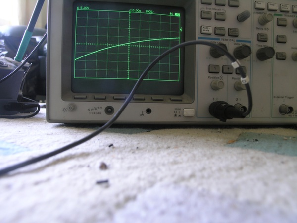

    here are a few traces

      Getting somewhere. If I add a 220µF capacitor from between the 78L05 and GND the the flyback does not have the noise on it. Have to do some work on delay and offset as these are now different but gold is now detected approaching the coil not moving away
      As most people don't have this problem does it mean my 78L05 is faulty ?

            Something still not right. @ 7.5 supply volts the +-5 are spot on unit works okayish . @ 8.2 supply volts +-5 volts are still spot on but unit does not work but threshold sound is more stable.

                Something on the board has also gone though as now there is no threshold sound and 12V but still okay on 7V however the flyback is now wrong. There is a distinct step halfway through the flyback and on 12V the TIP127 instantly gets hot.

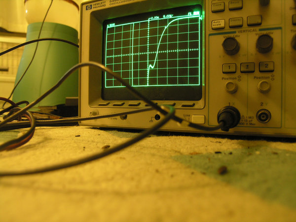

                  This is what the flyback looks like now

                    back to a working ish detector. Changed the 2n2222 and TIP127 only to find it was the scope probe causing the glitch in the fly back. Threshold is back but don't know which one was the problem as I was only looking at the fly back.
