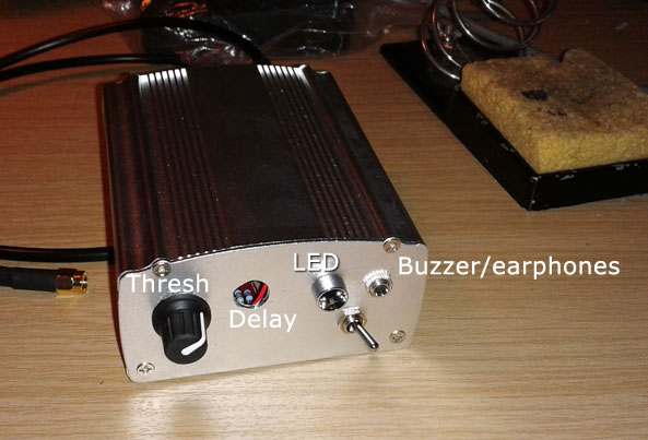

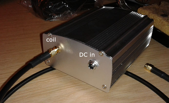

                Have made some new work and put the whole thing in an aluminium casing
ID:	339610Click image for larger version

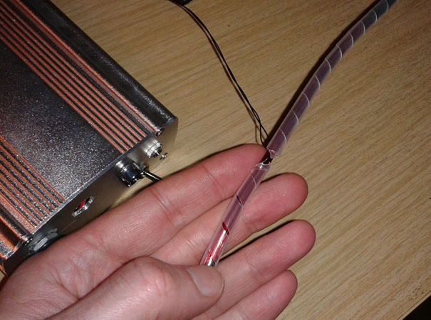

                RGB58 shielded cable and now working on a shielded coil to go with it. It is lacquered copper wire 26 turns that I measured to about 1,5 Ohm and 430 uH.

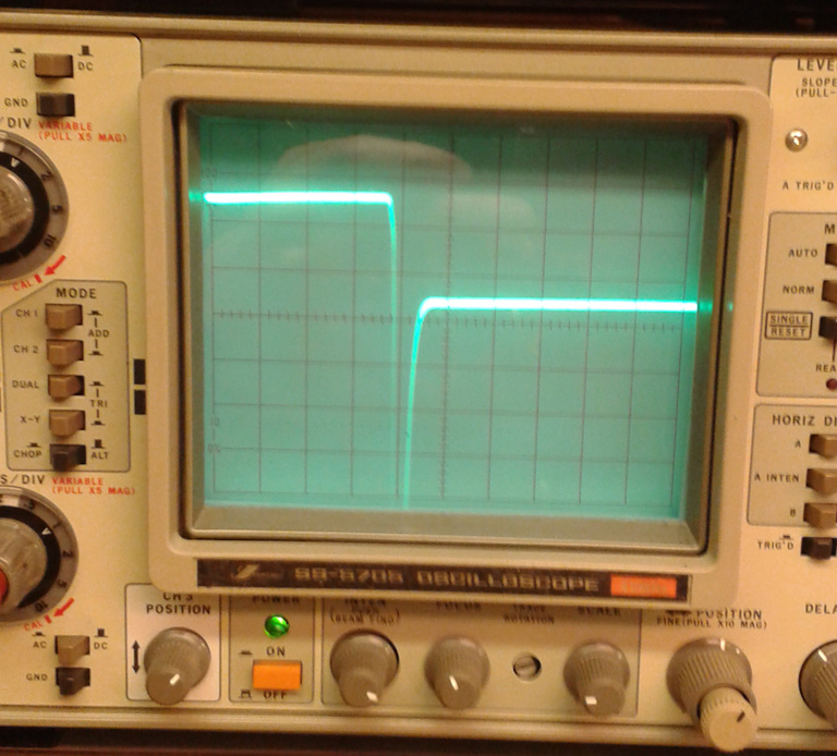

                Connected the baracuda to an oscilloscope and measured pin 6 on the "can't-remember-the-number" and tried to get the output pulse as close to the receive signal as possible, but the closer I got the less sensitivity it gave... But this was before all the casing, shielding etc. Any ideas on other ways to calibrate it or is trial-and-error the only way?
                  if you have a plug on the coil end of your coax ditch it, wire it direct to the coil(a plug on the control box end is fine), when tuned properly the barra will detect it! if you dont get falseing from it it could reduce depth.

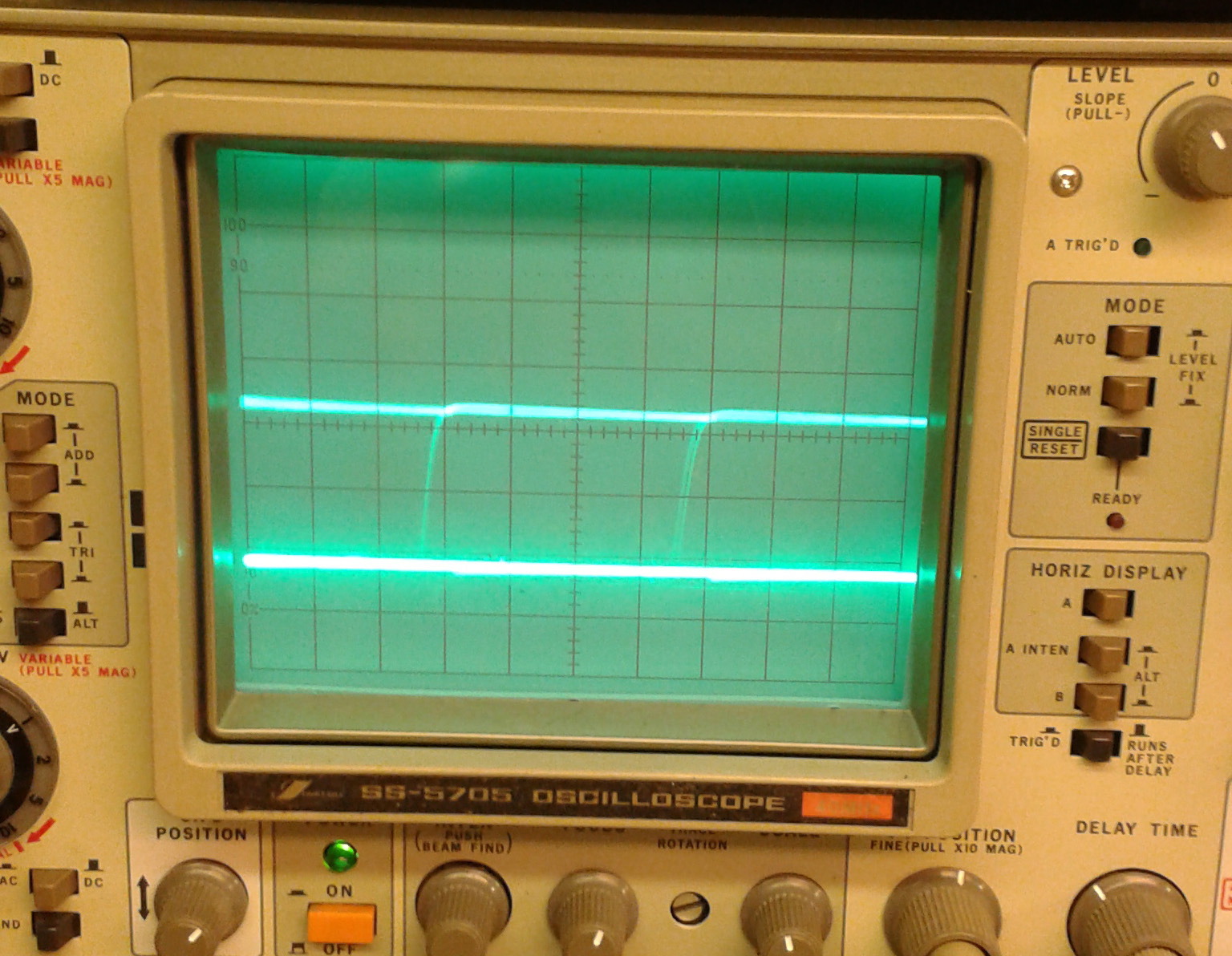

                      The first picture shows the output. No problem there:
                      But then there is something wrong when I measure pin6 on the 40106. When I adjust the delay the spikes move in relation to each other but can't get them separated and they are not at all in sync with the output signal. Have I blown something?
