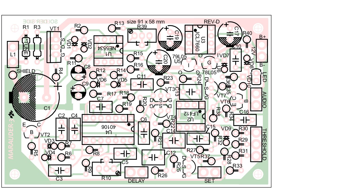

If we change into SMD layout will it decrease barracuda performance? I saw this http://www.paulallenengineering.com/blog.html see that SMD placement machine though expensive it look like Robots replace the fun...
Nice to see your fine work KT315!! Yes I can, I just want to share that machine exists. I was working as cellphone technician at nokia era in 2003 DCT4 flashing etc, anyway in audio projects my preamp/guitar fx went out "thin" sounding after convert it into SMD, so for anyone built the SMD version or perhaps you already done, please tell the difference in performance.....thanks
thank you =) how to use SMD ICs if you have a board for DIP I give links.
10Pcs SOP8 SO8 SOIC8 SOT to DIP8 adapter PCB http://www.ebay.com/itm/10Pcs-SOP8-S...sAAOxy4eJTKpxK
5pcs SO16 SSOP16 TSSOP16 SOIC16 MSOP16 to DIP16 Adapter Converter PCB http://www.ebay.com/itm/5pcs-SO16-SS...YAAOxy039TOmSX
Very nice design! Might be good to connect the battery directly to the main supply cap to minimize voltage drop in the high current paths. You could solder directly to bottom of board or C1 leads. Put switch in series with battery + Would be interested to hear if this helps performance.
