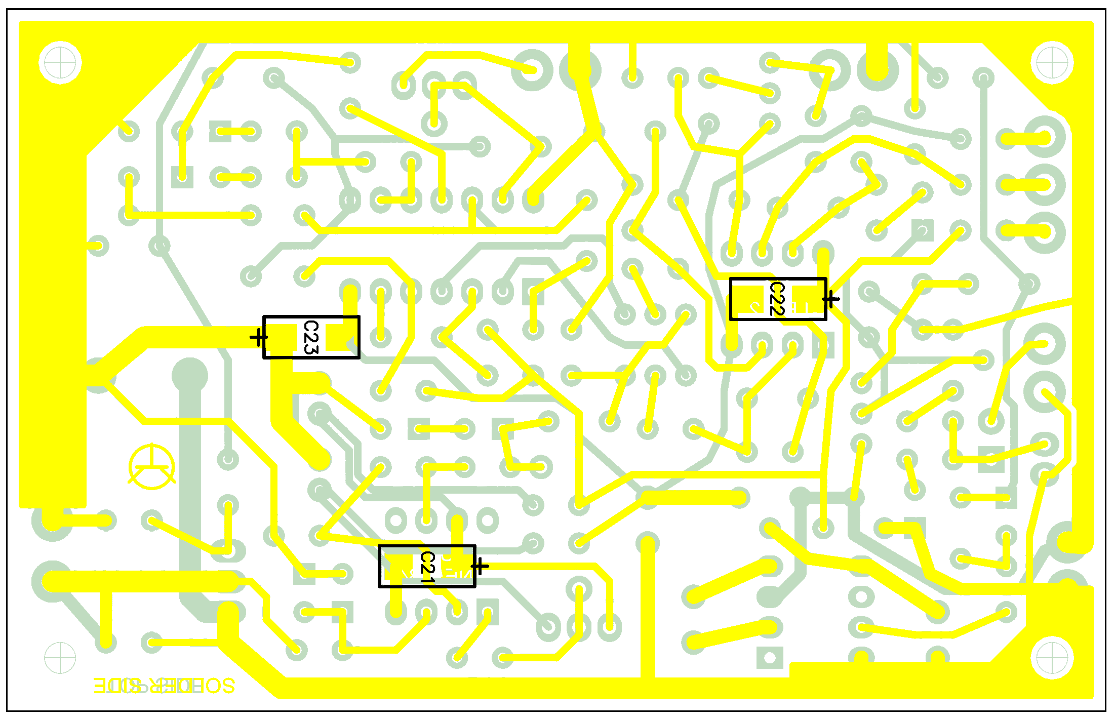

        preliminary part list
          tantalums polarity

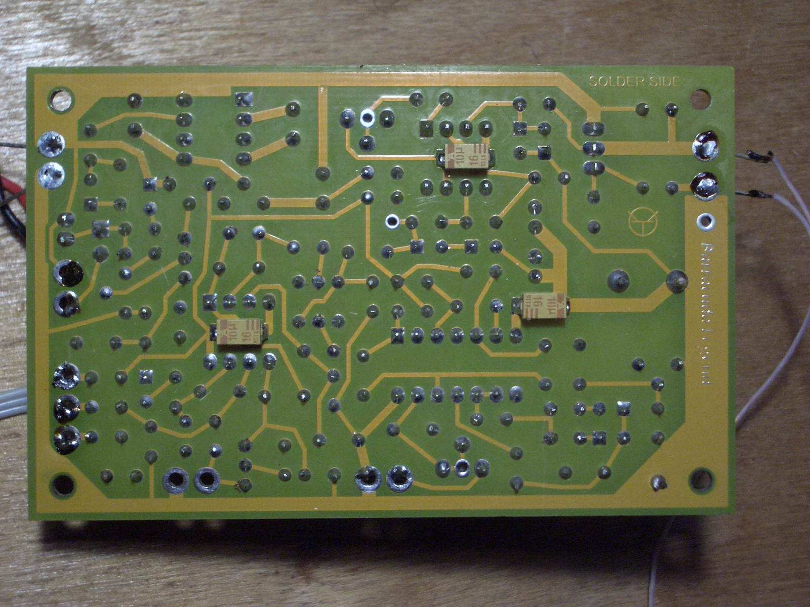

                            tantalums placement
                            tantalums on botton side
