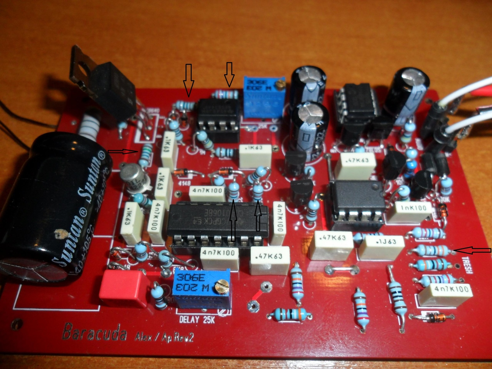

    hi Psyborg can you check color of this resistor
    i have remark on this picture

      Psybord try to put a pot connected on the 2 blank holes beside your delay trimmer or solder a wire to short it...i think your problem is that.
      And since i never been tried using Silkscreen board i have no idea if those empty holes in your picture which should be shorted are have connection already..just check those neccesary holes to be shorted first if it is connected.
        @ Paku
        I check all resistor what you remarked, all good.
        @ Jladre
        All empty holes are already shorted.
        I change the ne5543 today. No change of behavior.
        I m waiting of a shipment of a new LF412 and 7660s.

                No but do not know what to do so i will change all IC on board. It would be nice if someone described the work of all integrated circuits on board.
                  How to check if 40106 is working?
                    Do you see voltage change at output of Lf412 with metal in coil ?
                    Piezo buzzer has polarity, check it is connected correctly
                      Check buzzer. Output A is 4.82V. Output B is 1.46V constant.

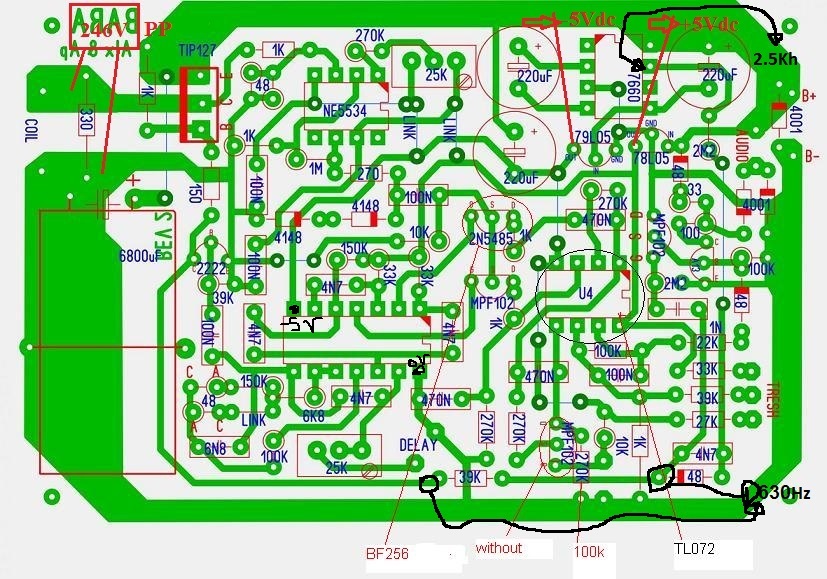

                          I check buzzer and polarity is good. I tried it today new LF412 and 7660s. Still nothing. Tomorrow I will try a new 40106.
                          If it does not work after the new 40106 I will all unsolder and start from scratch.

                            hi
                            i think it help you

                            • #44
                              I've tried to reverse the buzzer of my bara before and it still give sounds
                              • #45
                                now you got sound
                                can you tune the offset to zero
                                without coil
                                then put you treshhold to min
