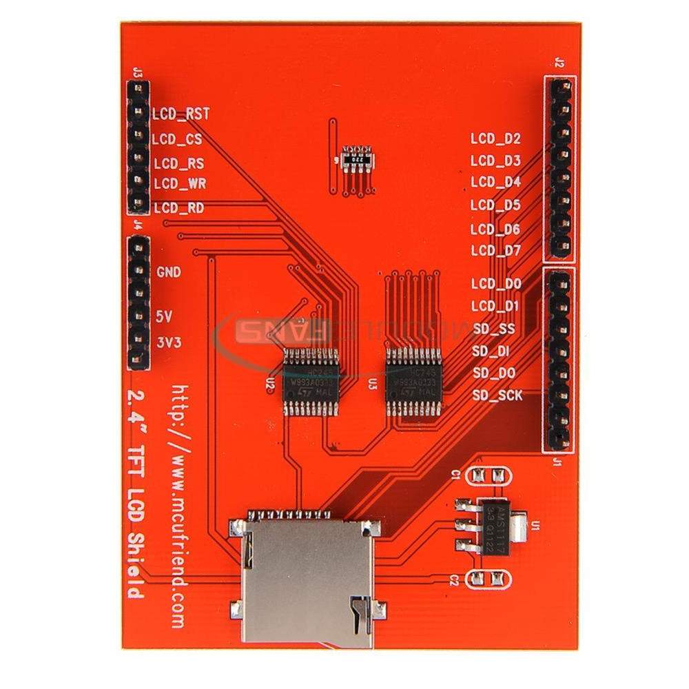

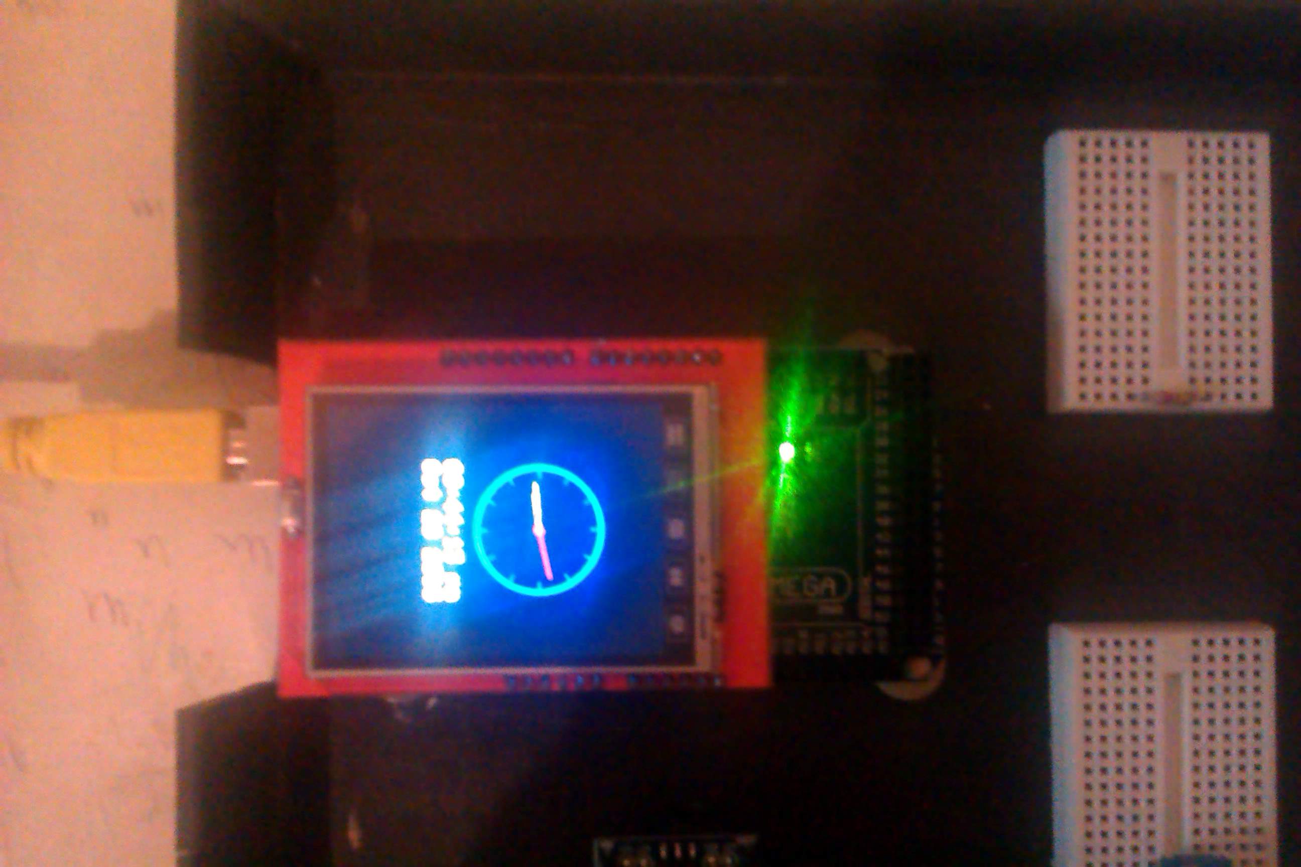

          2.4" TFT with touch and micro SD are cheap (~10euros) and available. I have few. But so far i managed only to use TFT part while am struggling with touch and micro SD reader, can't find proper libraries. That TFT seems is not the same one sold by Adafruit which is well supported with libraries.
          When i try to use those libs; i get inversed touch behavior. I tried to mess into lib parameters, but so far i got nowhere.
          But anyway, similar one sold by Adafruit is just right and well supported. So since it is also having touch; there is no need for physical knobs and pots.
          That would be indeed splendid to use one of those.

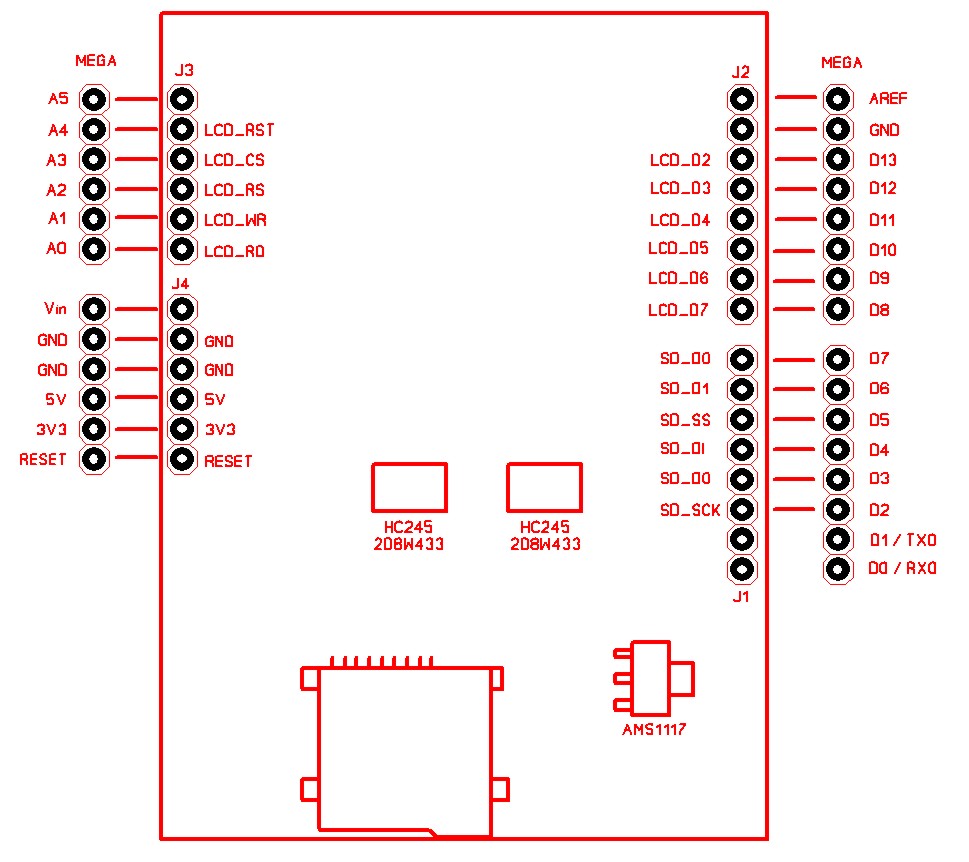

          • #95
            Arduino UNO lacks on sufficient I/O once TFT shield is attached on it.
            That's why i used MEGA which is having more than enough I/O's.
            But also i was thinking to adapt TFT shield to use it with UNO, simply by desoldering and rejecting micro SD from it.
            Would it be enough for similar PI detector? All depends on how code is written.
            Further if i give up from touch; more I/O's are salvaged, should be enough for detector.
            TFT color display is just nice, but also it's kind a stupid to use it without touch.
