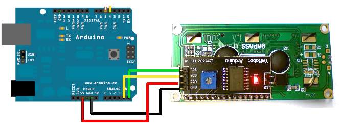

        Ok if you plan versatility for your code than leave I2C uncommitted by now.
        Use SPI instead.
        Why?
        Because later you may want to engage I2C for other peripherals.
        For example; one of the code versions can still use ordinary 16x2 (20x2) LCD through I2C adapter (nice option, gives you more free pins).
        Or you may want to add external I2C eeprom, or something else.
        I am having these:

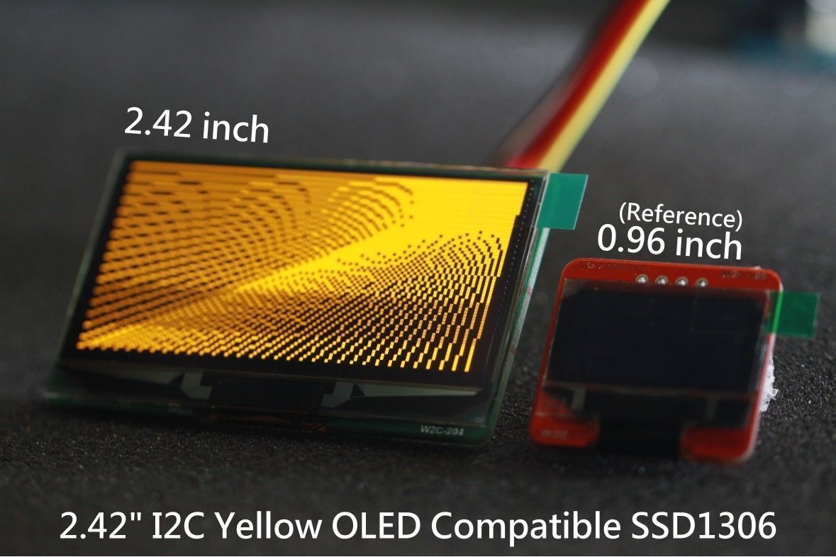

                        • I have seen a do-it-yourself detector with a Yellow OLED that was great in daylight and in shade. Some other displays work well in sunlight but need a high backlight level in shady areas and on cloudy days. The small 1” displays are hard on us old guys with glasses.
                          Have a good day,
                          Chet
