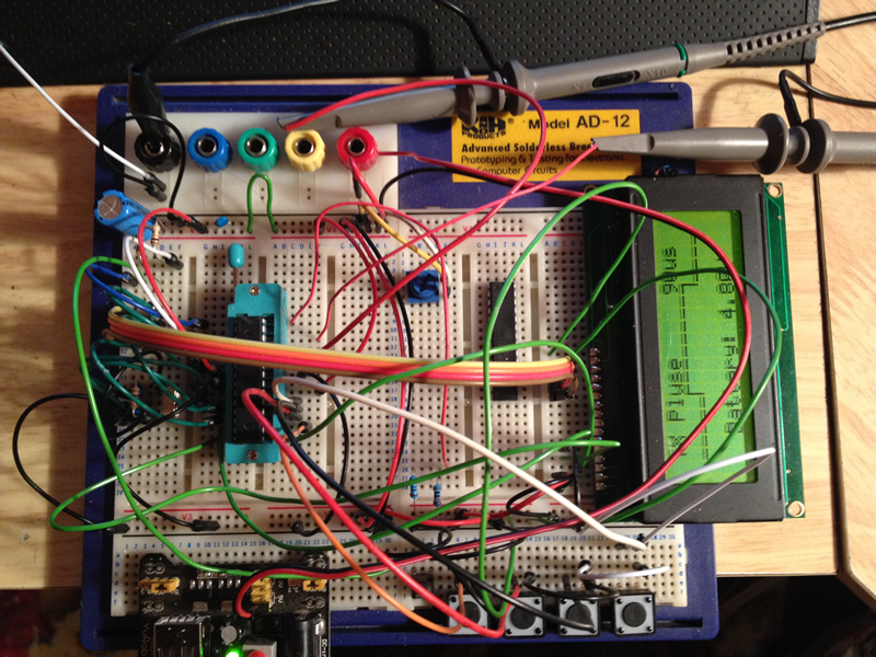

      Here's a high tect approach to protyping Click image for larger version
      I don't have a 16/2 LCD ATM but have ordered a couple, for now I'm using a 20/4 LCD... will probably stick with that for the prototype but may also add 5110 version too (just to see)...
      You may notice the (pseudo) pulse graphic in the image, it's proportional to the timing pulse (1 character space per 10uS but we can show 5uS too).
      The pulse graphic changes width as you change the setting as too does the actual pulse itself...
      The code is pretty crappy right now but it works... I will clean it up before posting as I'm sure you guys can fix it or even change to for better code...
      I'll be building a test on veroboard tomorrow (today, it's AM) and connecting to my baracuda (40106 removed/disabled and power supply changes as per Rev 3 proposal)...
      Will let you know if I get any improvements in depth (previous bara build wasn't great but it could be my coil)... Still it will be great to set the pulses and know there perfect...

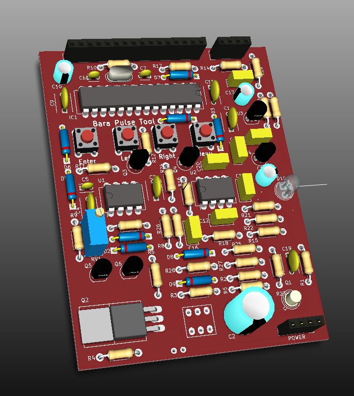

              Here's a 3D view of the current board... It's 90x70mm... It's just a starting place... might make it a little neater...
              For testing I'm using 4x 18650 Lithium Ion Batteries and one 5 volt reg for the micro...
              I tap the centre of the batteries for a virtual ground... The regulators need about 6.2 volts minimum... that's 12.4 which may be an issues, might need to rethink the supply...
              Mike

                Hi Mike
                Nice looking board. For the LCD do you plan to use a parallel interface; I didn’t see a serial input listed with that display.
                The 4 x 18650, 16v battery pack should work fine; they fall off quickly toward the end. Setting the low battery alert around 12.6v should be close enough. See some 18650 discharge curves at the website below.

                      You can buy a serial interface board that piggybacks on the LCD for small money but we don't currently need to reduce the pin count on the Micro so no need for it yet...
                      I'd set the battery warning at about 3.3 x 4 = 13.2 and cut off at 3.1 x 4 = 12.4 but the Bara doesn't draw that much current (on average that is), so should be good for most of the day but I would always bring a second set of batteries just in case...
                      I've made the board bigger so it will fit nicely inside an aluminium box (100x97x35mm on ebay for about $5/$6), it looks very good with the baracuda Rev 2 inside and just a couple of potentiometers, Earphone jack and coil socket....
                      Batteries are a bit tight but I may put them in a separate box... not sure yet...
