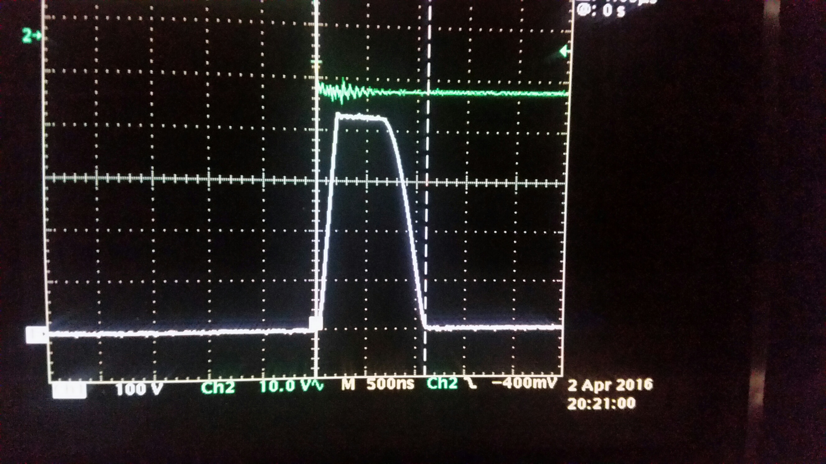

        • I could be cheeky and say that using 500ns timing steps just means you are not working on cutting edge PI's ... however consider the attached pic .. it shows a flyback pulse with 400 volt peak and 1 usec total duty ... active damping brings this pulse to around a few microvolts within 40 nanoseconds of the falling edge. In fact one of the sample pulses on this pi is only 40 ns in total length .... so 500 ns is completely too big.
          Originally posted by scrungy_doolittle View Post
          500 ns is slow for hi spec pi work, I'm not sure I would agree. So run your counter at 24 mhz, and then you have 40 ns which is better. The approach I was going to use on the GG project, was to not sample that way.
          The chosen processor has a 10 mega sample 12 bit ADC, start sampling the moment the pulse is started, and let the ADC along with a DMA put the data into memory. Hardware counters are good, but we were looking at a 1 usec sample time. Not sure that 20 ns is necessary.

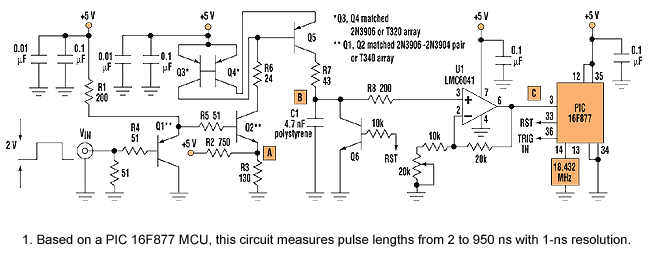

          • ... I will add this comment also ... 1 ns resolution is provided natively in some processors now ( eg picxx ) ... however this circuit is a beauty without using particularly fast clocks ( and YES Virginia it uses ISR to do the main work ).
            Its also a great circuit to use in PIs ... ( not for this application .. something else ... however the idea does not belong to me so I cant say what it is at the moment )
            Nanosecond interval timers are a critical component in products as diverse as time-domain reflectometers (TDRs), collision-avoidance systems, radar altimeters, and nuclear instrumentat...
              [ATTACH]36079[/ATTACH]
              http://electronicdesign.com/test-amp...icrocontroller
              Q3 and Q4 should be a current mirror but in the configuration shown they're not.
