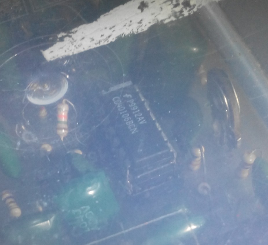

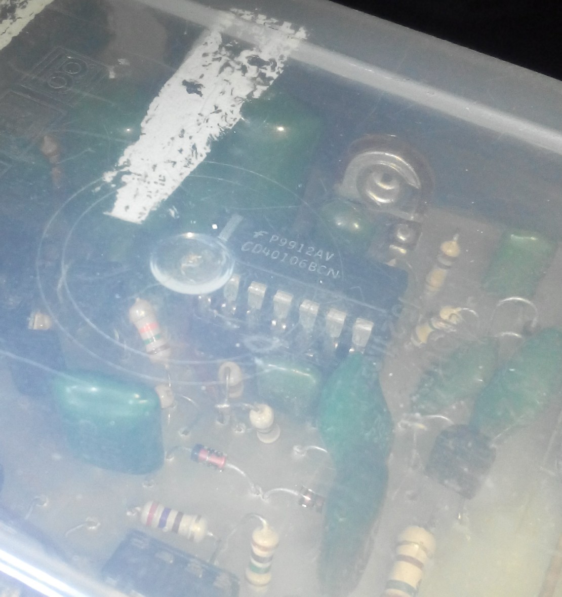

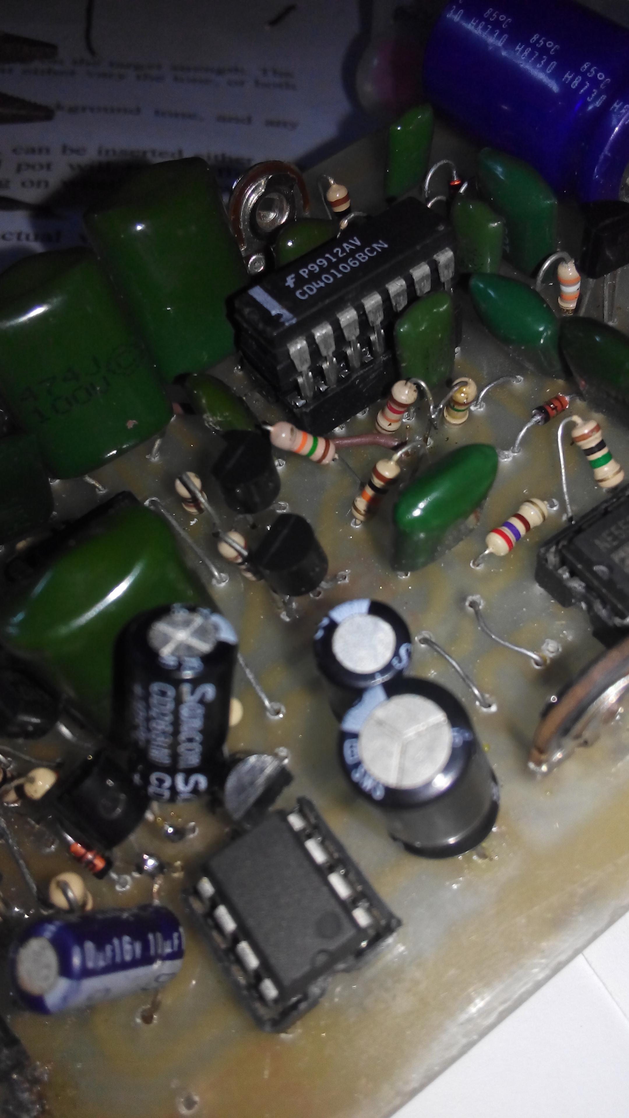

For those who have couple of defective cd40106 from the previos design try to put it in parallel in this corrected lay out.. i have 5 not working well ic and i got two of them works more powerful than the good one when put in parallel.Attached Files
356uH, 1.2R, adjust delay until minimal sensitivity to magnet then set the damp resistor. Thats all i did. With a new 40106 only 1 inch is differnce. But my lucky parralel bad ic always outlast the new one.Originally posted by ionut_mtb View PostGoodjob! did you adjust it with scope? what measures have your coil (resistance, inductance, wire )?
The parralel
