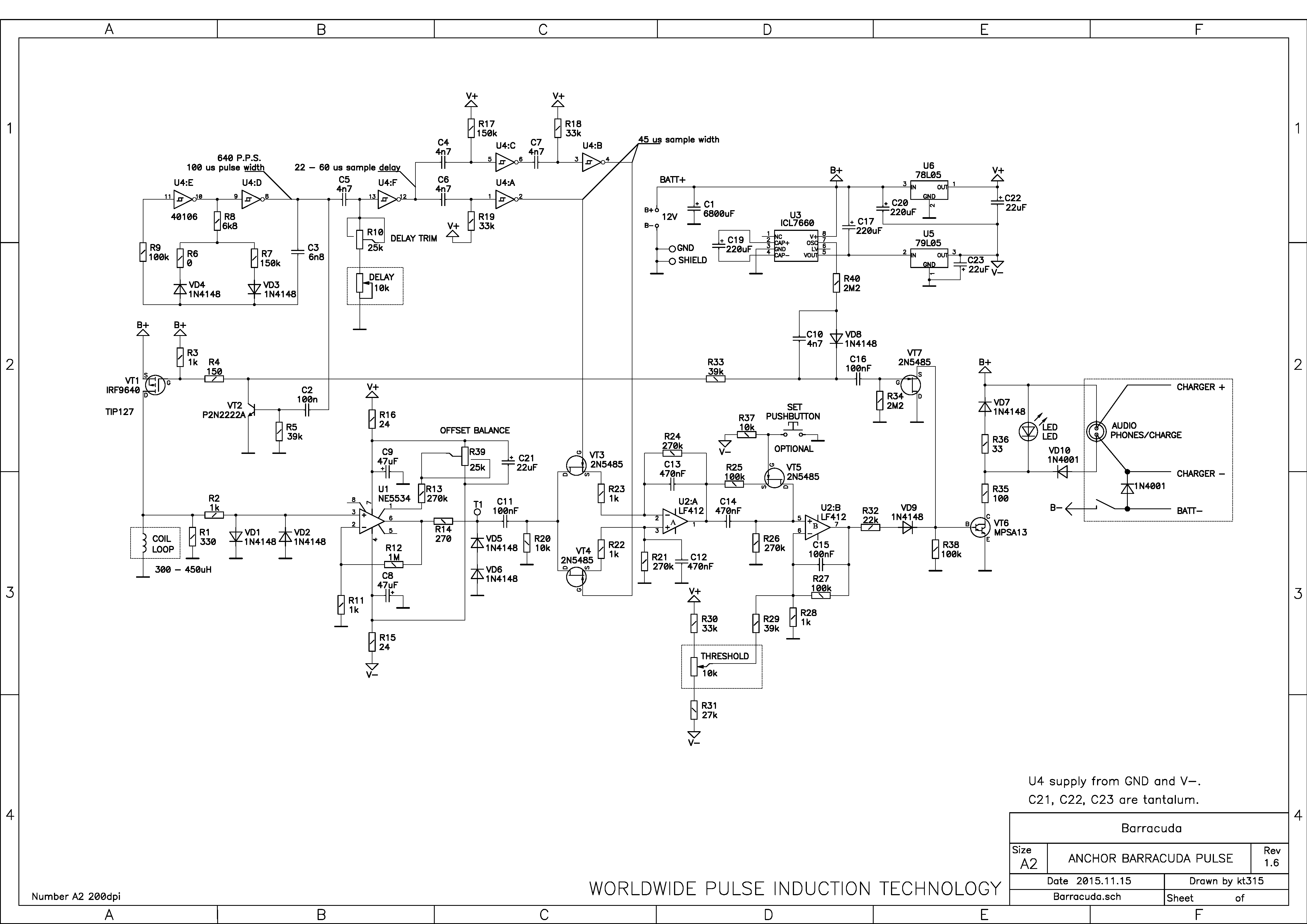

    My problem is that I build yesterday the Baracuda Rev B 2.1 and it worked fine. I tried to fine tune it.But then a wire from the Batterie fall apart and came on the layerboard somewhere.
    Now the Baracuda dont work. I still have the 5V and the -5V on the LF353 so i think that the 78L05 and the 79L05 work. Then I checked the 0V on the pin 6 (NE5534) but there was now 3V and when i try to adjust that it jumps from -volts to + volts i cant reach 0v anymore. Sometimes I can get a signal from the coil but I have to go so close to the coil. I am not so good in eletrical schematics but I can read values with my miltimeter and oszilloscope so I hope somebody can say me check this or that and it must be this value.

    OK i checked now the power supply The 78L05 input 12v output 5V so this is ok. The IC7660 has input 12v output -12v goes into the 79l05 and it comes -5v so this is ok to. I am not sure for what the osc output is (7660) but there i have something with 8volts.So i think my power is ok and i have to go one and check other parts but there i need some help

        5534 could be fake if bought from ebay.
        But, since the circuit seemed to work correctly before dropping the battery wire into the circuit I suspect that this blew out the 5534 and maybe other chips.
        Been there and done that with lots of cursing then chip replacement.
        The power circuits seem good.
        I would pull all the chips out and use Ohmmeter and check for shorts.
        Then put in the timing chips and test that the coil is pulsing and the sampling pulses are working. You really need an O'scope for this.
        Then put NEW chips in one stage at a time and test each stage.

                Those are the rev A schematics I have and refer to.

                  Its the Layout/schematic from kt315.

                    The schematic shown in your attachment contains the design errors described in points 1, 2, 4 and 5 in the Introduction of the Build Document.
                      Yes, but this is not the problem. The Layout is working.

                          The pullup resistor mod will have a big effect on the depth. Also (if you don't make all the changes indicated in points 1, 2, 4 and 5) it will only be a matter of time before it stops working due to stress on the 7660A voltage converter.
