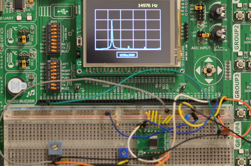

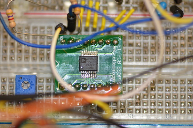

            I'm already on the AD5933. It's a fantastic little chip. I like
            how you can calculate the phase and magitude from the Re and Im
            for each frequency. I wish the adc was 24bit, nothing a preamp
            won't fix
            My application idea for this chip is similar to the Geophex GEM-2.
            It scans a number of frequencies and then plots a composit based
            on resistivity and phase. More info here
            http://www.geophex.com/Publications/...uly-August.pdf
ID:	334536Click image for larger version

                    Hi Bklein,
                    I have been experimenting with this chip. The DDS will only go up to 100khz. So probably not much
                    use for a P.I. coil analyser. For VLF it would make an excellent coil analyser. Connected to a PC it would
                    make a great automated production and QC tester. Programmed to test multible frequencies. Then compare phase
                    and magnitude readings against stored benchmark values.
                    I have designed a single frequency metal detector with this chip and will present the details soon.
                    It has been tested on a bread board and now finishing the pcb
                    The challange will be to make a broadband multi-frequency detector.

                      maybe not such a big challenge ....read the data sheet for the chip very carefully ... it has an inbuilt programmable step freq sweep function so you just read in the data for each sweep and the multifrequency analysis is done.
                        And for expanding the frequency range of that IC, up/downconversion could be used - though at that point it's about the same hassle to go with a quadrature DDS and synchronous I/Q demodulation for the same effect.
                          Hi Moodz,
                          I am well aware of the sweep function. The challenge is to have TX and Rx stages with a flat response across sweep range.
                            The challenge is to build a coil with a flat response.
                              Coils do have flat voltage response, and targets response directly proportional to the voltage. Also Rx coil is a voltage pickup, so all in all you have flat frequency response, provided you apply voltage source at Tx and high impedance preamp input at Rx. Resonance at Tx can serve as a partial energy conserving approach, but with voltage source applied across a tank the resonance is of little consequence to coil di/dt, because it is exactly the same as the applied voltage.
