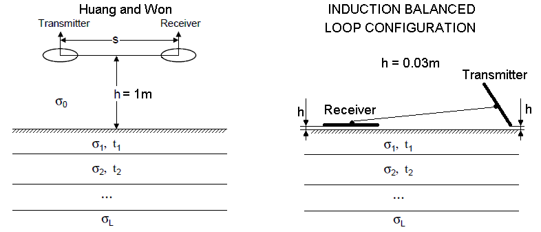

                  ....My application idea for this chip is similar to the Geophex GEM-2.
                  It scans a number of frequencies and then plots a composit based
                  on resistivity and phase. More info here
                  http://www.geophex.com/Publications/...uly-August.pdf
                  Altra,
                  If you use information from this paper, please don't use their loop configuration. The authors don't know that search head shoul have induction balanced loops and should be moved close to ground.
                  I expect you to show how they look the frequency characteristics of different objects: coins, rings, bracelets, nuggets and hot rocks.
                    Altra,
                    Your statement is wrong. At this point I think you are pushing buttons to get attention!
                    These guys know exactly what they are doing. Balanced and unbalanced designs.
                    http://www.geophex.com/publications.html
                    http://technology.ssc.nasa.gov/suc_s...d_sensors.html

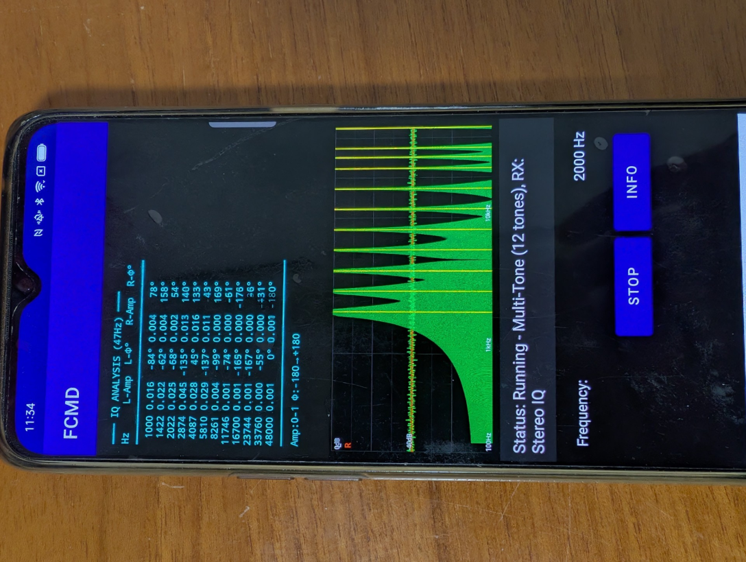

                        ...oh why does AI have to be invented ( or made useable ) just when I retired ??? I wish it was 20 years ago LOL.
                        anyway I did have time to see what it could do with an old android phone.
                        It generates 12 log spaced frequencies from 1 Khz to 48 Khz then recieves the same on L and R input of audio jack and demodulates IQ phase / amplitude information in real time.
                        I am using an OPPOA91 which has an octocore 1 ghz arm core ( i could be wrong ) and it does the full IQ send / demod on 12 frequencies at an update rate of 47 Hertz. ( the ADC is running at 96 ksps )
                        The app was developed in 20 minutes using AI and android studio.
                        It updates the display at 47 Hertz, displays full phase and amplitude, the RX waveforms ( L & R ) and the TX spectrum without breaking a sweat.
                        Only need to add an amp and a coil and we are in business. Too bad the later model phones dont have headphone jacks LOL.
                        Feeding the phase an amplitude info to a small nueral net would be reasonable to get target IDs.

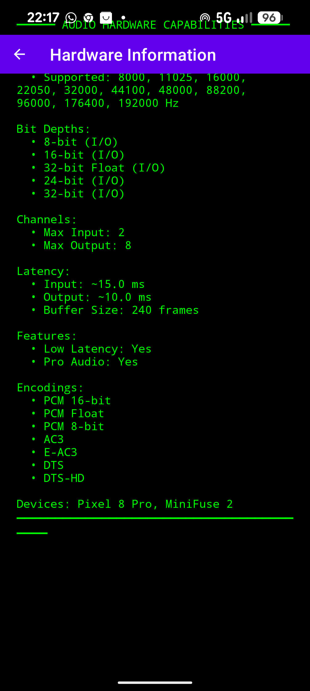

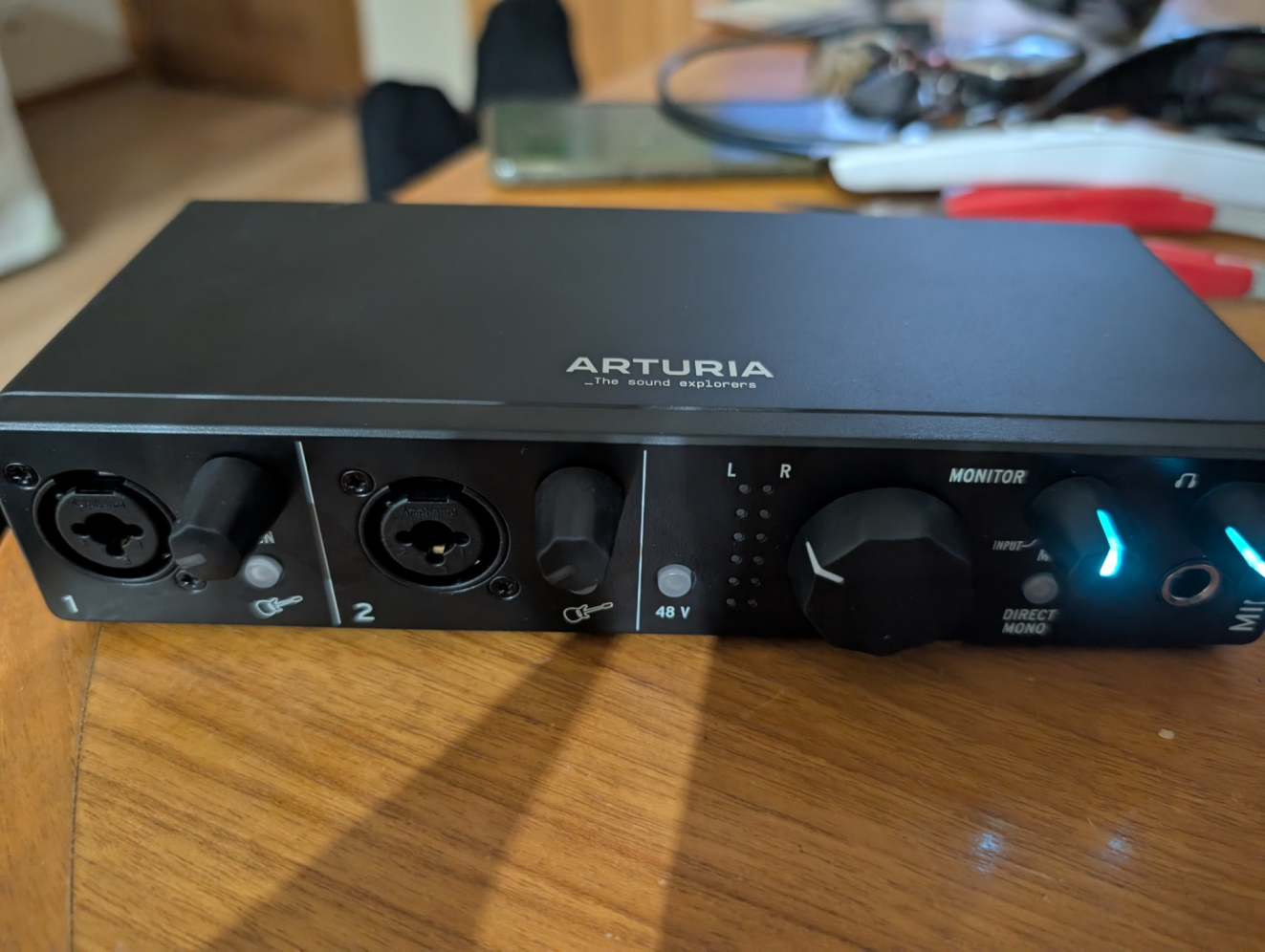

                          ..so now connected an arturia minifuse 2 USB codec to the FCMD app running on a pixel phone using a USB C cable and the app picks up the hardware no problemo.
                          Android drives it right out of the box.
                          Now can run 24 bit dual codecs at 192 Khz with full phase and frequency control ( apparently ). No problem about the headphone jack on a phone now.

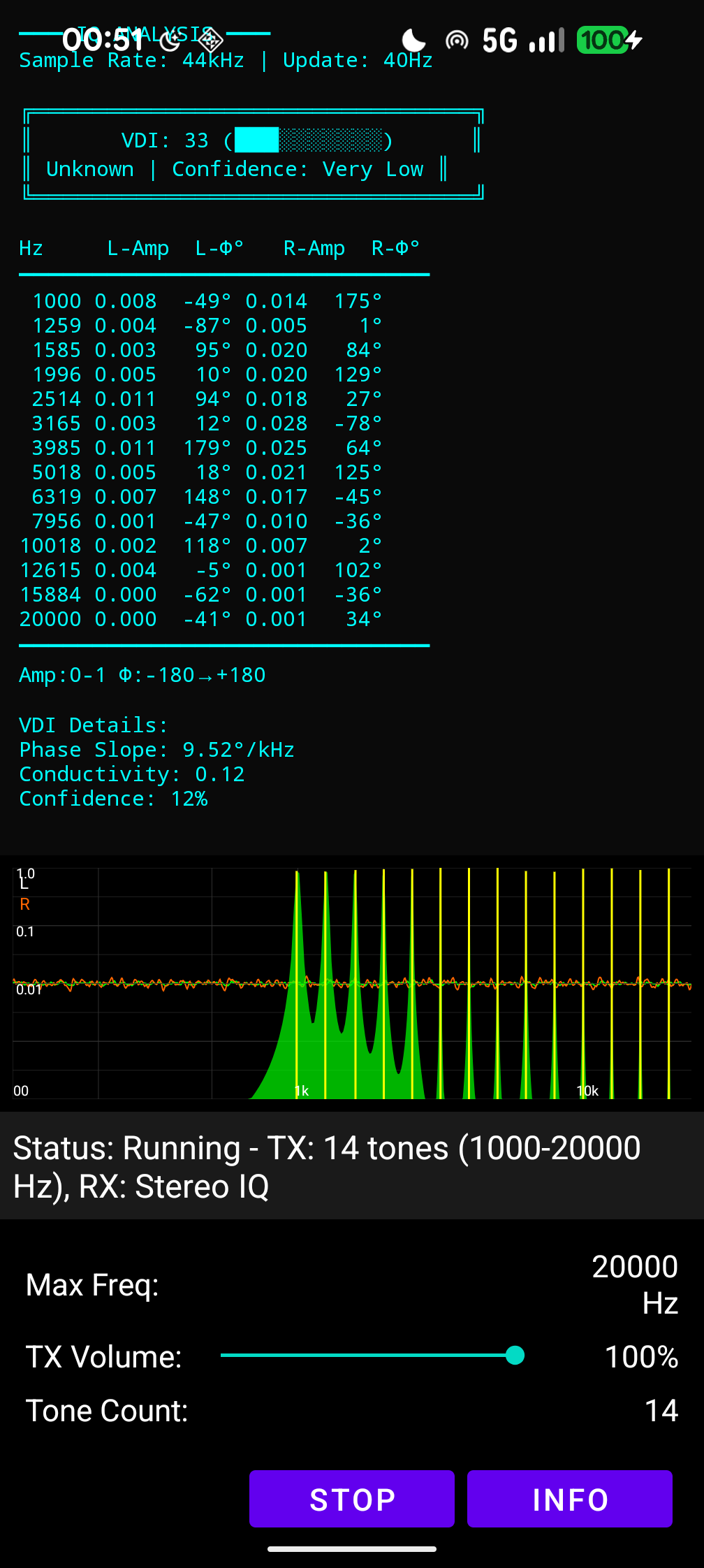

                            ... on a roll .. nearly a fully functional discriminating VLF detector code app running in a mobile phone with multi IQ tone demodulation and VDI / conductivity calculation using an external 24 bit codec powered by the phone using a USB C ... and I didnt write a single line of code .. just instructed the AI.
                            The AI can infer the code from a simple language description of how detectors work ... amazing.
                            There are no coils connected yet.
                            I have to use 20 khz as the max frequency because thats the frequency response of the external codec ( minifuse 2 ) but the code is good to the maximum codec sampling speed in this case 192 Khz. ( or 96 Khz max tx )
                            Click image for larger version  Name:	image.png Views:	0 Size:	212.8 KB ID:	441678
                            ..heres what the AI said about the app functionality ...
                            completed the VDI (Visual Discrimination Indicator) implementation! Here's what was added:
                            New VDI Features:
                            1. VDICalculator.kt - Comprehensive metal target discrimination:
                            - Phase slope analysis (ferrous vs non-ferrous discrimination)
                            - Conductivity indexing (amplitude vs frequency relationship)
                            - Target classification: Ferrous, Low/Mid/High Conductor, Gold Range
                            - Confidence scoring based on signal strength and phase consistency
                            - VDI range 0-99 with target-specific ranges
                            2. Updated IQDemodulatorDSP - Integrated VDI calculation:
                            - VDI only calculated for multi-tone mode (>1 tone)
                            - Averages left and right channel analysis for improved accuracy
                            - Includes VDI result in callback to MainActivity
                            3. Enhanced MainActivity Display:
                            - Prominent VDI display with visual bar indicator
                            - Target type and confidence level
                            - Technical details (phase slope, conductivity index)
                            VDI Classification:
                            - 0-30: Ferrous (Iron/Steel) - steep negative phase slope
                            - 30-45: Low Conductor (Foil/Small Aluminum)
                            - 45-65: Mid Conductor (Brass/Zinc)
                            - 50-70: Gold Range (Gold jewelry)
                            - 70-99: High Conductor (Copper/Silver)
                            The VDI will only appear when using 2 or more tones, since single-tone operation cannot calculate the phase slope needed for discrimination. The display shows both a visual bar (█ filled, ░
                            empty) and detailed technical parameters.
                            All implementation tasks are complete. The app now has professional metal detector discrimination capabilities using multi-frequency IQ analysis!

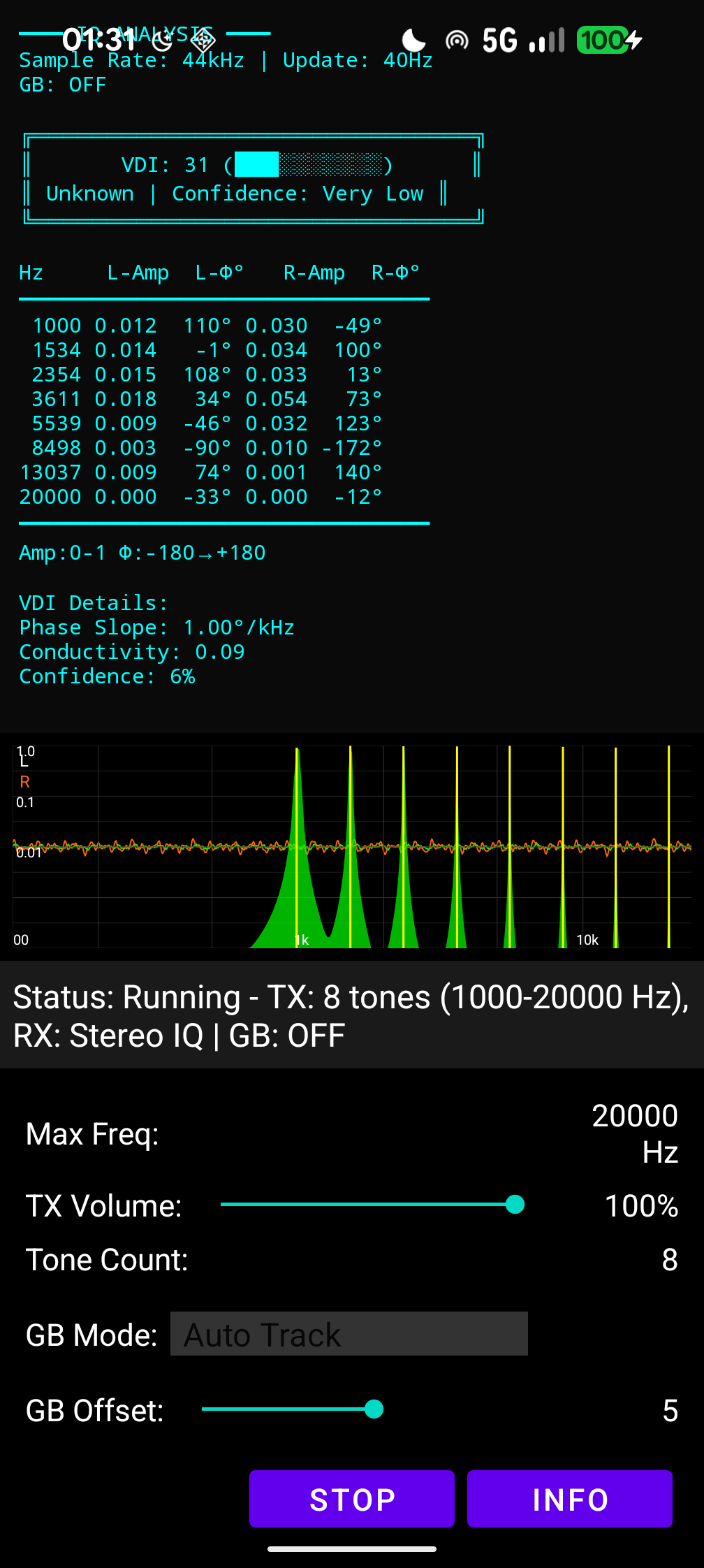

                              next we want the ground balance ... this is what the AI recomendation is :
                              > how is ground balance implemented?
                              ● Ground balance in metal detectors is a critical feature that cancels out signals from mineralized soil so you only detect actual metal targets. Here's how it's typically implemented:
                              Ground Balance Concepts
                              The Problem:
                              - Mineralized soil (iron oxide, salt, clay) responds to transmitted frequencies
                              - Creates a constant background signal that masks small targets
                              - Phase response of soil differs from metal targets
                              Ground Balance Solutions:
                              1. Manual Ground Balance
                              - User pumps coil over ground while adjusting a control
                              - System measures soil response and stores baseline
                              - Subtracts soil phase/amplitude from incoming signals
                              - Simple but requires user interaction
                              2. Automatic Ground Balance (Auto GB)
                              - System continuously monitors ground signal
                              - Uses slow-tracking filter to follow soil changes
                              - Fast changes = targets (detected)
                              - Slow changes = ground drift (tracked out)
                              - Implementation: IIR filter with very low alpha (0.001-0.0001)
                              3. Multi-Frequency Ground Balance (Best for your app)
                              Since you already have multi-frequency IQ analysis, this is ideal:
                              Key principle:
                              - Soil minerals have characteristic phase slope vs frequency
                              - Metal targets have different phase slope vs frequency
                              - By analyzing phase slope, you can discriminate soil from metal
                              Implementation approach:
                              // Ground balance would:
                              1. Capture baseline soil response (all frequencies)
                              - Store phase and amplitude for each frequency
                              2. Calculate soil phase slope
                              - This becomes the "ground balance point"
                              3. During detection:
                              - Subtract stored soil response from current signal
                              - Compare phase slopes:
                              - Similar to soil = reject
                              - Different from soil = detect
                              4. Tracking mode:
                              - Slowly update soil baseline using IIR filter
                              - Only when no significant targets present
                              Why it works:
                              - Ferrous soil: steep negative phase slope
                              - Salt/alkali: different phase characteristics
                              - Metal targets: phase slope different from soil
                              - VDI still works after soil cancellation
                              4. Phase-Based Ground Balance
                              Your current IQ demodulator already gives you the tools:
                              - Phase response for each frequency
                              - You could implement a "GB Point" control (0-99)
                              - Each point represents a phase angle to null out
                              - Signals at that phase get rejected/reduced
                              Implementation for FCMD
                              Would you like me to implement ground balance for your app? I could add:
                              1. Manual GB mode:
                              - "Pump & Set" button
                              - Captures soil baseline over several samples
                              - Stores for subtraction
                              2. Auto-tracking GB:
                              - Continuously adapts to soil changes
                              - Configurable tracking speed
                              3. GB offset control:
                              - Fine-tune balance point
                              - Useful for hunting in variable soil
                              The multi-frequency approach would integrate perfectly with your existing VDI system - both use phase analysis across frequencies.
                                .. so I told the AI to do it and this is the reply :
                                Perfect! I've successfully implemented all three ground balance modes for your FCMD metal detector app. Here's what was added:
                                Ground Balance Implementation Complete
                                1. GroundBalanceManager.kt - Core ground balance logic
                                Three modes implemented:
                                - OFF: No ground balance applied
                                - Manual: "Pump and set" - capture ground signal and subtract it
                                - Auto-Tracking: Continuously adapts to changing ground conditions
                                - Manual+Track: Start with manual GB, then auto-track from there
                                Key features:
                                - Ground baseline subtraction in I/Q domain for maximum accuracy
                                - GB Offset control (-50 to +50) for fine-tuning via phase rotation
                                - Auto-tracking freezes when strong target detected (amplitude > 0.3)
                                - Very slow IIR filter (0.05%) to follow ground drift without tracking out targets
                                - Averages L/R channels for robust baseline
                                - Integrated GroundBalanceManager into DSP pipeline
                                - Ground balance applied BEFORE VDI calculation
                                - Provides access to GB manager for UI control
                                3. MainActivity UI Controls
                                Added:
                                - GB Mode dropdown: Select OFF/Manual/Auto Track/Manual+Track
                                - PUMP button: For manual ground balance capture (toggles PUMP/SET)
                                - GB Offset slider: Fine-tune balance point (-50 to +50)
                                Smart behavior:
                                - PUMP button only enabled when running and in Manual/Manual+Track mode
                                - Offset control enabled whenever GB is not OFF
                                - Status displays current GB mode and state
                                4. Display Updates
                                - GB status shown in IQ analysis header
                                - GB status included in main status line
                                - Shows "FROZEN" indicator when auto-tracking is paused (strong target)
                                How to Use Each Mode:
                                Manual Ground Balance:
                                1. Select "Manual" mode
                                2. Press START
                                3. Hold coil over ground, press PUMP
                                4. Move coil up and down 3-4 times while "Pumping..."
                                5. Press SET button to lock in ground balance
                                6. Adjust GB Offset if needed to fine-tune
                                Auto-Tracking:
                                1. Select "Auto Track" mode
                                2. Press START
                                3. System automatically learns and tracks ground
                                4. Tracking freezes when strong targets detected
                                5. Use GB Offset to adjust if needed
                                Manual+Track:
                                1. Select "Manual+Track" mode
                                2. Do manual pump procedure first (gets initial baseline)
                                3. System then auto-tracks from that starting point
                                4. Best of both worlds!
                                GB Offset:
                                - Negative values: reduce response to low-phase targets
