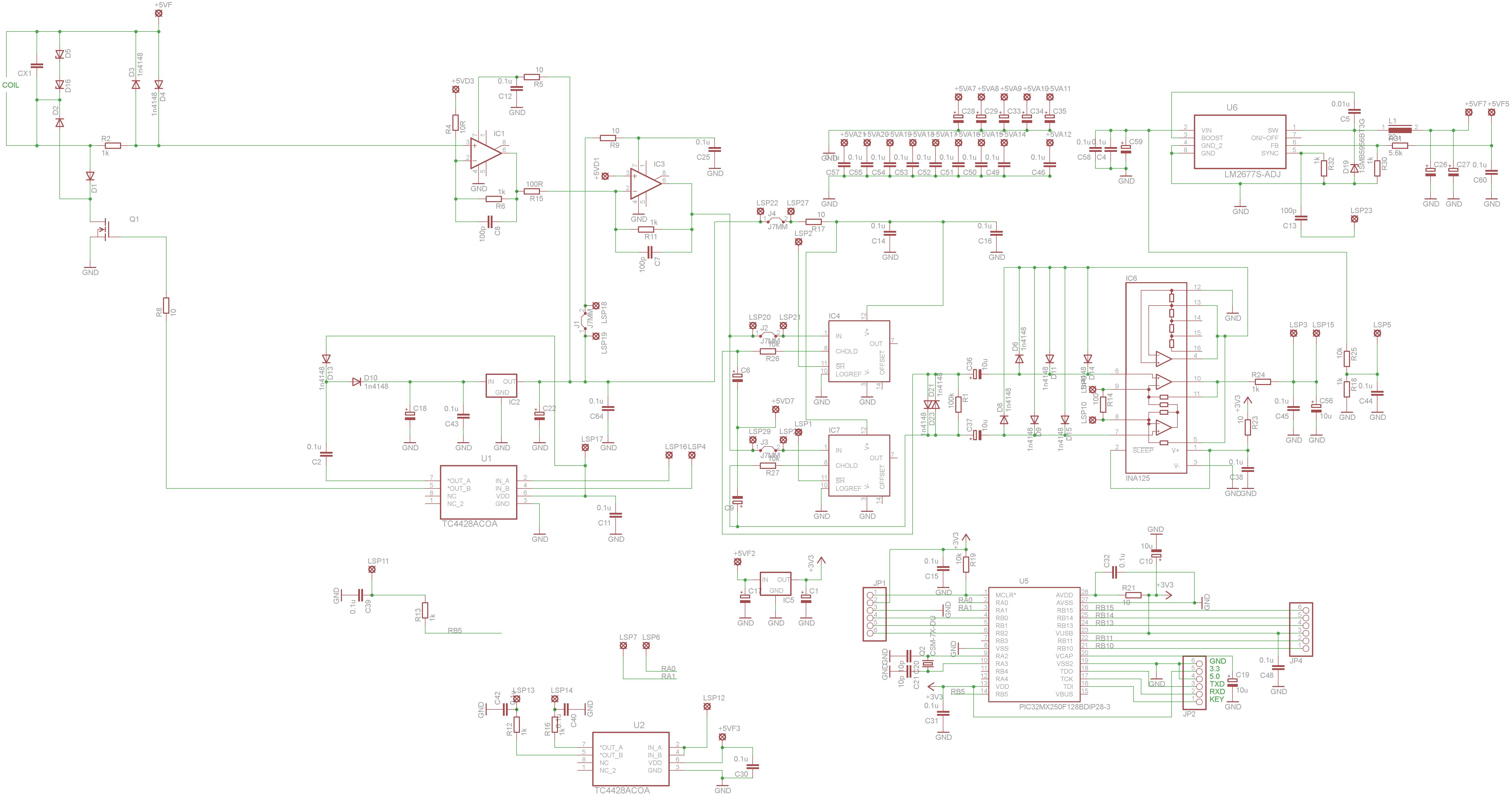

        Well here is a start to the documentation. The base model Moodz detector. The POPI .... "Plain old PI". DONT BUILD THIS - ITS JUST TO ILLUSTRATE THERE IS A CIRCUIT ... It works for me but I corrected some things. It makes a good test platform for testing various ideas etc.
        I will have some more time in the coming days to add more detail to a useful project build document.
        • #94

                Hi Moodz, is that part of the circuit correct ? How are you triggering Q1, normal PI gate control or TEM gate control ?
                • #98
                  No its not correct ... thats why I said dont build it :-) ... normal PI gate control.
                  • #99
                    Thanks.
                    Is the link between CX1 and D2 the problem ?
                    • ... I said dont build it ... the front end is a place holder .... I am converting the design into two parts. A backend with all the cpu power signal chain etc and a pluggable front end so front ends can be changed.( with the damping etc ) ... The cct above is in mid draw ... it has errors.
                      The build document will contain the build instructions.
