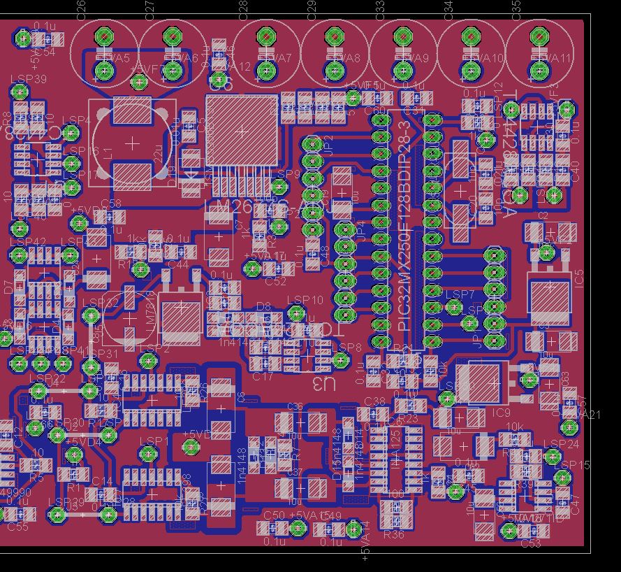

                I have been experimenting with an auto ground cancellation system ... but that is another story ... I have the "backend" completed ( this is all the power supplies, sampling, control, drivers etc ) .... see below.
                I just need to put an edge connector or something so that different front ends can be plugged on.
                See below ... This is the current board ... I have just snipped the front end off so you can see what the back end will look like.
                The board size is 8cm x 8cm ... all the parts are surface mount except for the micro so it can be replugged / upgraded etc.

                    Thank you for the update , board looks pretty compact, sorry I can't offer more technical comments, advice. Looking forward to see how the projects evolves.

                      Board looks good. Is it possible to get a little more contrast and/ or less overlap between the part nomenclatures? It is a bit hard to read. I like the use of multiple caps in parallel to lower ESR/ESL. Would there be any befenefit of adding a film cap in parallel with each bank to lower the high frequency impedance, or is this not necessary?

                            No .. not at all ... I was not satisfied with the ground balance system and as a secondary consideration the TX pulse efficiency. A novel ground cancellation system is being tested and the TX efficiency is also working ( its about 90% efficient in air ... drops about 5% in mineralised ground ). Once the testing is done I will roll out another board layout.
