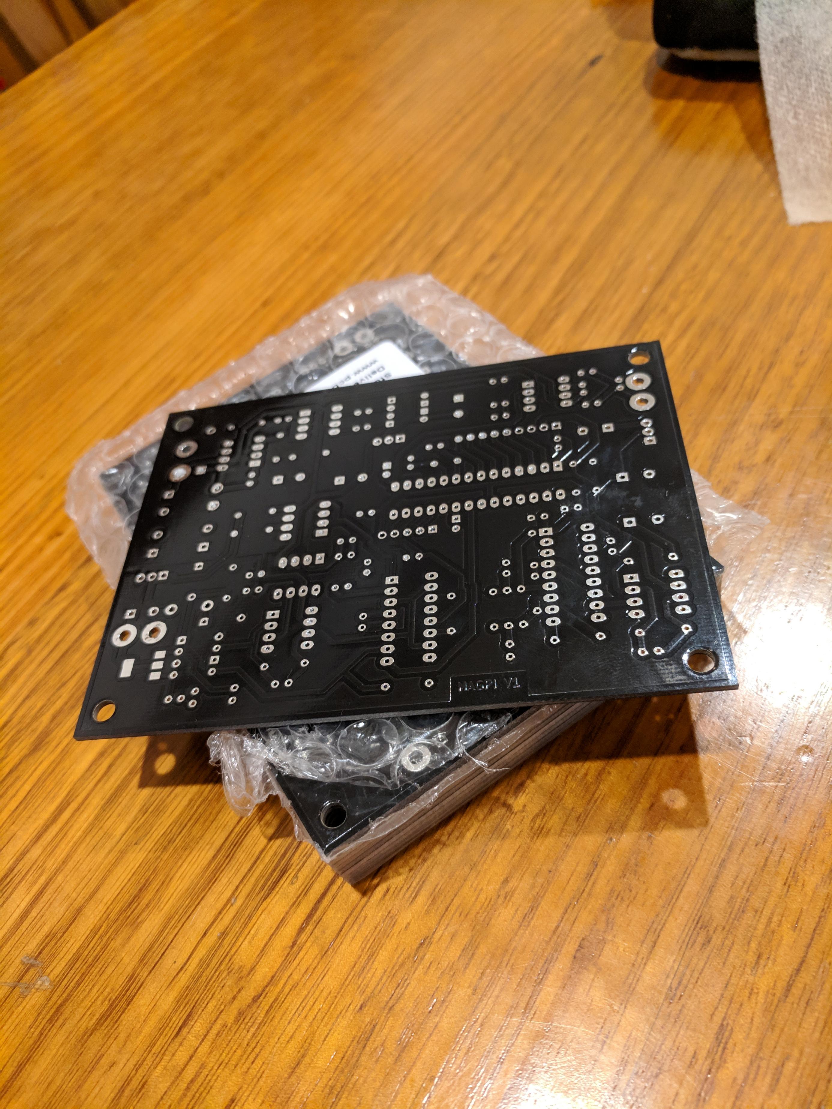

    SURF PI type detector updated using CPU and through hole components for easy construction.

    What is your plan? To sell PCB along with pre-programed micro?
      my patents on noise cancellation and active damping ( preamp area ) are not in this design.
      ... this version has just a surf pi style front end .... I always wanted a through hole PCB surfpi with CPU control.
      So at the moment it is an open design. ( PI and SOURCE ) Click image for larger version

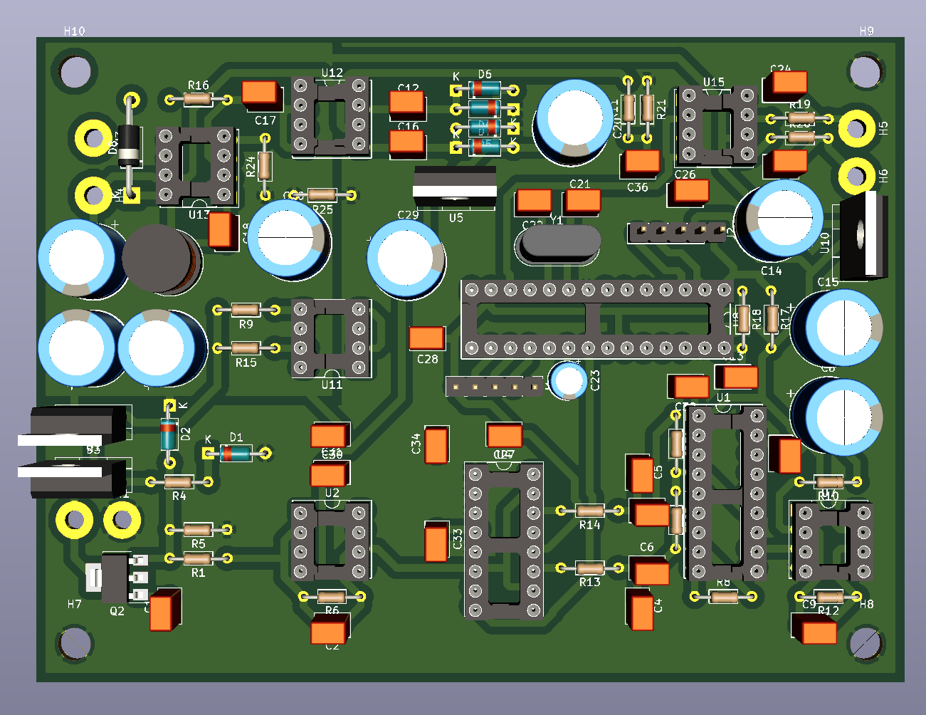

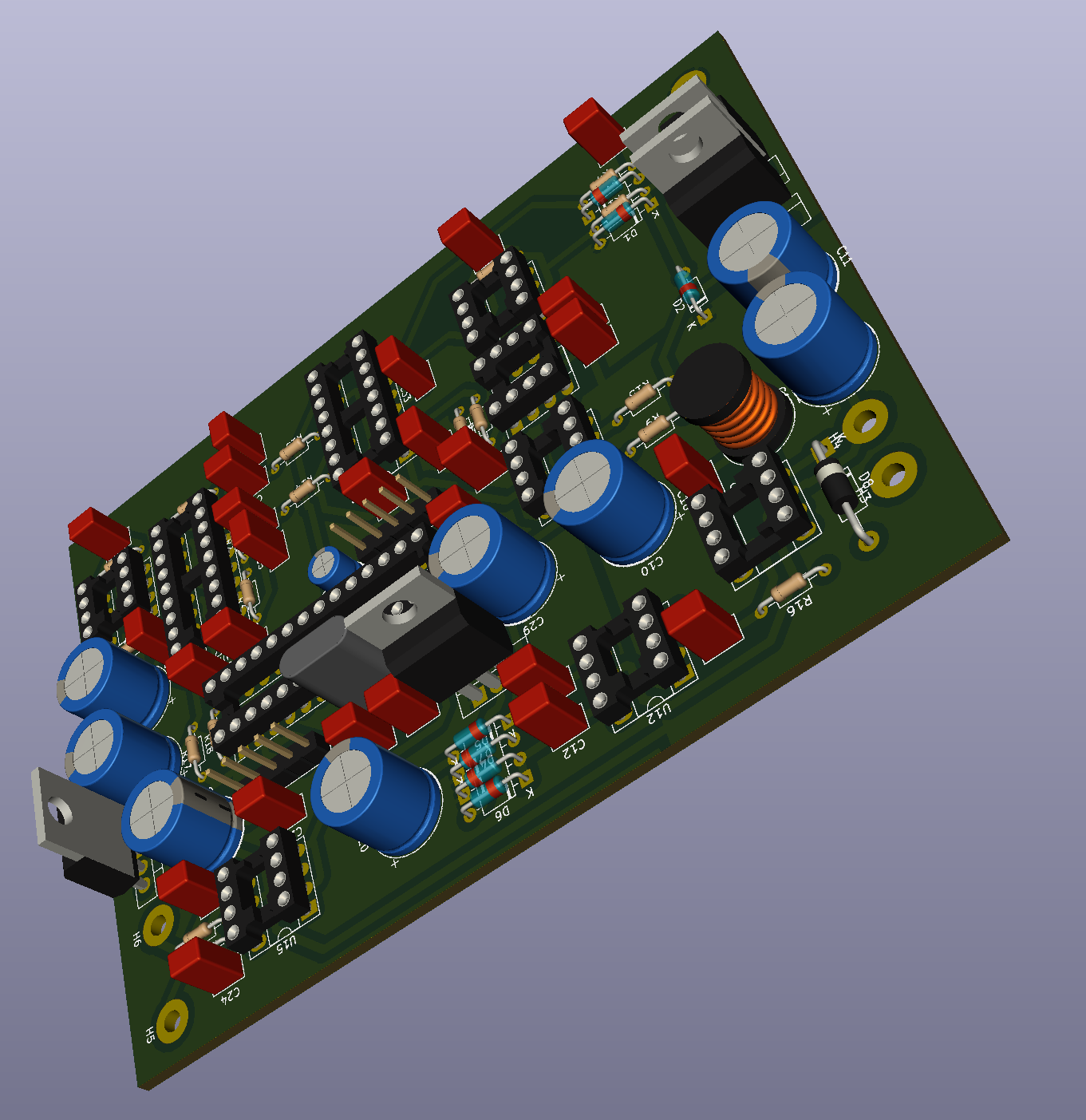

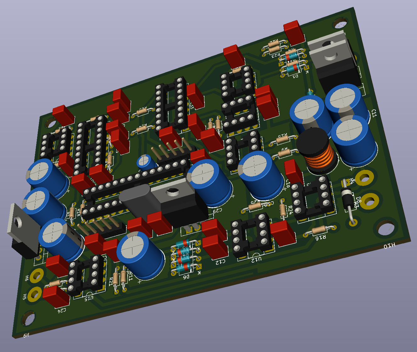

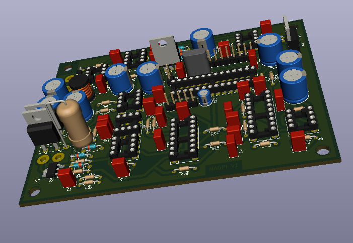

                          Updated the board with mounting holes ... added the noise cancelling and autodamping ( still supports regular damping ) and pin header for more IO like anlog pots, digital pots , LCD etc.

                              [ATTACH]44750[/ATTACH][ATTACH]44751[/ATTACH]
