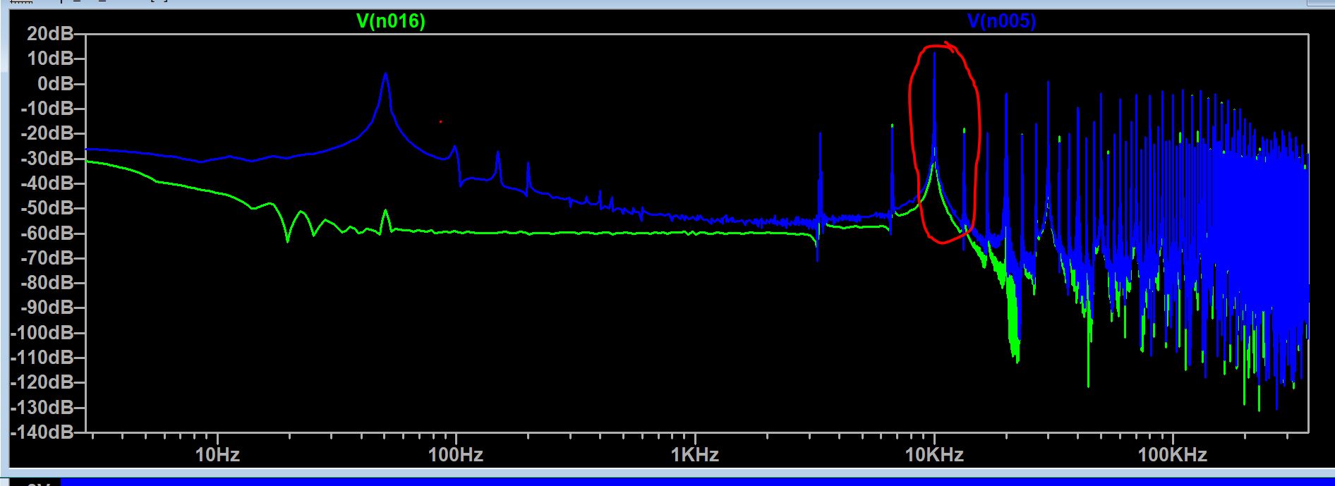

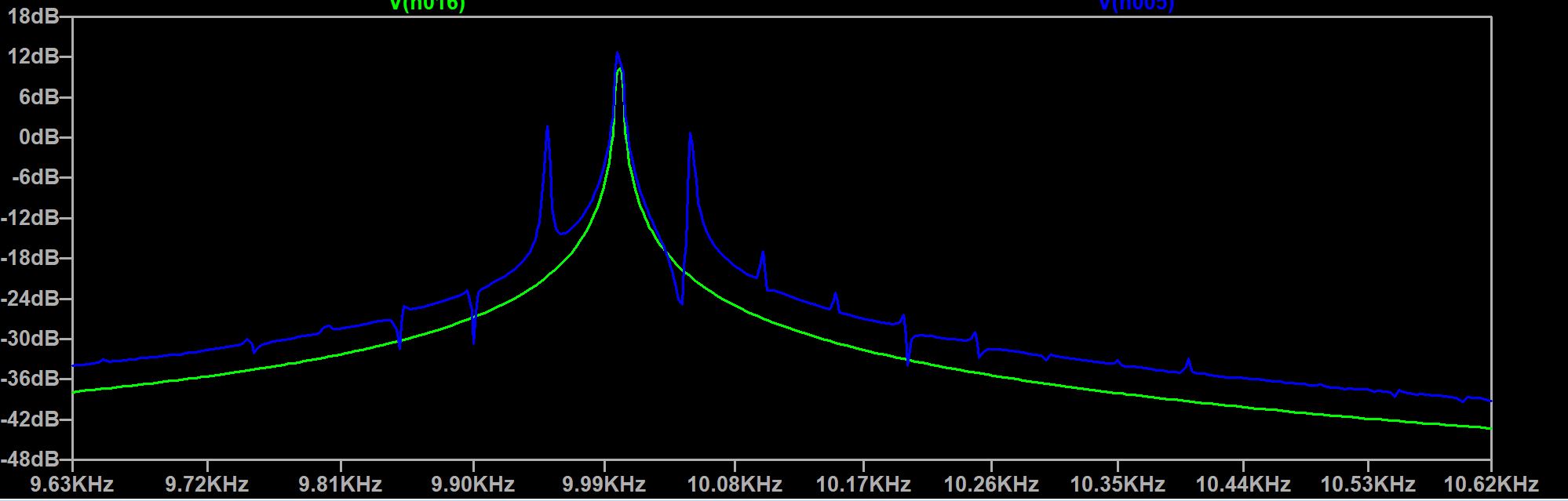

                            Below is the root of the modulation problem ....
                            A 50 hertz magnetic hum is present in the vicinity of the coil in the spectrum plots shown below ( blue traces ). The signal is measured at the o/p of the preamp. The 50 hertz primary can be easily removed with a pass filter or even fancy dsp .... the 50 hertz modulation present on the spectrum representing the target signal ( starting at 10 khz in this instance ) cannot be so easily removed. The green trace is the same signal but with TX sampling enabled ... no Hum, No EF , No noise ....no modulation.
                            I have used 50 hertz here to illustrate the problem ... however any low frequency noise including EF will be modulated onto the target spectrum.
