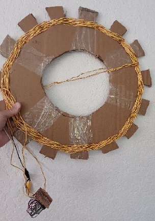

Building from Scratch Test Results
    Tried Alternate Diff Coil (looks Striped - I call it my Tiger Coil) :
    1: 60 foot length : Looped 1 Transmit 1mm wire , Looped 16 Receive 0.2mm Wires (total receive wire = 900ft).
    2. Twisted all Wires at 1inch Intervals - 720 Twists with Drill.
    3: Looped 15 times around 15inch Spoked Template.
    4: Reconnected Receive wires in End-back-to-Start of next wire - like the Transmit-Receive wires.
    -- Theory: - more Receive Winds will Multiply return Voltage.
    Tested:
    - Connected in place of old Diff-Transmit-Receive Coil
    . . - ( Deffinately check that it is connected to circuitry correctly, Transmit Wattage will probably fry the receive wires if hooked up backwards ! )
    => Mixed Results - bigger Wave - very solid and clear , seemed to still shift with Targets.
    => Worked sometimes - unsure why yet (was late night - had limited time & concentration) - will try again when have more time.
