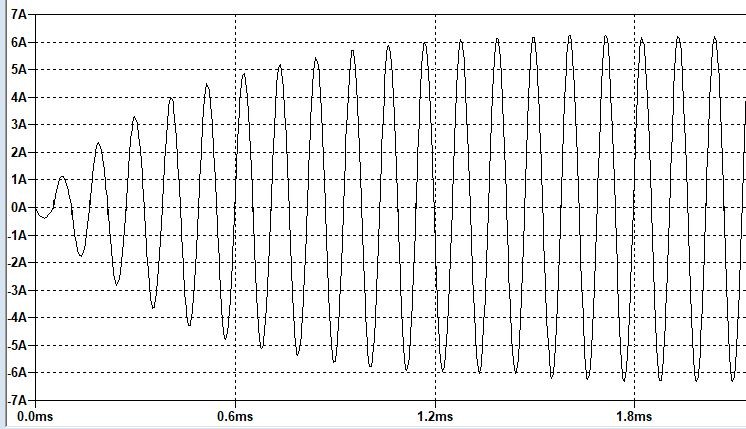

        This is something I played with extensively at White's. You can also do multifrequency half-sine:
        This requires a little more complicated TX circuit. I had this working on the bench.
          So during the first quarter TX sine wave negative eddy currents are induced in the target. Then, during the second quarter TX sinewave, the negative eddy currents in the target are cancelled (or subtracted) and then new positive eddy currents are induced in the target.
          During the "listening period" of zero current, the remaining eddy currents decay and can be sampled.
          The advantage seems to be a different response for certain targets according the TC`s of the target, possibly enhancing or diminishing part of the response of targets that have 2 TC`s or multiple TC`s.
            You can initially think of the target response as exactly the same as a continuous sinusoidal VLF response, only truncated at half-sine intervals. But this ignores the exponential start-up inertia of the eddies, so that gets superimposed on the steady-state response. The inertia exponential is most prevalent for high conductors, less so for low conductors.

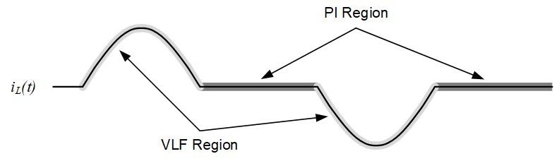

            Obviously with half-sine you want to run an IB coil and look at the response during TX as well as after. This gives you a true hybrid:
            You do bring up an interesting point, as to whether the inertial part of the response might allow us to distinguish a single-domain target (like a coin) from a multi-domain target (like a pulltab). I never got that far with my research.
              The response during the TX half-sine on time is REALLY interesting!

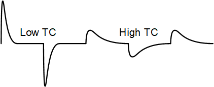

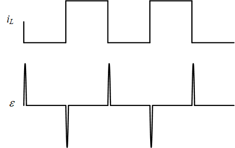

                              I'm getting confused over which system you're describing. Here are the TX current & target EMF for CCPI:
                              Click image for larger version  Name:	CCPI.png Views:	0 Size:	4.3 KB ID:	408181
                              The target EMF comprises short impulses that will depend on how the kick-start is done but will usually be close to half-sine voltages. Because they are rapid the target eddies have little time to build up so the eddy responses are likely close to a t*e-t/τ. A low TC target will get a higher initial eddy current but decays faster, while a high TC target will decay slower but with a much lower peak.
                              Click image for larger version  Name:	CCPI_Resp.png Views:	0 Size:	6.6 KB ID:	408185

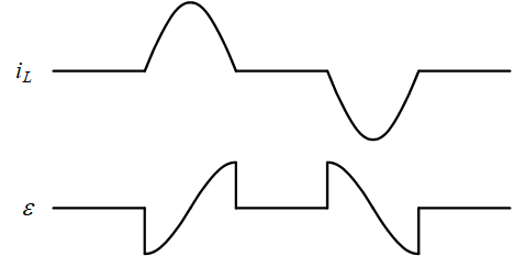

                              The half sine TX and target EMF look like this:
                              Click image for larger version  Name:	Halfsine.png Views:	0 Size:	7.5 KB ID:	408183

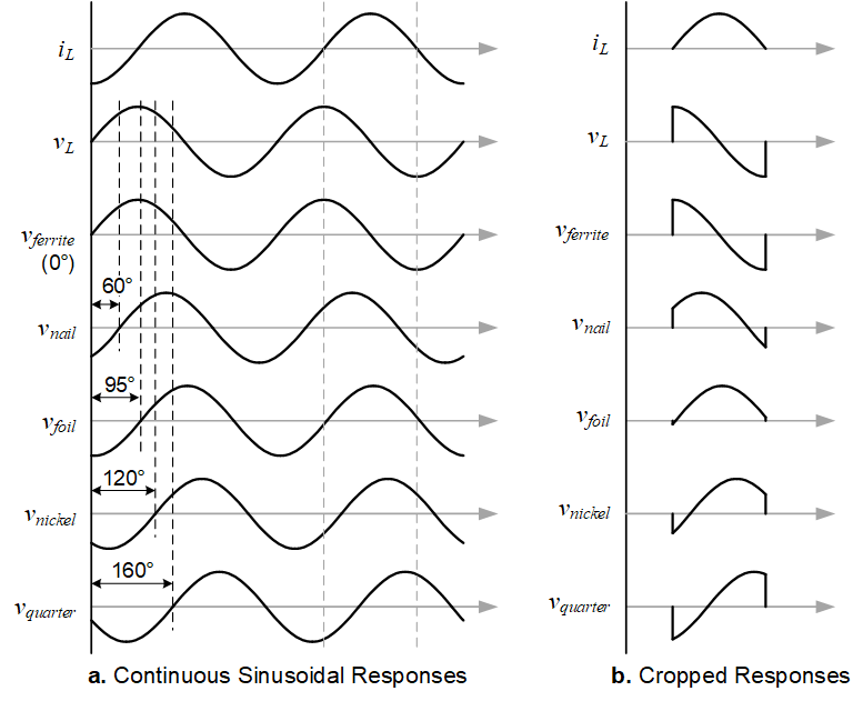

                              To imagine the target responses start with a continuous sinusoidal response and simply truncate it. Here is a set of plots for some targets at 10kHz. The gray dashed lines exactly frame a half-sine of the current, and the plots to the right are all the responses cropped to these lines.

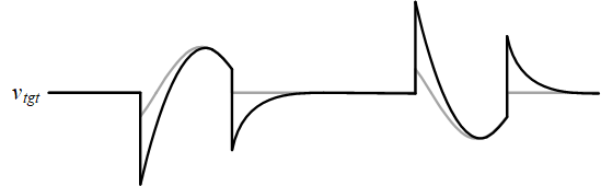

                              But this does not account for the exponential turn-on (or turn-off) inertia caused by the tau of the target. Suppose we take the US nickel; its tau is ~10us which means that its 5*tau settling is about the same as the half-sine pulse width of 50us, assuming a half-sine "frequency" of 10kHz. The total response looks like this (ideal truncated in gray):
                              Click image for larger version  Name:	HS_Real.png Views:	0 Size:	9.1 KB ID:	408182
                              It is still very much a VLF-ish response during the TX time (from which you can literally extract a target phase), and you also get a separate PI response during the off time.
                              Both approaches give very interesting but very different results.
