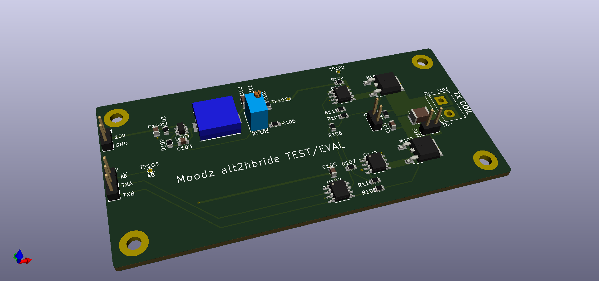

BIPOLAR ALTERNATIVE TO H BRIDGE - GENERATING SINE WAVEFORMS - HALF / SINGLE & FULL
    I just upgraded the schematic and gerbers to make it easier to accommodate Half-Sine operation. My original board was mainly focused on CC operation. Added the half sine coil capacitor and damping network to the board along with 2 jumpers to allow switching between HS or CC mode. For HS operation shunt J104 and remove shunt from J!05... For CC operation, remove shunt from J104 and shunt J105.
    I just ordered a set of 5 boards from JLCPCB for $3.33 (would have been $2.00, but I opted for lead-free HASL) plus a $3.93 shipping charge.
    TX.pdf
    Moodz_TX(HS)_Gerbers(1-13-2023).zip
      Bom for the Moodz_TX(HS):
      TX_BOM.pdf

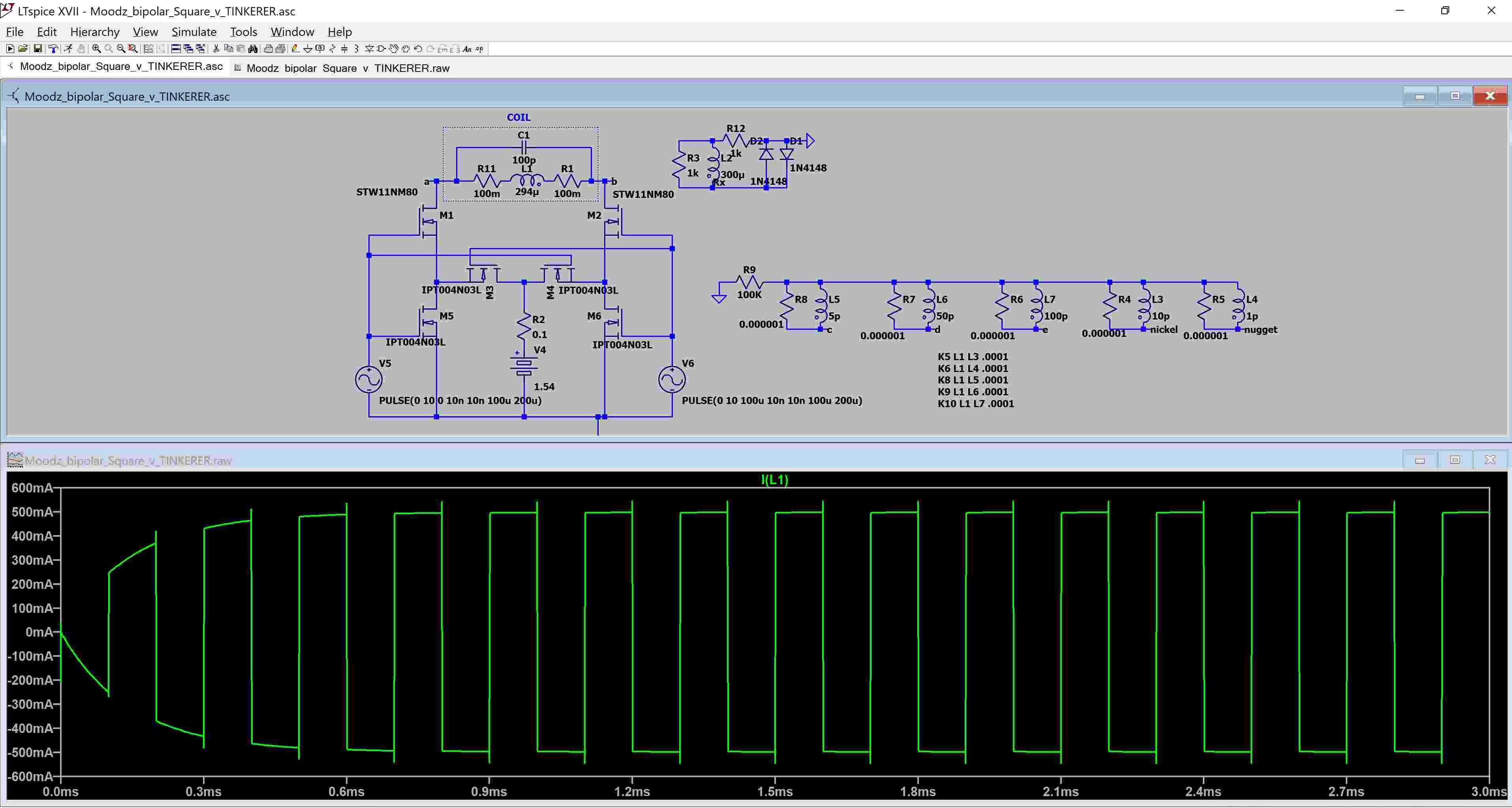

        My explanations are probably not very clear, but I think the subject is important enough to be worthy of detailed description and full understanding for anybody wanting to be involved in metal detector design. In my case, I am mostly interested in bipolar, square wave, continuous current PI. Therefore I will make another try, including simulations, to explain how I think this type of TX works and how it affects the targets and the receive circuit.
        Probably the best way is a discussion. This will help to clarify and if needed to point out any possible mistakes in my thinking.
          Here is a simulation of Moodz's excellent Square current wave TX.
          Next we will look at the details and the induced currents in the targets.
          If anybody has questions about the simulation, please ask.

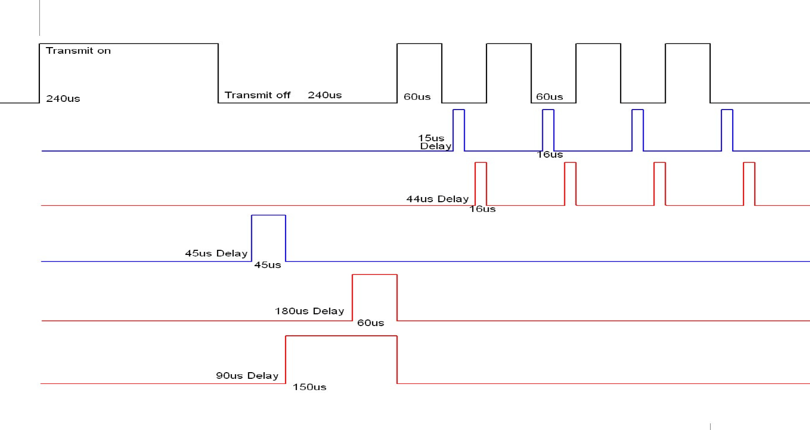

            From what I have been reading in this thread my understanding is that the EMF caused by the coil charge ramp current actually influences the target response sensitivity. Referring to the SD2000 timing below of 240us it appears that they are attempting to chrage up the coil as slowly as possible to minimise this effect would you agree..? So the approach should be to apply a low noise current source to control the rate of coil charge current in order to minimise the negative target offset influence. Or am I completely wrong in that a shorter ramp up would be less likely to create a negative influence on the target response..?
              Click image for larger version  Name:	image.png Views:	0 Size:	95.2 KB ID:	408301​
              The eddies in the target are proportional to the derivative of the Tx current, therefore a linear ramp causes a constant offset eddy current in tge target. The signal at the Rx (assuming a balanced coil) would be the derivative of the target eddy currents, therefore the constant eddy causes zero offset in the Rx coil.
              With a properly balanced Rx coil the Tx ramp should have little to no effect. I believe extreme efforts to minimize the ramp won't pay off, better to spend the energy in balancing the coil.

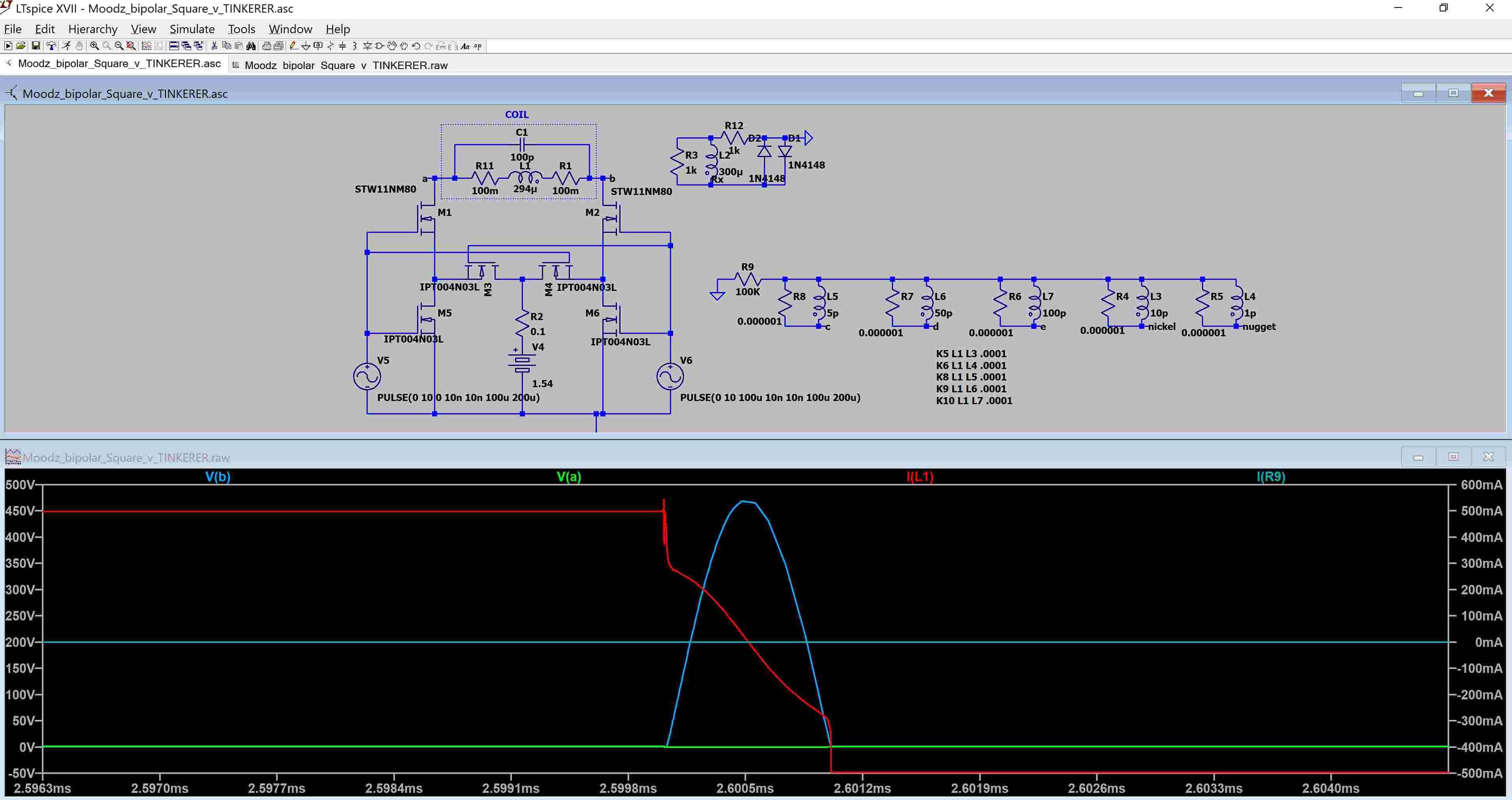

                  Click image for larger version  Name:	SWITCHING.jpg Views:	0 Size:	485.0 KB ID:	408310Here we see the switching.
                  The red trace is the current in L1
                  The blue trace is the voltage in C1
                  The current starts with about +500mA. When the Mosfet is switched off, the coil L1, discharges into the capacitor C1.
                  When the current in L1 reaches 0A, the Voltage in C1 is at its peak.
                  The capacitor C1 immediately discharges into the coil in the opposite direction.
                  The capacitor C1, (blue trace) is discharged when the coil current reaches about -500mA
                  In the next session we will look at the eddy currents in the different targets.

                        Hi Tinkerer,
                        Thank you for sharing your circuit. Just wondering how you are connecting in the different coil + snubber options which you have labelled with gold and nickel for example..? I gather these are different RX coil options which you are simulating is that correct..?
