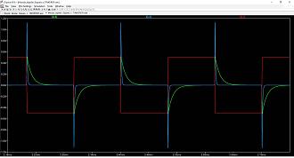

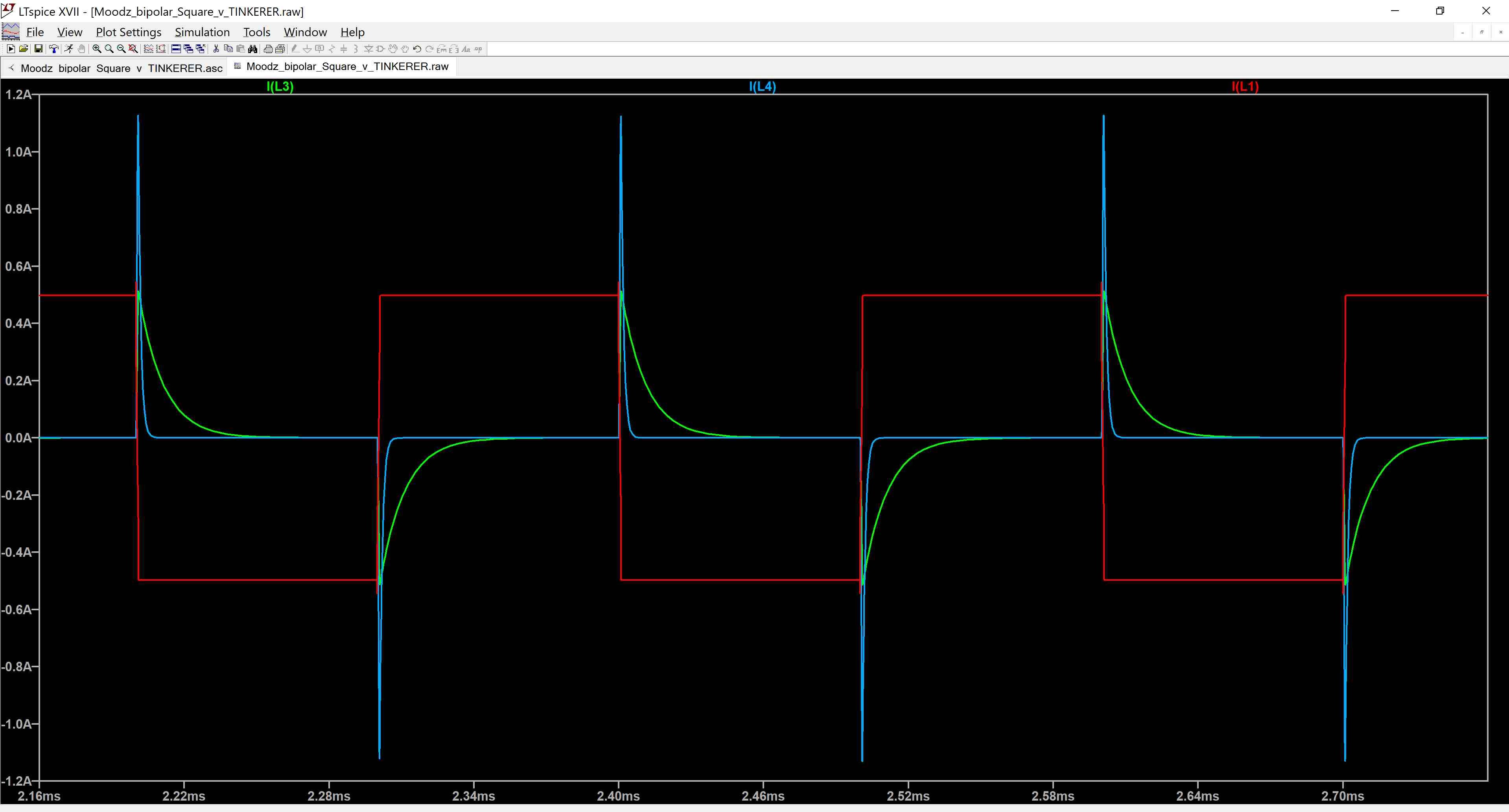

      L2 is the RX coil is its simplest form, concentric about half the diameter of the TX coil
      R3 is the damping of the RX coil
      R12 limits the current to the input of the preamp
      D1,D2, protect the input of the preamp
      L3,L4,L5,L6,L7, represent targets with TC's from Ius to 100us.
      A nickel, (US$ 0.05) is a common target with a TC of 10us
      A very small gold nugget could have a TC of 1us
      The (transformer) coupling of the TX coil L1 with the targets is exaggerated to make it easier to see.
      The picture shows the current wave form of L1 in red
      The eddy currents in the targets L3,L4 in green and blue​

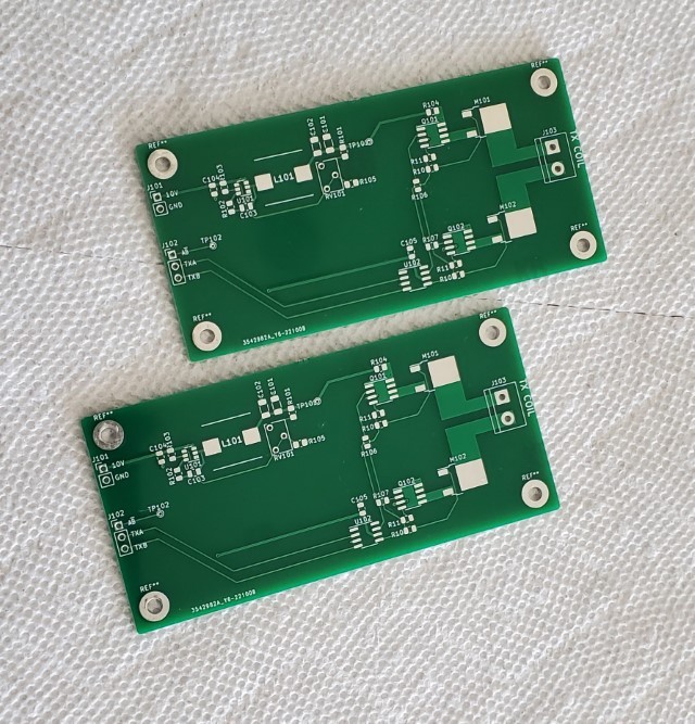

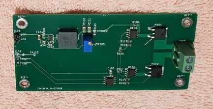

        I have been playing with the Moodz Alt2H-Bridge for a while now. The PCB that I am using uses SMD components (except for the coil connector and a 100K KEMET potentiometer). If anyone is interested, I am posting the schematic and gerbers...
        If anyone is interested, I have 2 extra bare PCB's of the original Moodz alt2h-bridge that I have been using for about 4 months. This version does not have the half-sign capacitor or damping network on board... have to add externally for experimenting with half-sign.

        After the PCB is populated:

                      As I am looking closer at the Moodz circuit, I find it very interesting and suspect it might be even better than my own bipolar square current design. I would like to buy your boards. Can I pay with Paypal?
                      • #41
                        Tinkerer, The boards are offered for free... just need to take care of shipping cost. For most shipping destinations outside the US, it may be much cheaper to order directly from JLCPCB (5 boards for $2 - $3.33 plus their shipping). US shipping internationally is expensive. I can get something from Hong Kong and have it shipped for as little as $3.93... but to send the same thing to Hong Kong it costs 10 times that. Must be missing something!!
                        If you order from JLCPCB, I recommend to use the gerbers in post #16 of this thread.

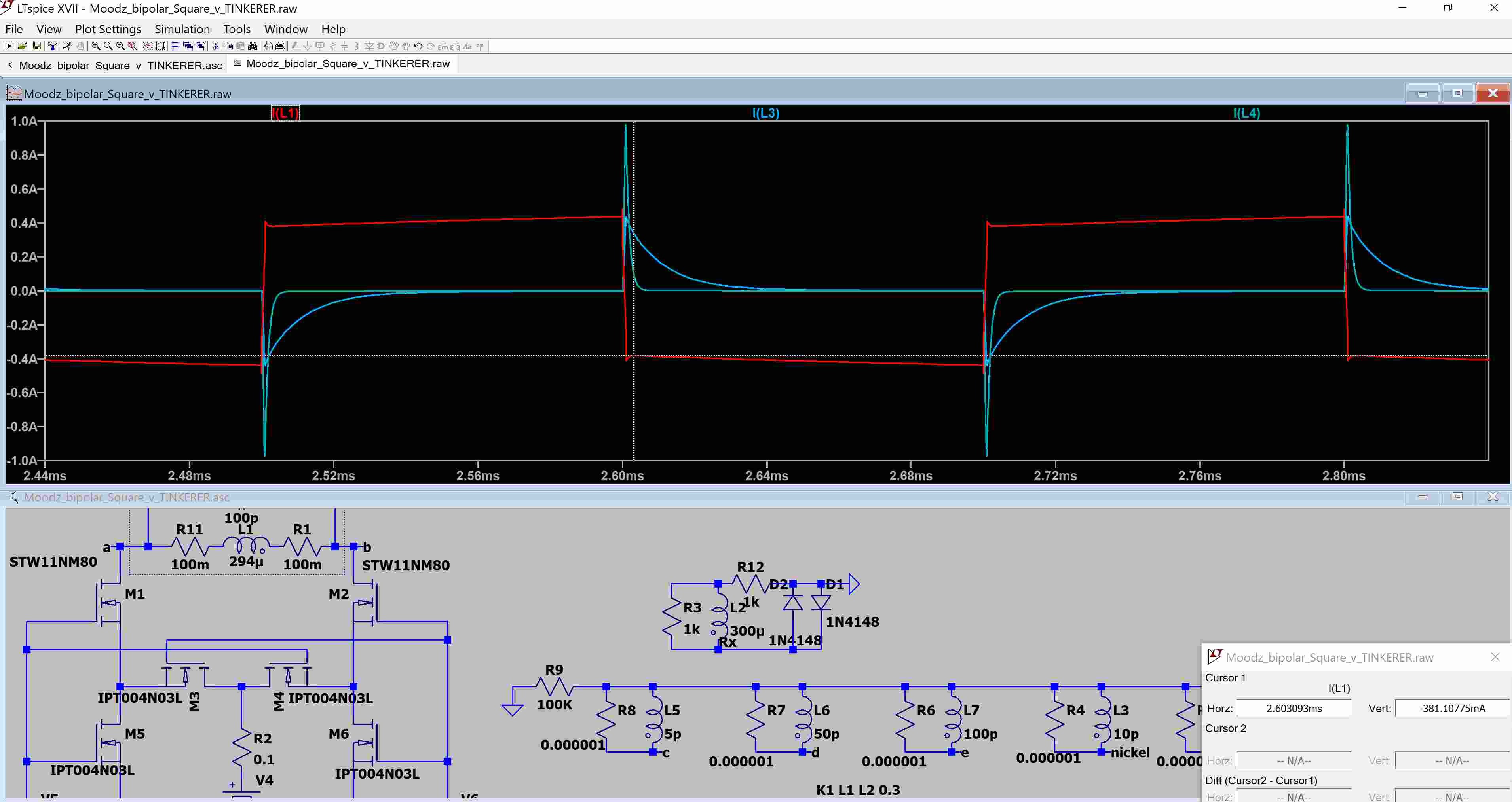

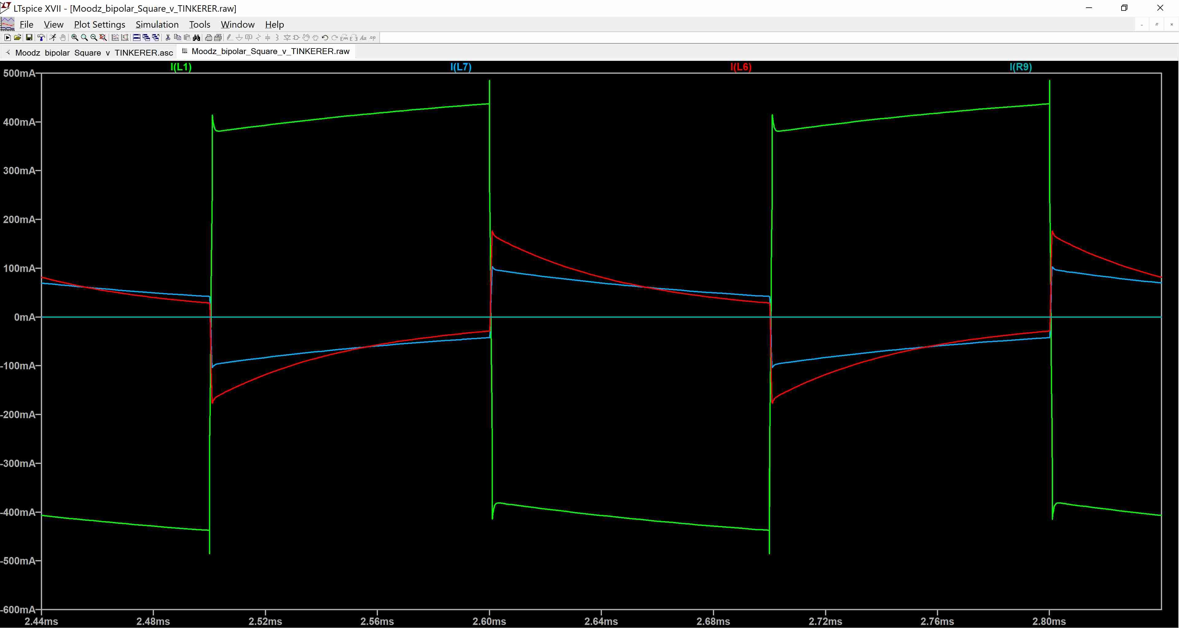

                            So what happened here?
                            We see a distinctive slope in the TX that is not there on the last picture. In the last picture the RX was not coupled (K1 L1 L2 0.3). Now that the TX and RX coils are coupled, the slope in the TX appears. This shows us that the energy absorbed by the RX coil and the damping of the RX coil cause the slope in the TX coil current.
                            As the energy is lost during the Flyback, the coil current increases to return to the constant current level.
                            Next I will try to show the problem with the ground. Does anybody have a good suggestion how to simulate the ground? I have never done it yet, but I will try to find a solution unless somebody is willing to help?
                              As the energy is lost during the Flyback, the coil current increases to return to the constant current level...
                              Tinkerer, Not sure as I cannot see the complete circuit, but I suspect it at least partially due to your TX/RX relationship and coupling? If you are trying to simulate a concentric RX coupling, you seem to be missing the bucking coil in the TX circuit which would oppose the primary TX/RX coil coupling. I have found that trying to simulate a concentric coil and target arrangement in LtSpice is extremely difficult as it tends to generate an error about an impossible transformer configuration.

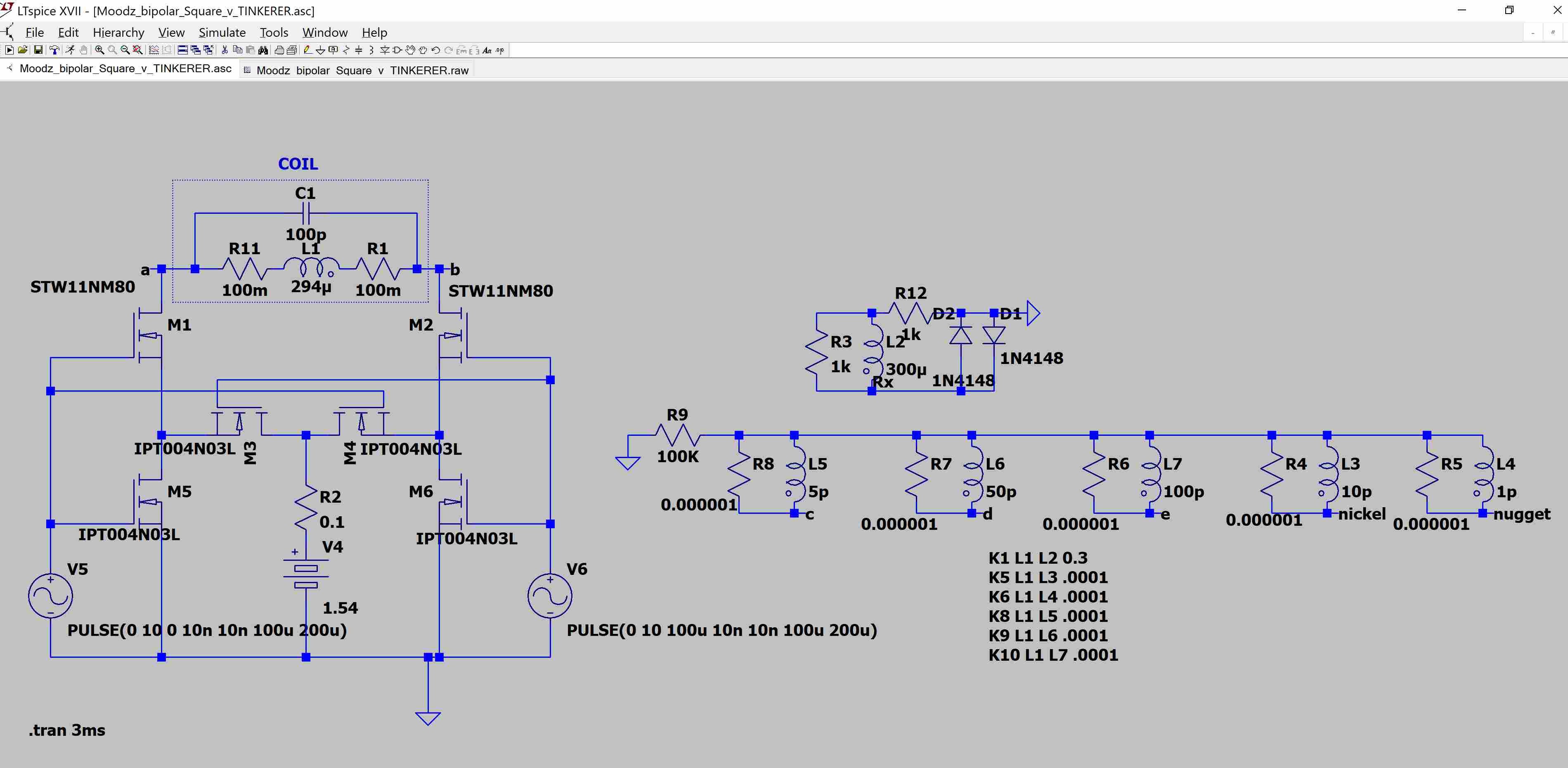

                                Click image for larger version  Name:	Moodz_bipolar_Square_v_Tinkerer_ct.jpg Views:	0 Size:	399.5 KB ID:	408492 This is the full circuit.
                                In this simulation I do not use an induction balanced RX. Just a separate concentric RX coil of about half the diameter of the TX coil.
                                Moodz_bipolar_Square_v_TINKERER.rar Click image for larger version  Name:	TX_slope_longTC.jpg Views:	0 Size:	395.2 KB ID:	408494In the simulation we see the slope of the TX square wave current (green) and one target with a TC of 50us, (red) and a target with a TC of 100us (blue). We see that the target do not fully decay during the 100us cycle time, therefore the remaining eddy currents subtract from the amplitude of the eddy currents of the next cycle.
                                To get more amplitude we should extend the cycle to 2 target TC's.
                                It is also obvious that a compensation circuit is needed to reduce the slope of the TX current.
                                I am still working on a simulation of the ground.
