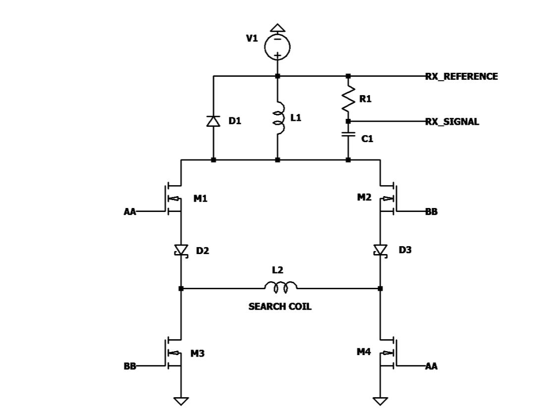

    • Originally posted by pito View Post
      and no patent Click image for larger version
      Interesting ... though this is a different circuit and I cant see how you receive anything.
      • short circuit the capacitor
          If you short the cap the coil is still terminated by low impedances at both ends by the bridge so there is still no target detection.

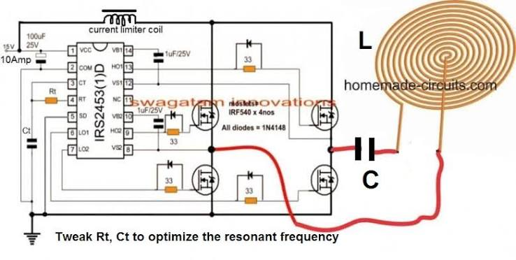

          However I can see you have advanced skills in cutting and pasting random off topic images from the internet. :rotfl
ID:	450864 and how you do here ?​
