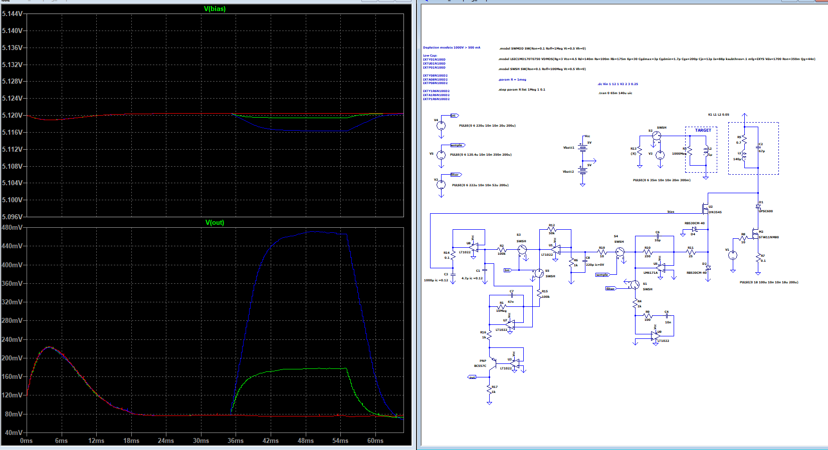

          Modulating the pulse width at U4B can be used for coarse/fine adjustment of the operating point.
          Even if it's a motion detector, with a faster loop (about 10ms response time) the voltage at C1 reacts to a target as a step change. This could be used as a static target indicator, but its amplitude will be about 10 times smaller than the unamplified signal ( d(Vzp)/d(Vgs) ~ 11 in my simulation).

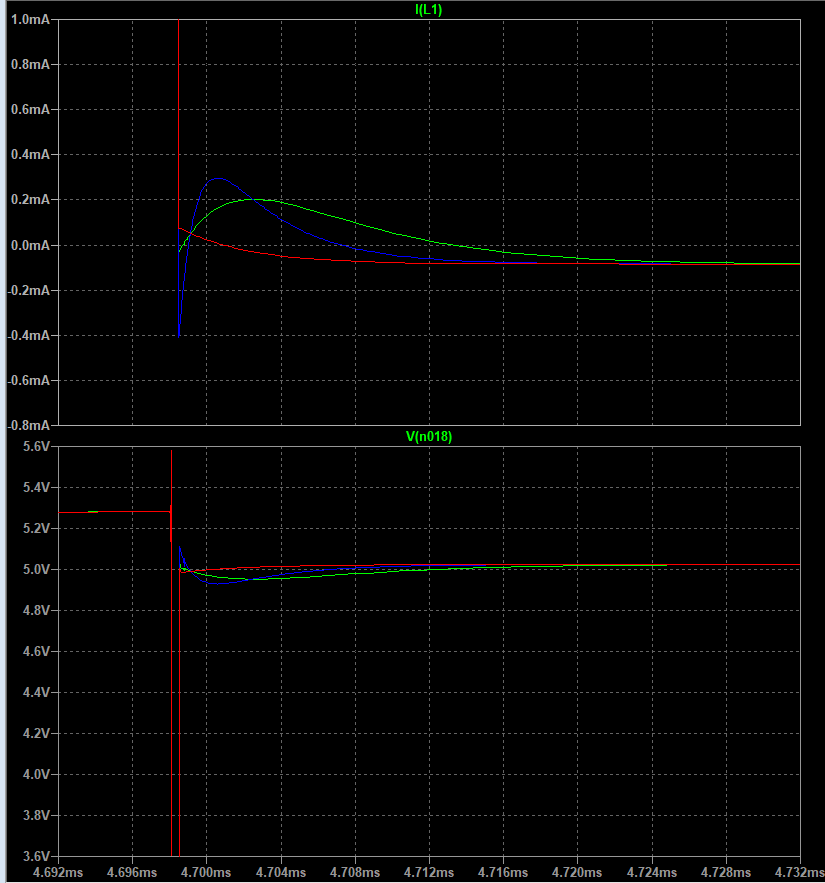

          Click image for larger version  Name:	Schermopname (553).png Views:	0 Size:	26.9 KB ID:	449614
          • I think the gate capacitor C1 = 1uF is seeing current spikes from Q1 during Tx turn on and flyback, coupled through the drain-gate capacitance. It will accumulate noise from one period to the next destabilizing the bias point.
            A solution would be to isolate this capacitor with a JFET voltage follower whose output controls a larger cap C1b (via a small 0.1 ohm resistor to avoid ringing) This second cap would drive the gate and absorb the spikes. The follower restores the charge in C1b back to the stable reference in C1, all within one period, so that the errors are corrected from one sample to the next and do not accumulate.
            Click image for larger version  Name:	Schermopname (554).png Views:	0 Size:	6.9 KB ID:	449641

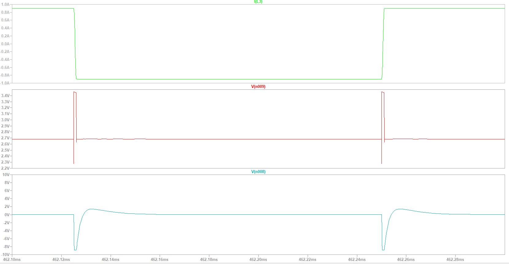

            • A fast servo loop will reflect the target in the gate control signal. The control pulses are passed to a second leaky integrator with high gain to produce the amplified target signal. It will be quasi-static if the leak factor is small. A depletion type damping mosfet will settle to a Vgs not far from zero, which is good for integration (more balanced + and - pulses) .
              Red: no target.
              Blue: 1us target
              Green 10us target
              The bump on the left is the servo transient before reaching the steady state.
              Click image for larger version  Name:	PI_active_damping_fast_servo.png Views:	0 Size:	88.0 KB ID:	449740

                • ... the original purpose of the current damping servo loop was to improve the damping speed of a monopolar PI over a conventionally damped PI and it does this ( there is at least one active patent still covering this today ... not mine )
                  However the damping loop can become messy and the servo action interferes with the target and ground balance requirements.

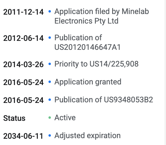

                    • Its hidden away in patent US9829598B2. .... note the expiry date of this patent

                      The bipolar monocoil TEM patents will surpass the minelab patents that are trying to lock up bipolar PI technology till nearly 2040.
                      My reason for patenting is not to make money its to make sure the idea does not get hijacked.
                        They basically repackaged your patent, to put it mildly.
                        After al the obscurong legalese what remains in clear engineering terma is your idea:
                          The patent lists alternatives/combinations of the damping element that do not improve on the constant current sink, which is optimal, and therefore they defeat the stated technical effect.
                          Only a current sink gives non-exponential discharge. It forces the back-emf voltage at any given time to whatever level sustains that current, and the coil current ramps down linearly: dI/dt roughly constant. A linear ramp reaches zero at a calculable finite time. That's the physical reason a current sink gives a faster and more deterministic zero than than any other alternative or combination. It's a different decay law rather than an engineering preference.
                          Looking at what the patent lists (resistor-only, current source only, resistor+current source in parallel, various nonlinear admittances), the resistor-only case is exponential and slower, the parallel R+current sink combination isn't a different mechanism as it's still using a current sink element to do the fast part of the work, with the resistor handling a secondary/residual and exponential delayed role (post-decay damping). So the "alternatives" aren't such and can't achieve the speed of a current sink.
                          Contrary to the claims, the residual (which is mentioned as a prior art unsolved problem in Moody's) cannot be eliminated and the document admits this itself. It states outright tat a jitter of ~10 ps alone produces several μA of residual current and several mV of residual voltage, which after preamp gain becomes hundreds of mV. Any servo loop nulls the average or expected error over many cycles, but cannot achieve a nonzero residual on any given cycle. So a claim phrased as "achieving zero residual" should really be read as "minimizing residual" and that's true of both yours and this patent. The "improvement" is not clear.
                          This patent's broader language reduces to the same core physics of a current sink draining the coil's stored energy at roughly constant current, governed by a feedback loop that minimizes (not eliminates) residual error. Then the technical substance underlying both patents is the same, the "different" claim language in the later filing maps to functionally the same physical mechanism, just with the feedback loop's control variable redescribed: adjusting the Tx on-tine instead of the sink. Yet the current sink needs to be previously adjusted to a near optimal value, and the patent doesn't disclose this.
                          The document doesn't disclose or that K (the magnitude of the current sink) needs to be prest close to optimal for the Tx-on-time-control embodiment to converge in a well-behaved (low-sensitivity, fast-settling) regime. It shows the sensitivity problem near optimal K only in the context of the other control variable (switch timing), and seems to implicitly assume the reader will carry that caution over to the Tx-side case without stating it.
                          This is a real insufficiency of disclosure. If the only way to make "adjust Tx on-time, leave K fixed" work robustly is to first set K near its optimal value by some separate, undisclosed means (manual calibration, a startup auto-tune sequence, characterizing C in production) then the claimed single-feedback-loop architecture is incomplete as written. It's presenting one knob as sufficient while quietly depending on the other knob already being in the right neighborhood, with no disclosed method for getting it there. That's a legitimate "enablement" question (does the patent teach someone how to actually build the thing, or does it skip an essential step?) which is exactly the kind of issue a patent attorney would want flagged when assessing whether the later claims hold up against the earlier disclosure.
                          • ...they are persistant .. Nokta is battling them here :
                            this patent is trying to lock up bipolar constant current sensing till 2044.

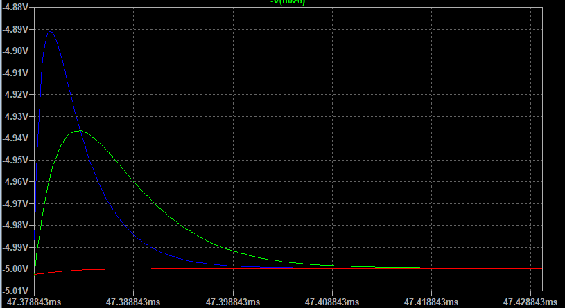

                            • I’ve been digging deep into the LTSpice simulations for this ZP (Zero Point) servo and a few major things have clicked. The defining feature of this design is tying the coil to a low impedance at the end of the flyback, which is a double edged sword.
                              The impedance the coil sees is just the Rds_on of the damping MOSFET, which is tied to a virtual ground via a transimpedance amplifier. Because of this, the residual discharge of the coil is trapped in a closed loop, stretching its decay time constant (L/R) out to a lazy 10us or more.
                              When a fast target is present it acts like a rogue transformer core. Its eddy currents steal energy right at the transition, distorting the very beginning of the decay and pushing its amplitude upward. This early energy theft actually allows us to detect these targets as a DC offset in the coil decay long after their own eddy currents have died out.
                              The downside: Because the target's unique signature is forced to ride on the coil's long coil' decay, its own time constant gets completely overwritten. You're left with a pure amplitude shift, which means zero discrimination. Every target and the ground collapse into a DC offset and that's it.
                              I've simulated two modes of operation.
                              Mode 1: Fast servo, early sampling.
                              The servo locks (more or less) onto the zero point moment, where the target steals the most energy, and pins the voltage to the reference rail. From there on the waveform has a bump that depends on the target's tau before decaying with the coil's tau.
                              The Difficulty: This zero-point is a moving target. Because it's different for every target, a loop sampling at a fixed delay will lead or lag missing the zero-point for most targets.
                              Solution: To make the loop lock correctly you need to pinpoint that exact peak. Standard peak detectors can’t handle nanoseconds and millivolts, so you need a Constant Fraction Discriminator (CFD). It turns the detector into something worthy of a CERN physics lab, but I’ve implemented it in LTSpice with promising results.
                              Mode 2: Slow servo, later sampling.
                              Sampling past the zero point gives a smooth coil decay to wait on. When a target appears, you just measure the amplitude change.
                              Advantage: Simple. The coil's low impedance acts as a passive time stretcher. An ultra-fast target (0.5us) alters the decay at the very beginning and that amplitude bump is preserved all the way down the tail. This makes tiny gold highly detectable late in the decay, whereas in mode 1 such targets remain practically invisible.
                              Disadvantage:This mode is basically a super sensitive beach beeper, but you lose all hope of ground compensation or target discrimination.
                              We're left with a classic trade-off: you either go the complex CFD route to get proper discrimination and ground balance, or you build a beach beeper that finds tiny gold. A dual mode gets you the best of both worlds.

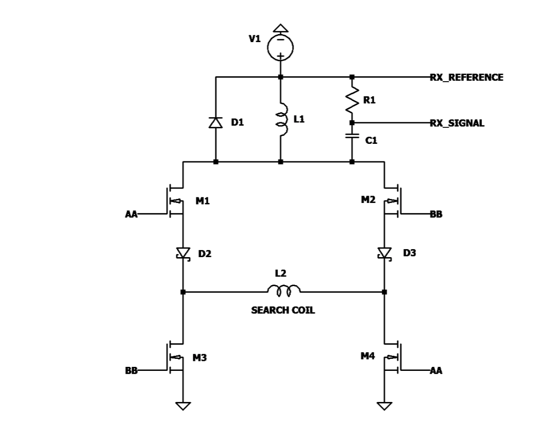

                              By the way, moodz, the signal in your bipolar CC design will behave just like this ZP setup. Because your design keeps the coil on a low impedance all the time, you're going to run into these same physics and trade-offs.
                              • Good analysis .. though the latest version of the CC transmitter patent has the TX coil grounded on one side and terminated by an impedance on the other side with each alternation of the bridge switches.
                                So yes the TX coil sees a low DC impedance during transmit times ( flat tops ) but a high AC impedance R during simultaneous recieve times ( flat tops ).
                                Thus we can send and recieve from the one coil even though the current in the coil is never zero. ( but it is effectively constant during flatops ). If L1 is very large the current does not want to "change" easily.
                                The V1 and L1 being effectively a constant current source ( which has a high output impedance for AC but not DC ) and D1 ( switch ) ensuring continuity of the constant current source during the brief flyback times.
                                The target responses occur across the R1 impedance.
                                In the minelab patent they drive the coil with a voltage source not a current source so the coil is grounded ( AC wise ) on both ends and there is no opportunity to extract a target signal.
