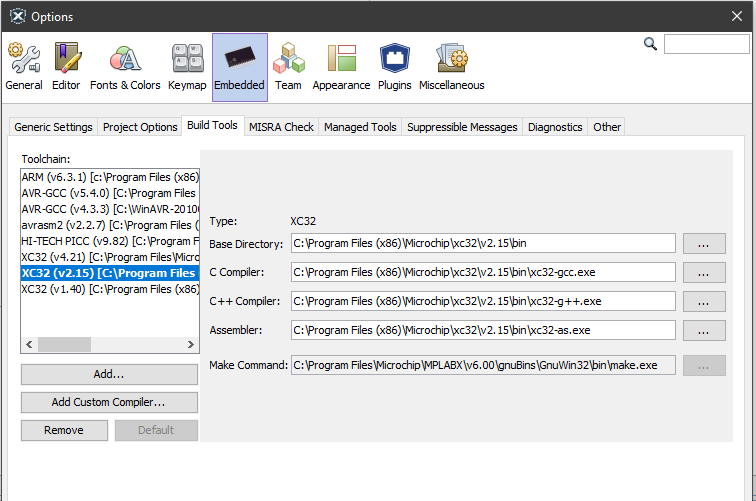

            Hi Moodz,
            Before I decide to throw in the towel and code it up from scratch could you check my configuration please.

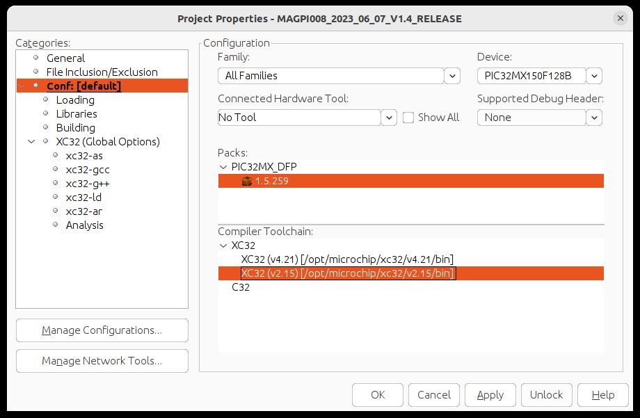

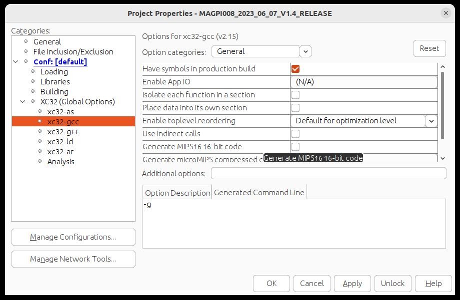

                Hey Dean ...
                Just to make sure on a clean machine ...
                I loaded up a clean Ubuntu 22.04 virtual machine hosted on Virtualbox .
                Installed MPLABX 6.10
                Installed XC32 v2.15
                Installed PLIB legacy on the compiler location.
                Downloaded the V1.3 I posted ... and it did not compile .
                So there is something wrong with that source package ... it only builds on my workstation ( regular machine ).
                I then downloaded the MX150 package from post #16 ....
                That builds OK.
                In summary ... something IS wrong with the V1.3 package. dont use it till I investigate it.
                moodz.

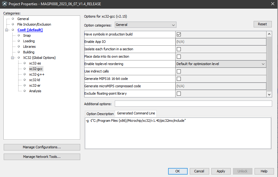

                    Hi Moodz,
                    I am still unable to compile fully and I think it is because I am missing some arguments in my compiler setup.
                    Here is a copy of my compiler output below and when you compare it to yours I can see that you have additional -g -x c -c
                    "C:\Program Files (x86)\Microchip\xc32\v2.15\bin\xc32-gcc.exe" -mprocessor=32MX150F128B -o dist/default/production/MAGPI008_2023_06_07_V1.4_RELEASE.X.production.elf
                    Would you know how to setup these arguements in the compiler..?
                    I have been playing around with the Compiler options fields and checking the Generated Command Line to see if I can get it to match but without any luck..?

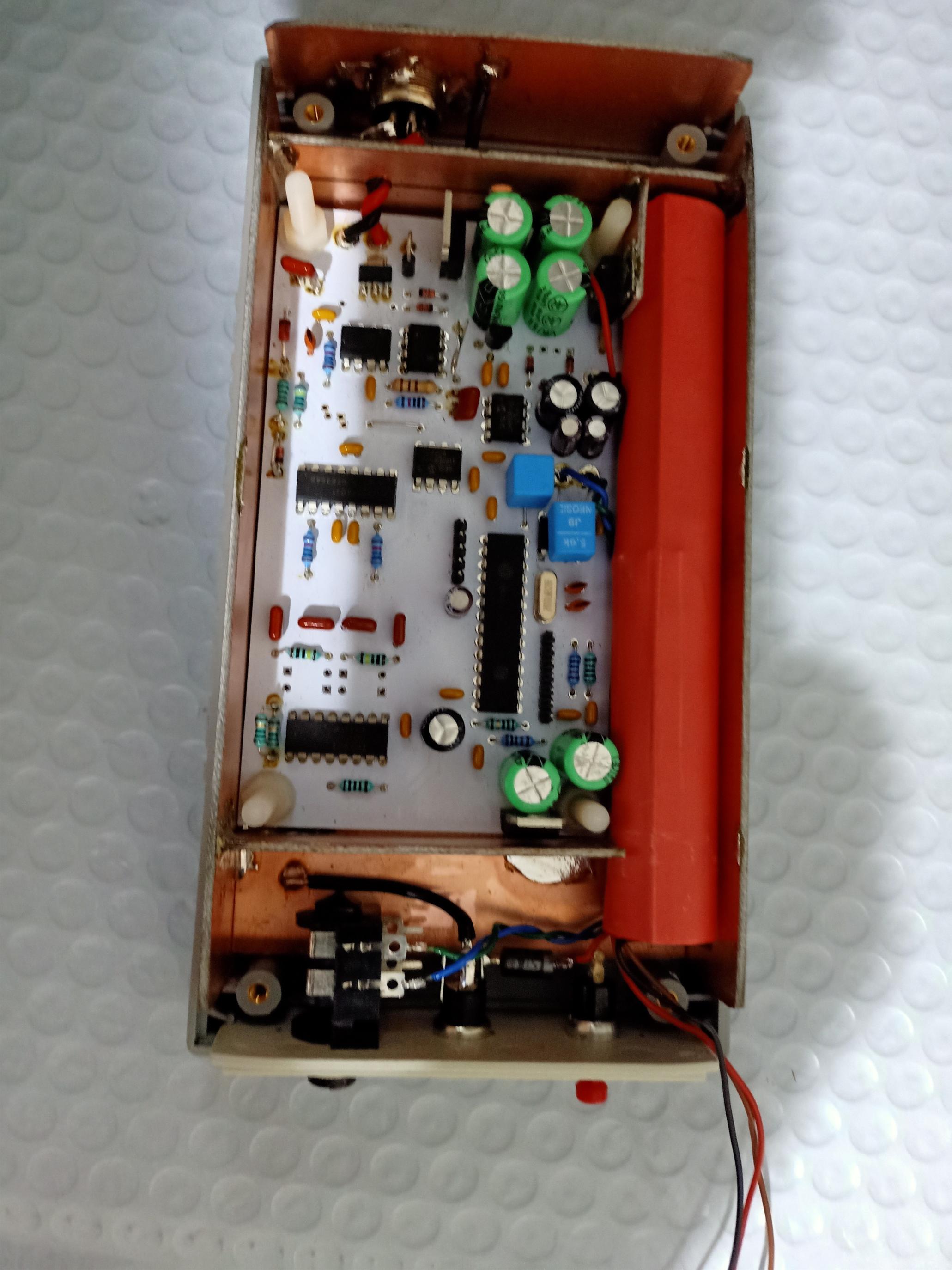

                      I have finished with the assembly of this project and carried out the first tests and it seems to work well, however I have a big doubt with the D3 diode (BYV79-200) since mouser sent me a TO220 assembly diode instead of the one I see in your photos that looks like a diode with DO41 packaging. What diode are you using in your project?
                      Dario​
                      • Originally posted by darov922 View Post
                        Dario​
                        Hey Dario ... good work ... try a MUR160 diode.
                          Click image for larger version  Name:	image.png Views:	0 Size:	47.9 KB ID:	412971​
                          Hi Dean ... I downloaded the source zipfile I posted earlier and it compiles fine on a new machine setup ( defaults - did not change any configs ).
                          the command line option is -g .... see below. ( default setting )
                          I notice that your generated command line for the compiler is referring to v1.4 XC32 .... you need version 2.15.
                          I install version 2.15 XC32 then install the legacy PLIB on that ( it should ask you to specify the location of the compiler during install )
                          Also note that Microchip refer to PLIB for later support libs ( like Harmony etc ) ... this is WRONG. You need the legacy PLIB installer. ( login to Microchip and access the PLIB in the legacy file area )
                          moodz
                          Click image for larger version  Name:	config.jpg Views:	0 Size:	89.1 KB ID:	412991

                              Hi the firmware is below ...
                              This is the real life working schematic of the MAGPI using ZP ( zero point active damping ) and SNR ( sampling noise reduction ) pulse induction detector project. I designed this to demonstrate the ZP active damping system and additionally the SNR noise reduction scheme in a pulse induction detector. In the base configuration

                                Hi Moodz,
                                Great news..after installing the legacy peripheral libraries into the V2.15 libraries path it succesfully compiled and downloaded to the PIC.
                                This verfies the fact that the display is not initialising properly as this was the same behaviour I was seeing from the hex file also.
                                Thanks again for all your help and will let you know when I have it working.
