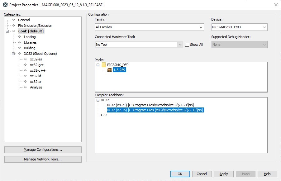

                  Hi Moodz,
                  Trying to compile V1.2 but it appears I am missing some system files <peripheral/bmx.h> <peripheral/adc10.h>
                  My make files directory is C:\Program Files\Microchip\xc32\v4.21\pic32mx\include\pic32m-libs
                  My MPLAB X IDE is V6.00
                  Below is screen shot of the default compilers.
                  Also it appears that my 20 x 4 character display is using Hitachi HD44780 controller so will likely need to re-write the driver.

                    Attached is v1.3 source.
                    The C compiler must be v2.15 to support PLIB functions.
                    You have to install PLIB after installing the compiler.
                    The IDE I use is version 6.05
                    Not sure why you have to rewrite the driver ... the library IS for the HD44780 controller and it works fine.
                    [ATTACH]n412787[/ATTACH]

                      Hi Moodz,
                      Thank you for your help.
                      I have installed the V2.15 toolchain onto my V6.00 IDE essentially it looks exactly as per your screen shot same Pack version etc.
                      There is only one file missing when I try to compile and that is bmx.h..?

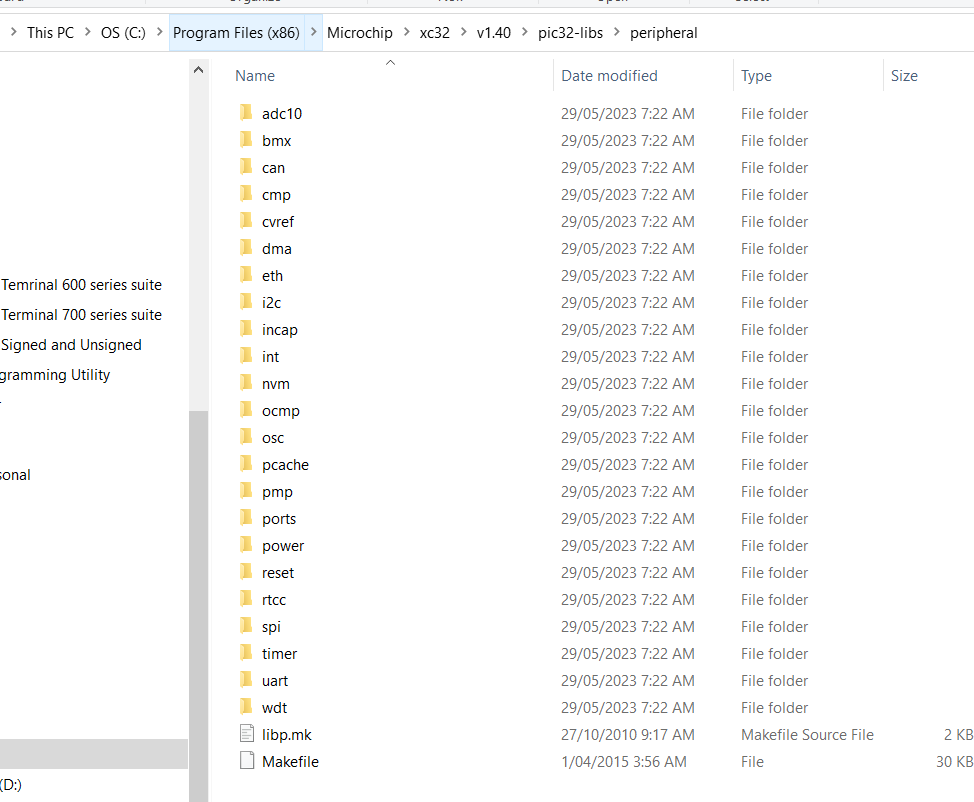

                          Hi Moodz,
                          I managed to install the peripherals library >>> C:\Program Files (x86)\Microchip\xc32\v1.40\pic32-libs\include\peripheral
                          Lots of warnings when compiling such as >>> #warning The PLIB functions and macros in this file will be removed from the MPLAB XC32 C/C++ Compiler in future releases
                          There are only the below 2 issues I need to figure out which I hope when sorted will be able to compile.

                            The V1.3 source project I posted last was set for a MX250 device .... your error message is saying you have it set to a MX150 device ??
                              Hi Moodz,
                              Thats because I am using an MX150.....?
                              • Originally posted by Dean Sarelius View Post
                                Hi Moodz,
                                ... OK looking at that log there is some error not visible ... should be listed higher up in the log.
