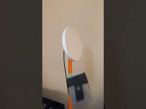

                  • There are various sources on the web that show that the detected target response from the transmit signal is proportional to a 6th power path loss.
                    If this is true then as the target approaches the coil the response should be very non linear. To test this we move a target to where the detector just barely detects the target then measure how much closer the target must be for maximum signal / overload.
                    So I took a coke can which just registers at around 50 cm off the side of the coil. With the MAGPI just moving the coke can in by 1 cm caused a full scale target deflection.
                    This demonstrates the target signal to noise ratio is highly non linear as the target approaches the coil.
                    Is it a 6th power ? Dunno .... But it must be quite significant to go from a sniff to a sneeze in just 1 cm.
                    Anyway heres the video
                    https://youtu.be/TsX0H9jwNN8?si=fAGdo4BgWHX5gKLd​
