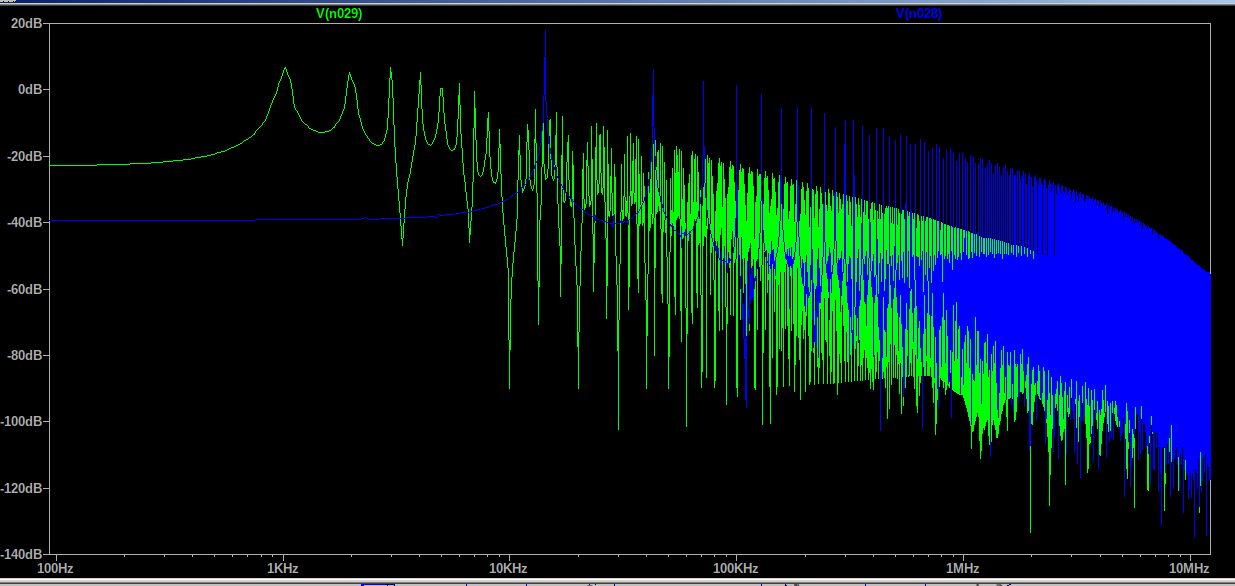

                    spectrum of 14 khz square wave vs 100u / 1000u tx
                    Click image for larger version  Name:	image.png Views:	0 Size:	26.4 KB ID:	422856
                    • Yeah once you get to 50% duty cycle it's the fundamental and only the odd harmonics by amplitude ratio 1/3 + 1/5 etc. Once again is there an optimum duty cycle where the power & harmonic distribution is evenly spread ?

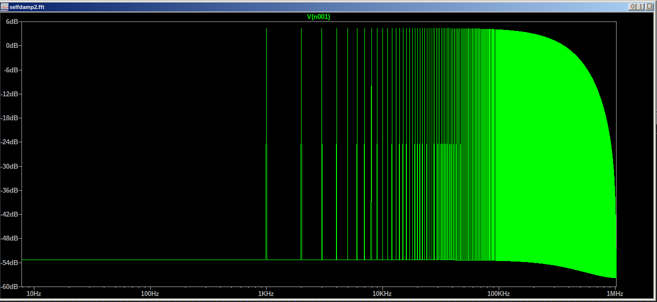

                      • Like this ?
                        • Yes that would seem to be the ideal. What are the conditions here ?
                          • Reduce F to 500Hz and the harmonic 'nit' comb gets finer
                            • Originally posted by Gunghouk View Post
                              Its just the mathematics of time domain pulses to frequency domain.
                              For instance here is a spectrum from DC to 1 GHz. (In the time domain its a single pulse of 1 million volts / amps that is 1 nanosecond wide )
                              The individual spectral peaks cant be seen as they occur every 1 nanohertz so they merge to form a continuous line.
                              However no matter how "exciting" these spectrums look for metal detecting there is no time domain in FFT and nuggets are not frequency selective or they would be used in radios
                              Click image for larger version  Name:	image.png Views:	0 Size:	25.8 KB ID:	422877
